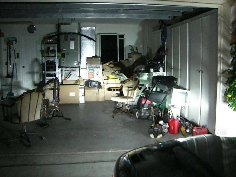

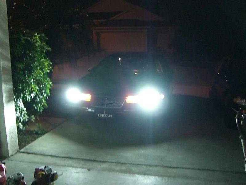

my hid kit is installed, re-aimed and i love it, they are very bright and i can see just fine now.

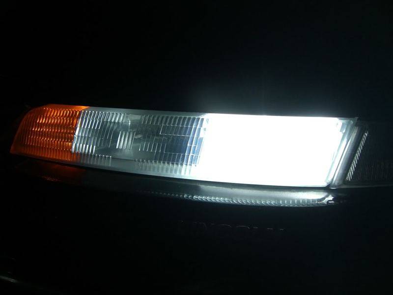

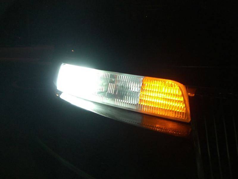

Look good Jamie! Will come down in a few days and check 'em out. I could take a pic of yours and mine parked side by side in the dark and post it here for a direct 4300K and 6000K comparison.

Hi Mack! That tape is pretty durable - should be ok with the extra heat of halogens although i can't speak from experience as i switched to HIDs in the low beam as soon as i did the refurb.
I say do them and when funds permit, get that cheap 89 dollar HID kit - takes 10 mins to fit and makes a HUGE difference to the light output.
