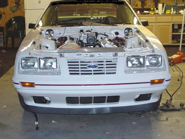

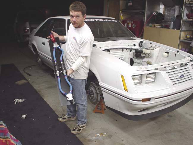

This car cost over $40k and an SVO Mustang to build (few have that kind of monies to drop on my services), and almost runined a 20+ year friendship.
This is a similar swap as what your talking about yet I did it back in 2003 when the boosted Cobra first came out, what a fantastic way of celebrating Mustang's 40th Anniversery.

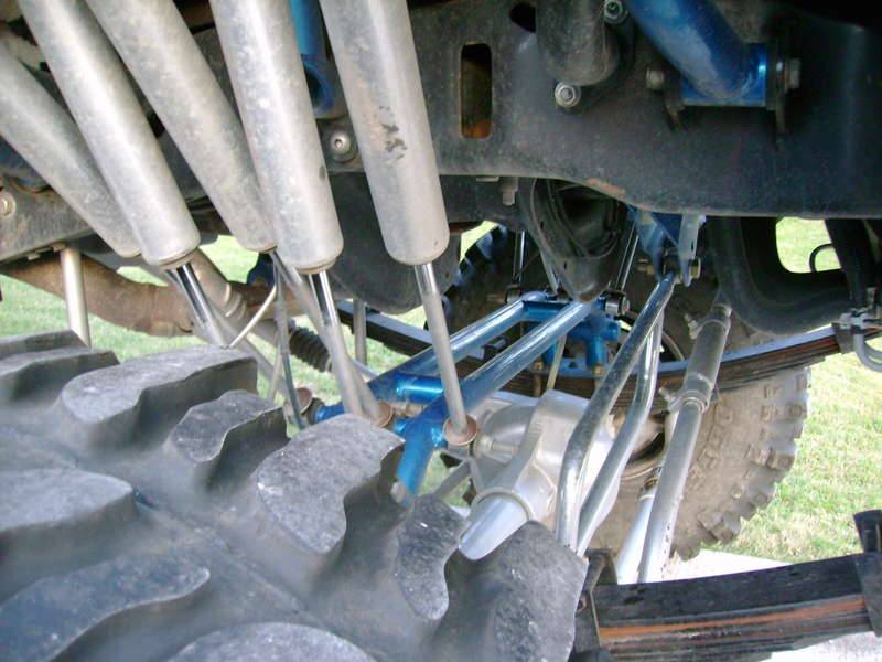

Past few years has been quite a bit of 4WD and Off Road stuff, really in just the past few years have the Marks, Mustangs, and Shelby's been really showing back up, guess thier tired of getting ripped off.

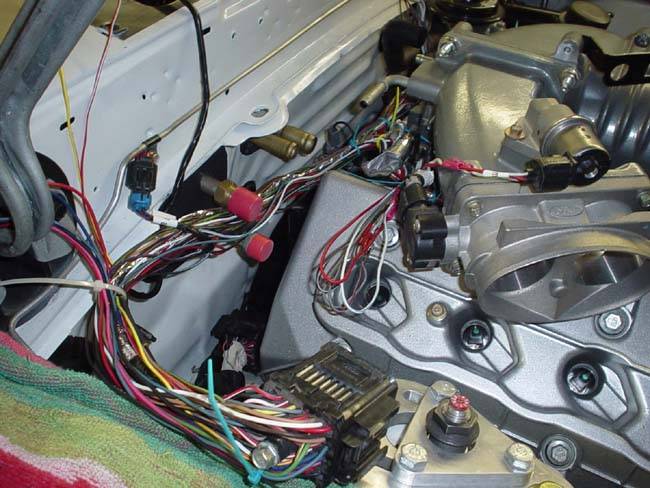

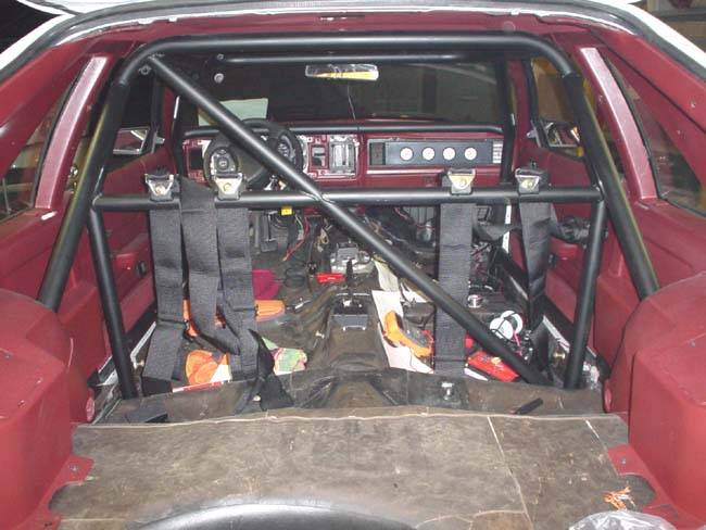

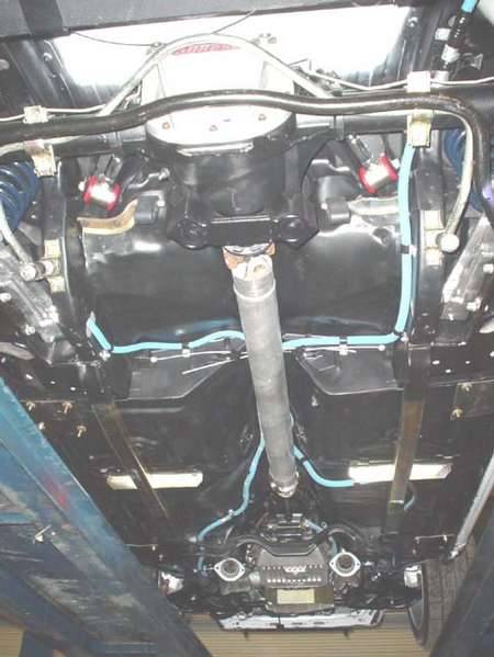

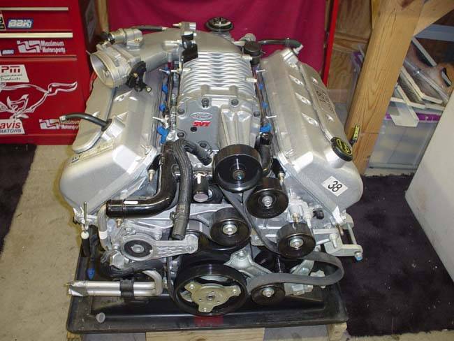

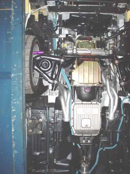

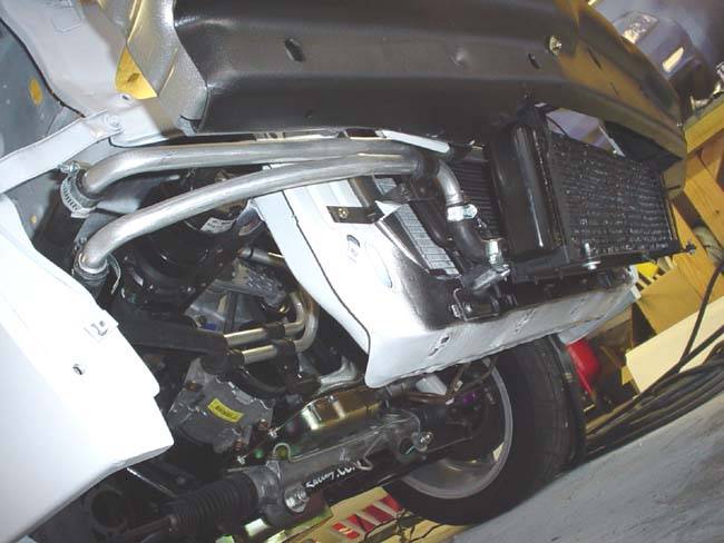

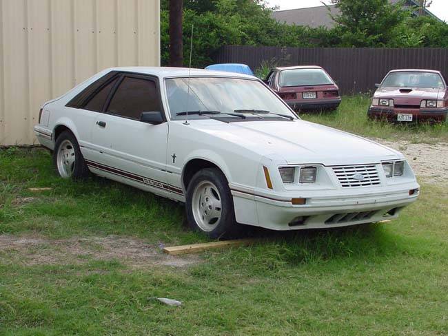

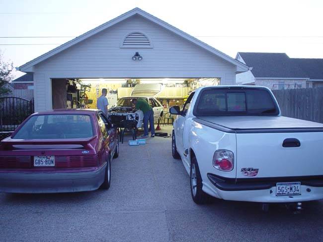

For you and some others here's a little bit of what your looking at mechanically to do something like this:
This is how it started 9 months ago.

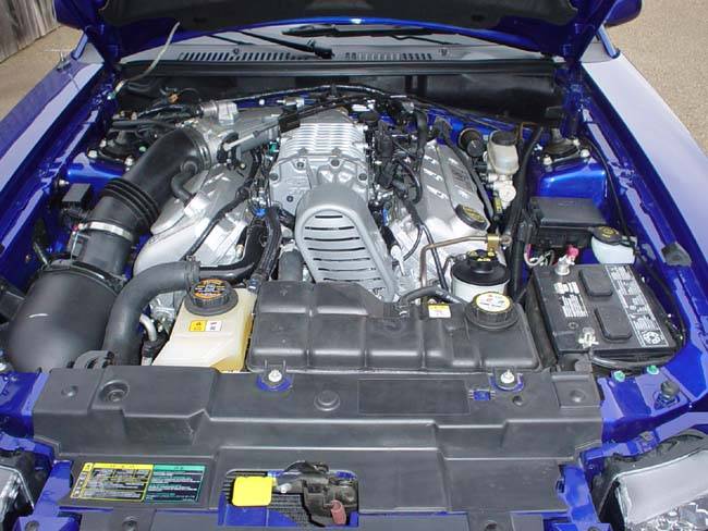

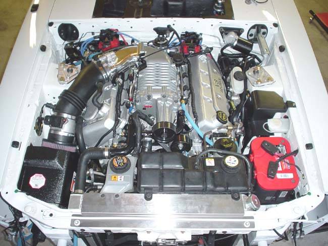

And here's a real 03' Cobra engine bay

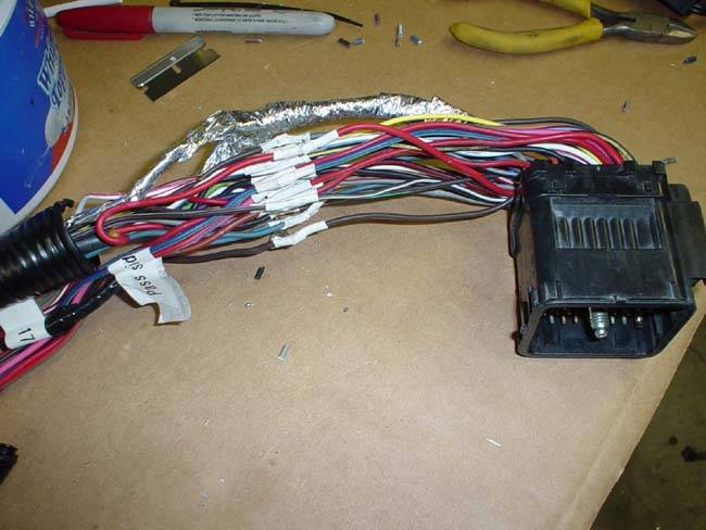

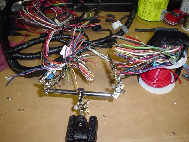

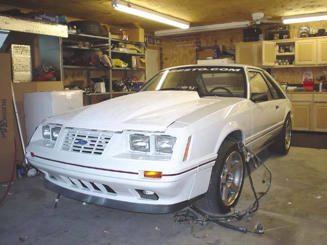

All wiring was re-hand made from a 96' GT harness.

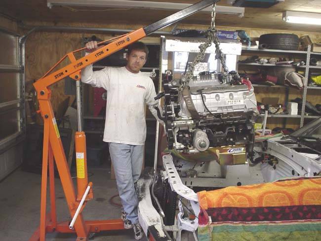

As you can tell from some of the other photo's this is not being built in some high zoot shop, this is your regular ole garage.
At least it has a fridge to keep the tasty beverages cold.

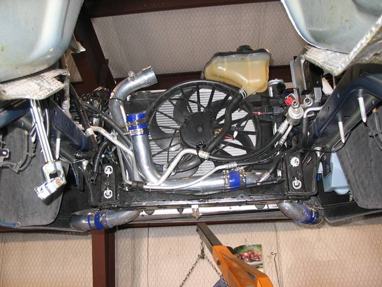

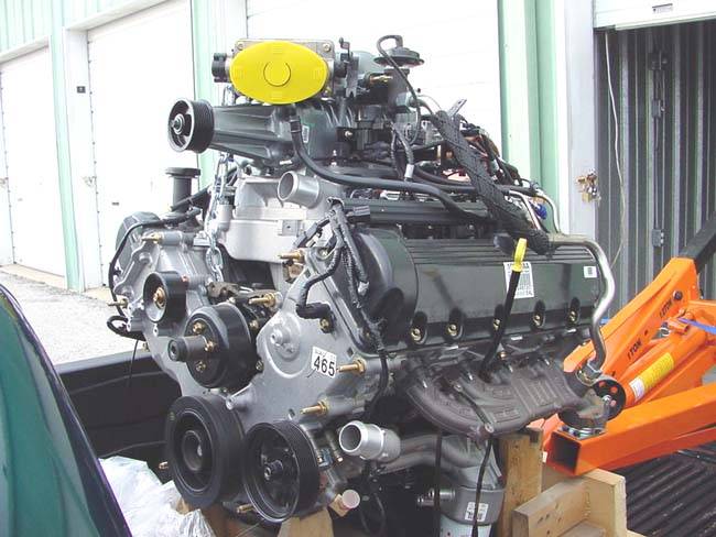

Another swap I was in the preliminary stages of doing:
So this whole Coyote swap is nothing new, and a few hurdles to get over it's just how much do you have to throw at it?

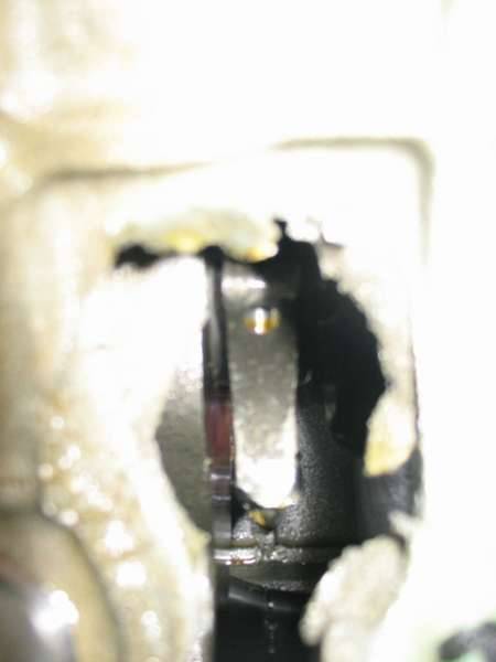

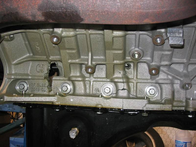

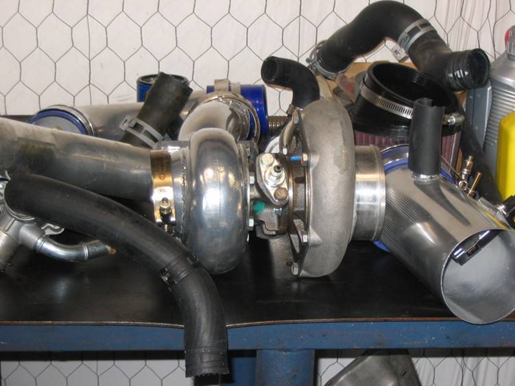

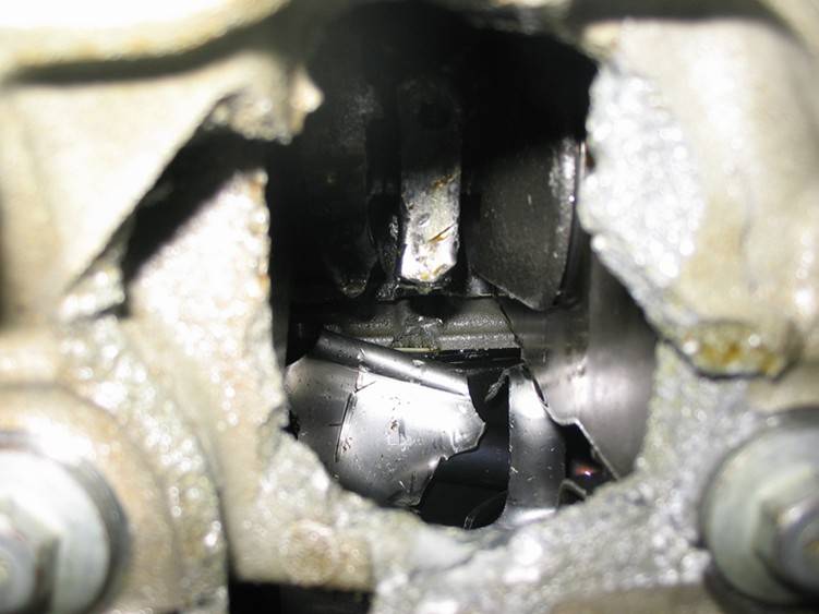

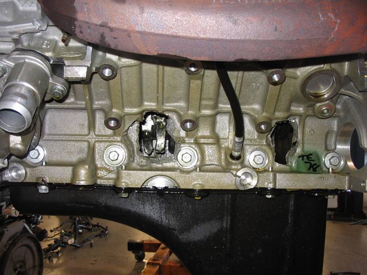

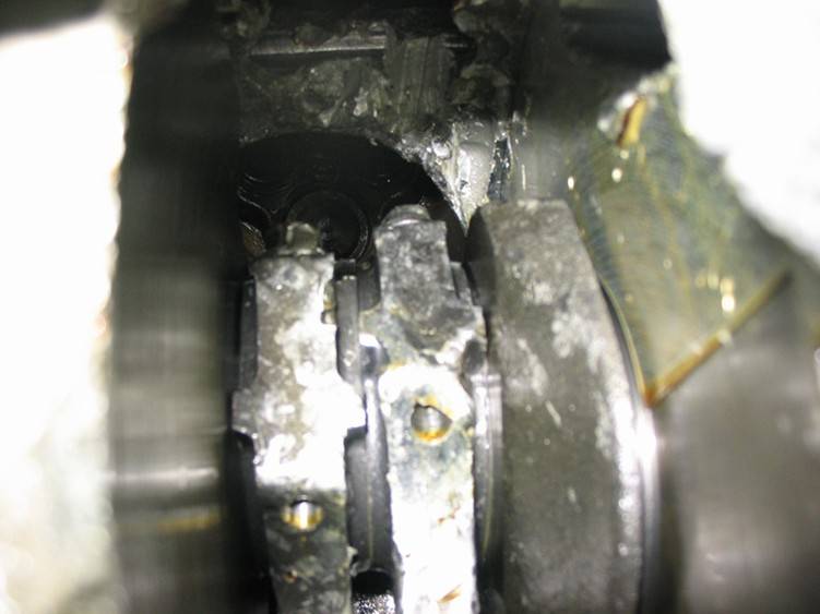

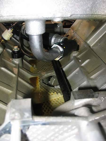

I'll let XLRVIII fill you all in on the fundimentals of block endurance, but let me show you what happens when you surpass these elements IE:
740 turbocharged horsepower on a stock 3 valve motor, this was a mess to clean up:
You need to look closely at what the new 5.0 is made out of, and that it's nearing it maximum limits as it is now, in the next few months your gonna see a lot of these motors scattered everywhere.

Soooo...
You gonna rebuild that?
Soooo...
That was done and gone a long time ago, two plus years ago, I photo archive EVERYTHING that I work on, it doesn't matter what it is.
My archives have proved to be a very valuable tool, and at this point I wouldn't change a thing about how I do that portion of my work.
