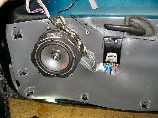

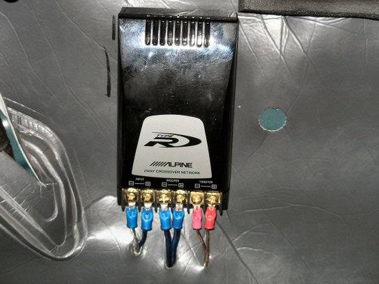

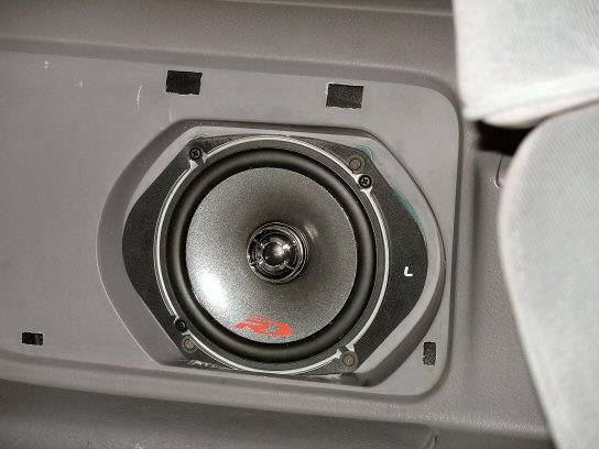

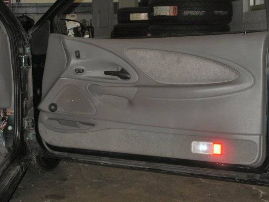

anyways, lately ive been busy updating the sys in midwestbird's "thundermark" he had some kenwood 5x7's in the front and some misc 5x7's in the rear with his 2 alpine type r 10's and a hifonics (sp?) amp, well now..........
6.5" in the rear
6.5" components in the front
and a 4ch hifonics amp

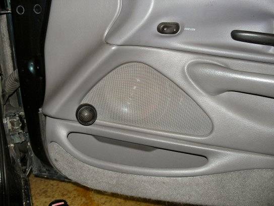

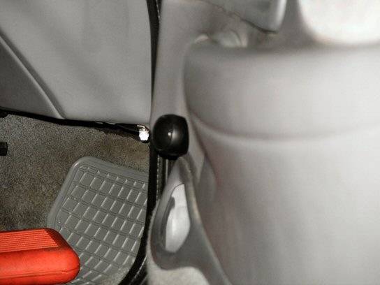

i just wish the bird had a better location for the tweeter, i like the "stock sys look"

there has to be another location to put that tweeter? like on one of the pillar's perhaps. it is not recommended to put tweeter that close to a speaker. but whatever do what you want. either way over all... that t-bird is looking really good.
Thanks, its getting there. I didnt want to do a lot of cutting into parts that are getting hardwer to get. We thought about the A pillar and on TCCOA there are a few people putting them in the map pocket location. Either way that was alot of cutting.

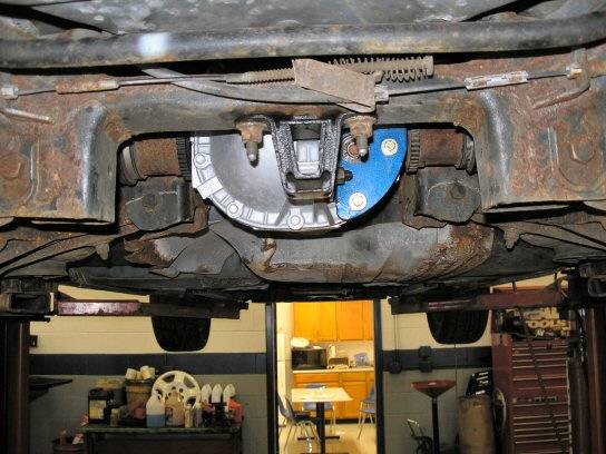

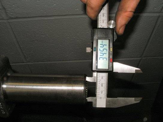

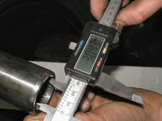

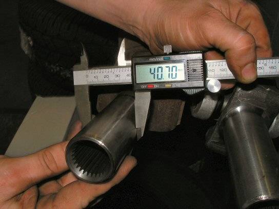

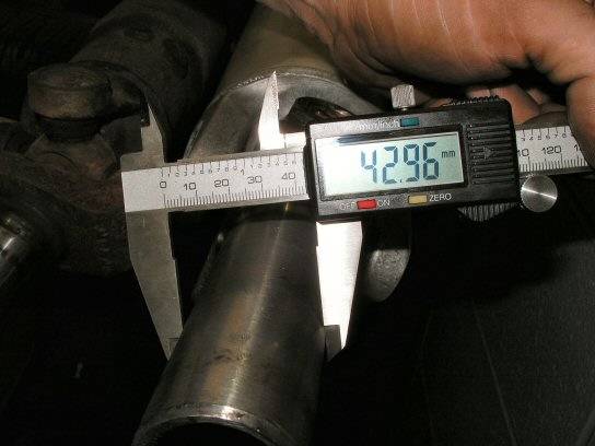

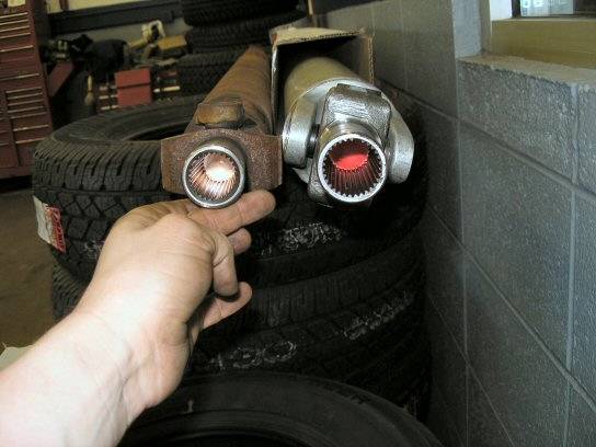

We started yet another phase that sucked. Aluminum diff with 4.10 tl, so I had a 4" aluminum driveshaft made and they put the wrong slip yoke on the shaft!!! We were all ready to finish it last night until we couldnt get the yoke into the tailshaft. According to a bathroom scale the loaded al diff only weighs 11lbs less than the iron one:(

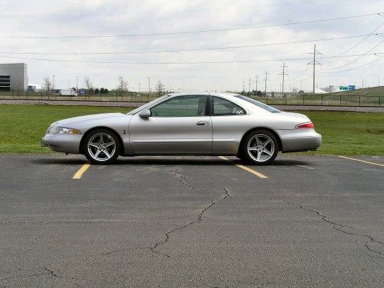

well the entire thing didnt suck, the exhaust did, due to exhaust shop installed the exhaust, then put in the hangers into the mounts then welded them to the pipe. which resulted in a un-removable exhaust, dont worry a cutoff wheel did the trick. overall it took about an hour to drop the exhaust, and 30 min to pull the diff (using geno's method VERY EASY) and yes the stupid driveshaft place (this is all they do) looked at the stock shaft and even knew it was for a bird still put the wrong slip yolk on it!!! on the plus side, while the bird was down i borrowed its rims mmmmmmmmm purdy
pic 1 comparison of the sizes
pic 2 old ds inside dimension
pic 3 old ds outside dimension
pic 4 new ds inside dimension
pic 5 new ds outside
pic 6-9 damn now i want a set of these, anybody giving any away (free?)

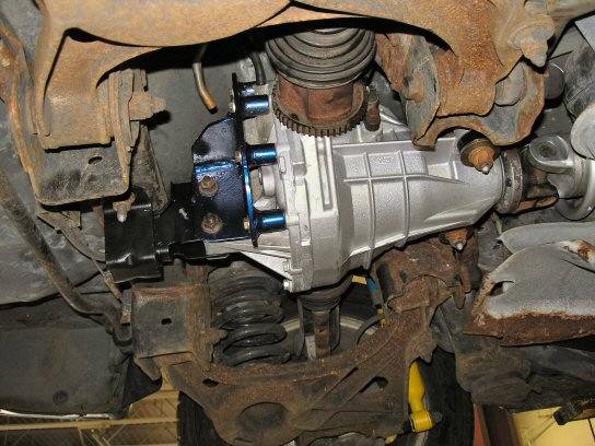

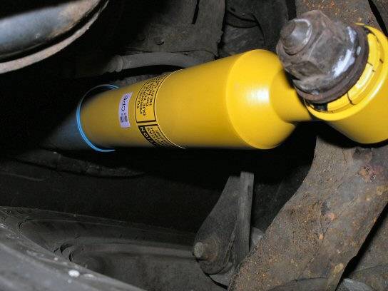

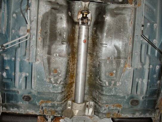

whoooo hooooo 4:10's in a aluminum markviii housing are in!! since midwestHACKshaft thought a 95 bird had a c6 in it (duh?) special thanks to a TCCoA member for the driveshaft, and the overnight shipping. just got a few pics, went in easy so wasn't much time for pics, plus didnt want friction modifier and gear lube on my camera, and didnt think about but all the pics were without the exhaust up. also threw on blistein (sp?) rear shocks on fri, when we ran into "the drive shaft issue" but all good now, just ripping around town all we could tell was there were defiantly traction issues lol

my gawd! i just hope for your sake that the under carriage does not fall apart. there is so much rust under there. :\
