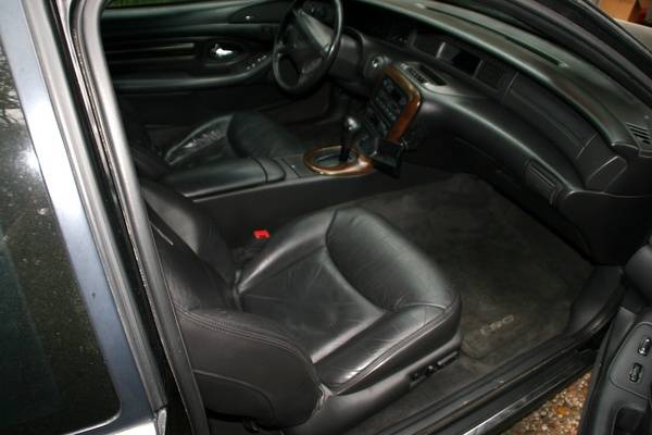

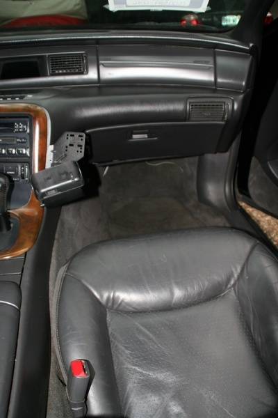

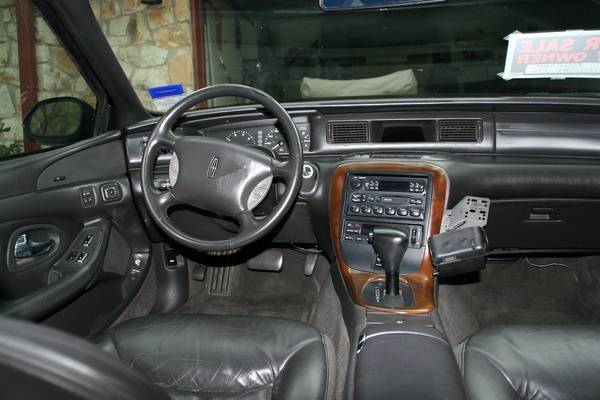

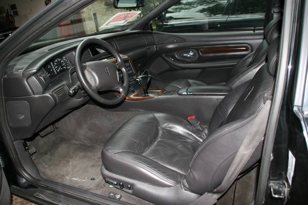

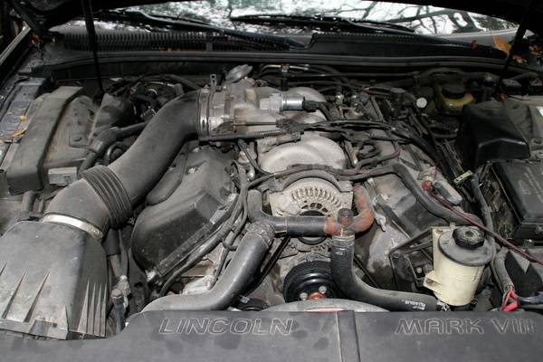

Interior and engine (engine will be washed soon!)
That black thing on the right is an XM radio cradle, and above it is where the cell phone used to be. All of that is coming out for a 7" gps dvd nav unit!
Car had a complete system in it before including an AVIC 7" gps but it was all removed with the exception of some random wiring (as seen in the photos), a Memphis 12" sub in the trunk and a Rockford Phosgate amp, also in the trunk. At least he kept the OEM unit!

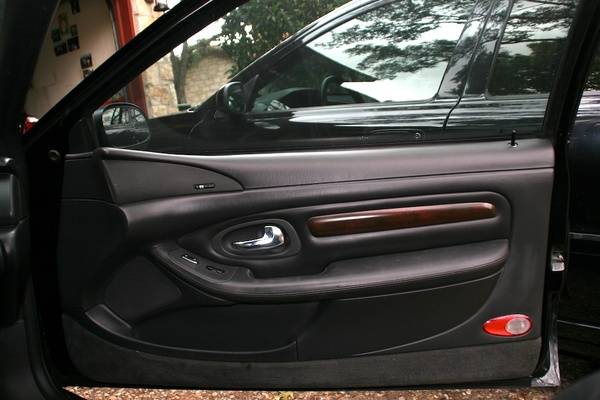

Driver's seat is wrinkled but no rips or tears.
Interior still smells like leather, like a Mark VIII should!
I've already replaced the missing trim on the power window switches. If only everything were so easy!
Anybody have a spare engine trim plastic piece that as you can see is missing?

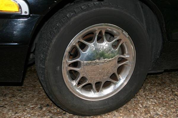

I have done allot since you rode in it. Tokico shocks/struts, SCP braces, Adco sway bar and some 18" Saleens. :D Got gears and a Trak Loc waiting to go in too. :wrench

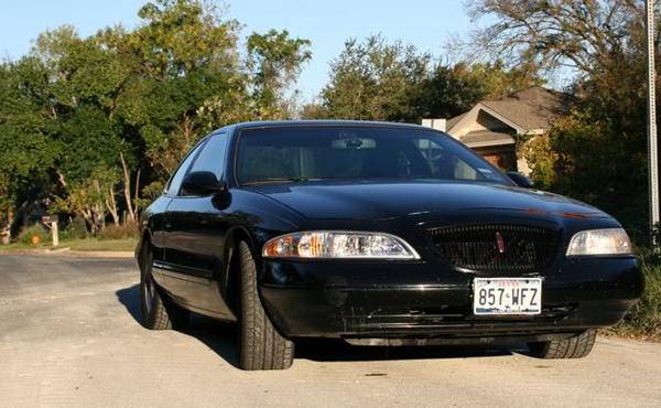

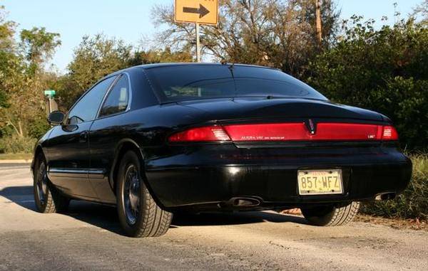

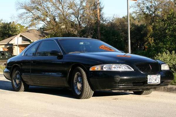

What height coil conversion does this look like? I was told by the owner it lowered 1 1/2". Does that seem right from the way it sits? :confused:
Looks about right. In my sig picture that is coils at the stock height and yours looks to be just over an inch lower.
The alternator cover was not included on the 98's, only 97's. They can usually be found for about $50. Kinda expensive for a piece of plastic, but I think they look good. If you do find one, make sure it comes with the 'stud-bolts' to install it.
Looks good with the Octastars!
