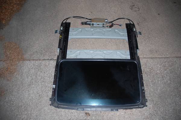

Well I found the entire moonroof assembly (glass, tracks, motor) for $50 at a U-Pull-it. I'm gonna head out there in the am to do the removal. I'm kinda glad its a U-pull-it deal cuz it should give me a little practice before I tear into mine.

Pulled this out of a '97 Tbird today. I pulled two roof's before this one from '97 Mark VIII's, but they both had damage. I didn't think I'd find a good one until I stumbled upon this Tbird. The roofs are different from Gen I to Gen II. You must use the roof from your generation's Mark or Tbird.
It was great practice for doing my car, and not bad at all for $50.
I'll install it tomorrow if if checks out.

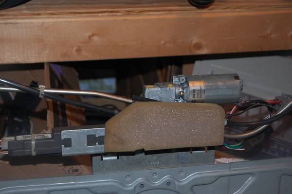

NOTICE HOW CLEAN THE MOTOR IS...

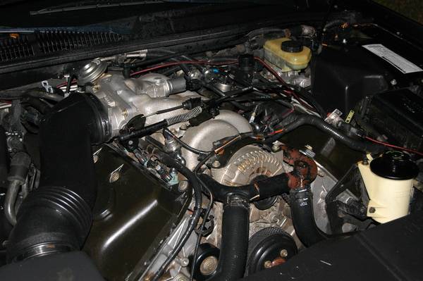

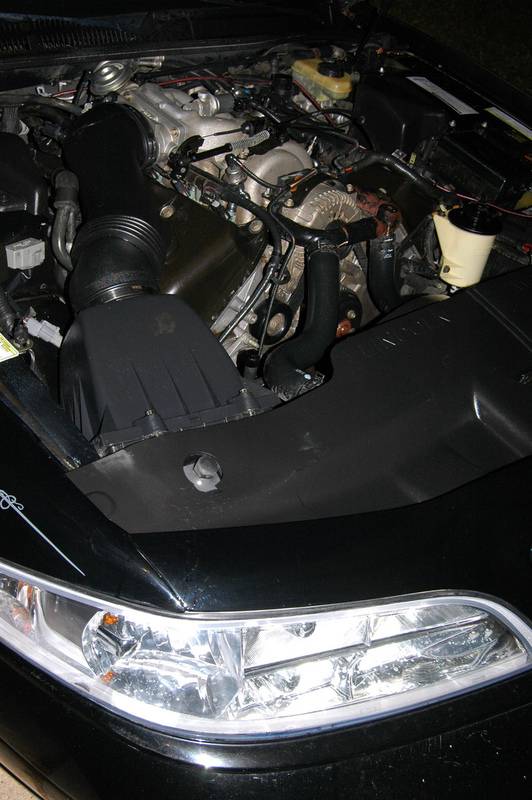

Engine cleaned up nice:

Just piant that crossover tube and you will be set.

I cleaned the engine at the self serve car wash. I started with tire//wheel cleaner (the green stuff) all over the engine compartment to degrease it, then followed up with a full scrub down with the foaming brush to get off any dirt, then high pressure rinse (carefully applied), and clearcoat sealer for a little shine after.
I have done this on multiple cars. Just make sure to have the ignition electronics covered and you are good to go.
:eek::eek::eek::eek::eek::eek::eek::eek: wow - Ive never tried it and heard so many horror stories...I'd still be afraid to do it - but sure does look nice Hottie!

Biggest worry I have had, is when it is a high mileage car and hasn't had the engined cleaned in a long time. Gets to the point where the grease is holding it together. :lol:
sure beets the countless hours I've spent with q-tips, various brushes and cleaners...but I'd just kick myself if I did it and then he wouldn't start!!!!

Regarding spraying engines it's cost me at least two coil packs on other cars, but I figure they were either weak or I'd be replacing them soon anyhow. Overall I've done hundreds of engines. I used to work for a Cadillac dealer when I was a kid and I'd make e'm shine like new with a steam cleaner. They always look so much better after you're finished anyhow :cool:
