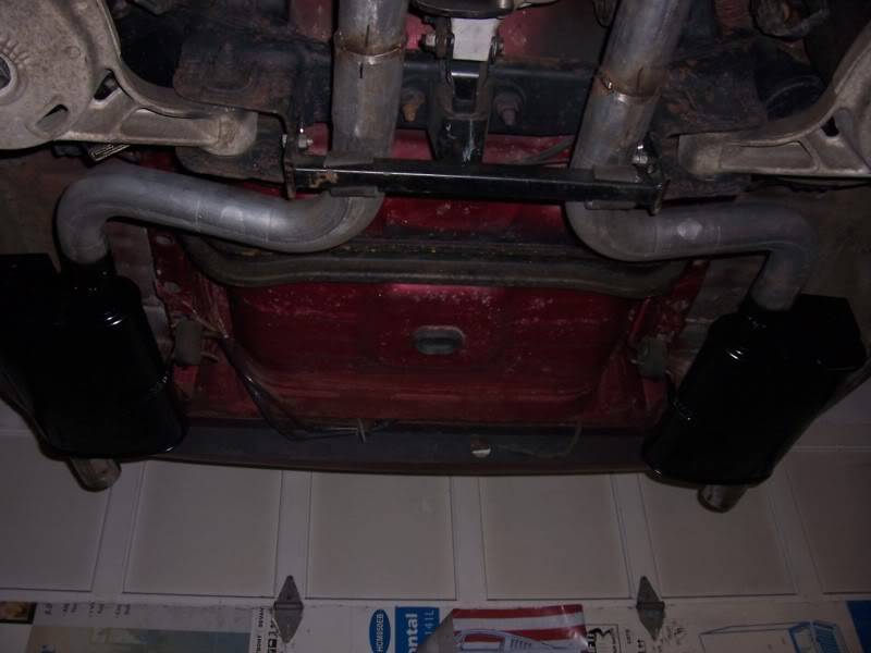

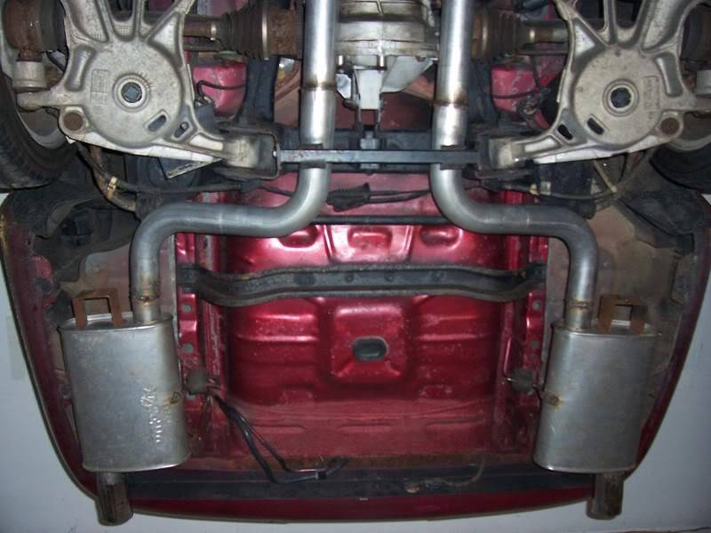

Little update. I really wanted to be driving the car but my new muffs and ball and sockets won't be in for a week. I have these 2.25 inch aluminized steel cheapy Dynomax turbo muffs that where month old and to dronny for dude so he gave them to me free. I just welded them right on and tacked on tips so no more fumes in car.
I blacked out the muffs but camera would not take nice pic of them for some reason.
Grade: I give these muffs 2 THUMBS DOWN. Way quiet barely hear the nice engine growl. It is nice and super quiet in cabin but I can feel HP lose.

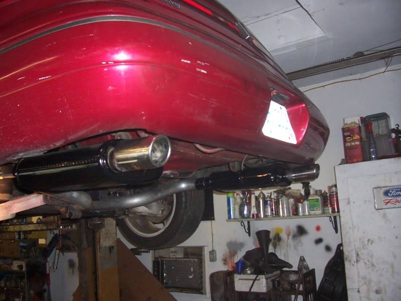

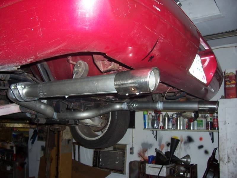

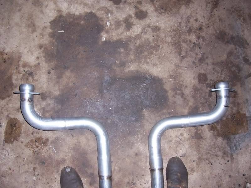

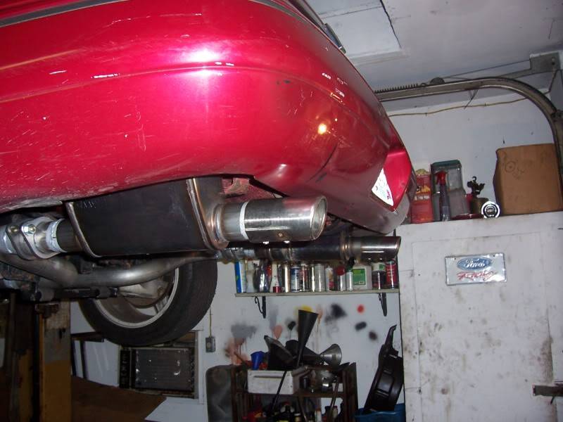

Got to finally wrap up the complete exhaust job. This stuff came in couple days ago from Mandrel Exh. Those guys are great and cheap! Got 2 sets of ball and sockets and the 24 inch rear muff delete pipes with sockets on end and some more hangers all for $50 to my door.
Had to trim length of tail pipes and balls. There now tacked on ready for burn on.
Here are the muffs with sockets and stubs tacked on. Then shot of street muff exh and track rear muff detete tails.

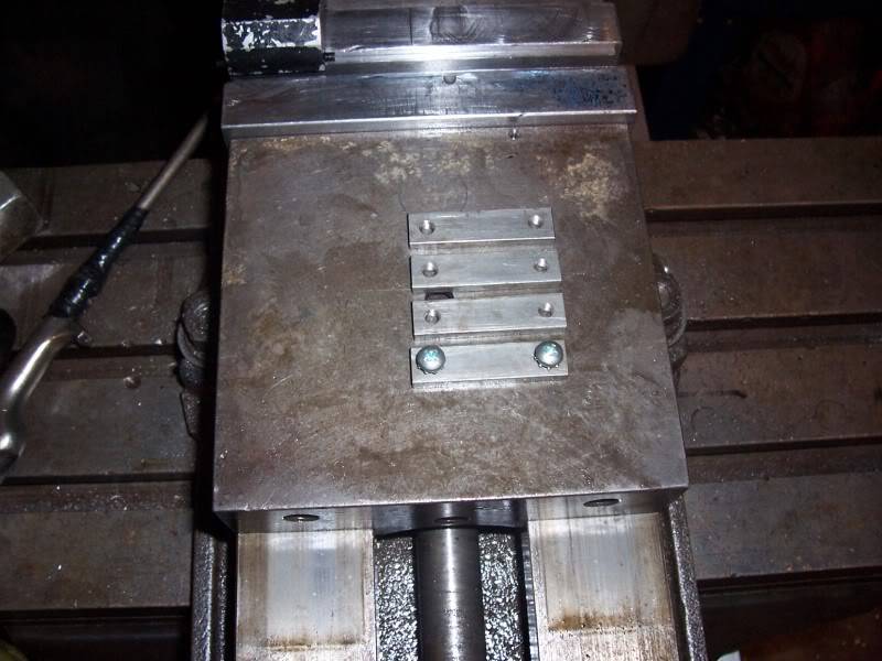

I wanted to be cheap and make the tips modular so made these .187 thick nut plates. Tapped 10-32
Also the tips drilled and added the 3/8 hole so I can shoot mig thru hole to tack the nut plates to tails.

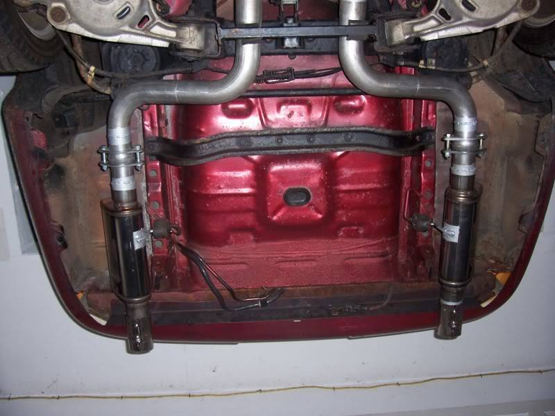

Heres both shots street then race.
I was getting DRONE and fumes in car on way to track with no tails thats why I made up the track pipes. Car sounds sweet now with street exh on. I can drive by cops no worries but if wacked it opens up.
