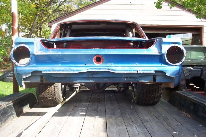

I got a 64 falcon that needs a testskid motor....you busy? :D

Guy not far from me has a 64' Falcon with a 427 Cammer in it :cool:

Well the Falcon with the Cammer is also a Straight Axle AFX deal from way back when. He also has 2 other brand new Cammer engines so that makes 3 Cammers he has. Says it's his retirement investment or something :rolleyes:
He also has another Falcon with a set of FE headers but no engine. It's also a stick car and he was trying to sell it to me for $1500 but that was like a decade or so ago. I didn't feel like dealing with a FE engine again :shifty:
