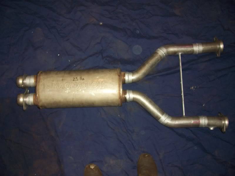

I weighed all pieces of the stock single 93 exh and came up with these #'s
Drivers manifold 16lbs,pass manifold 6,front Y with 3rd cat and res 37, and complete rear section with both muffs 43 for total of 102 lbs. I was hoping to drop some poundage with new exh, but not looking to good.
The BBK headers weigh 16 each and the Y with mid muff weighs in at 25 so 57lbs so far forgot to weigh long S tubes. I will have other stuff weighed for a grand total soon.

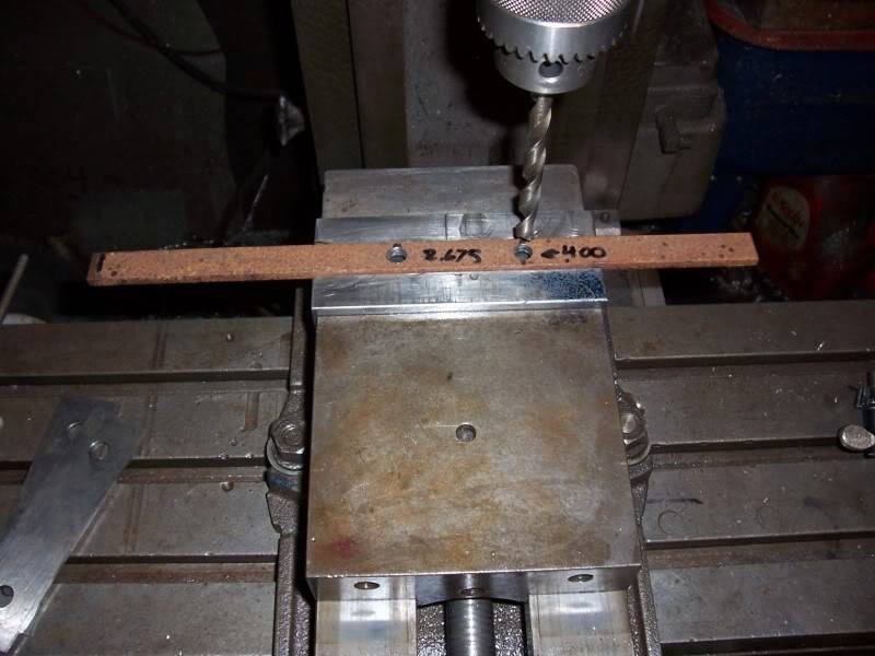

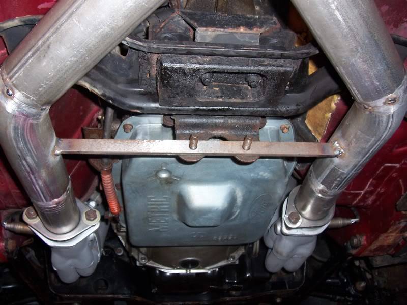

Started off by making the front rubber mount bar. Only wanted to make out of one piece of stock that why rec piece. Here you can see the hole spacing and dia to drill. And pic of it welded in place.

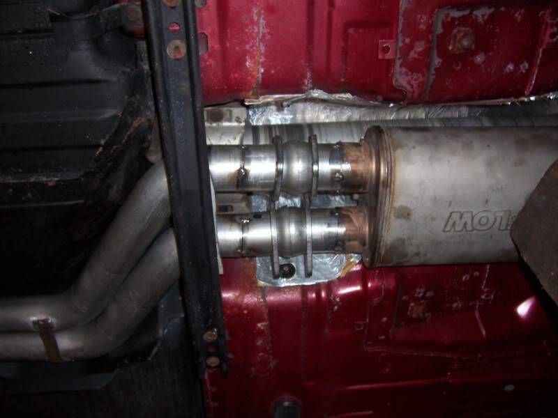

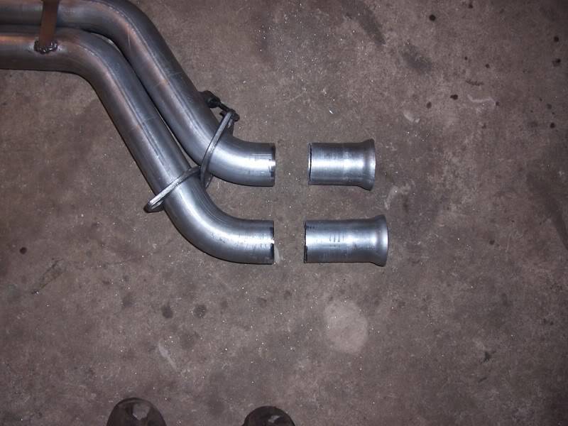

Next up was cutting off the stock long S pipe sockets to shorten them and weld back on.
Here you can see gap that needs to be filled by ball and sockets.
Here are all ball and sockets shortened and tacked into place.
Here is front muff pipe all welded up and painted the welds.

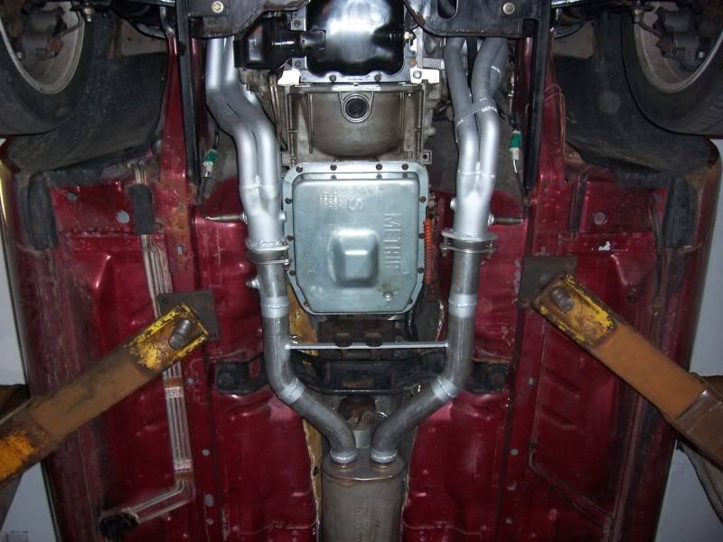

Here are all under shots.
All the B&S sealed up 100% and it sounds great. I'm out of thread room bye.:)
just to answer raped ape's question, no way in hell!!!!! if the trans ever has to be pulled out, that motor will have to be dropped out the bottom now, i could barely get my trans out with kooks headers, those long tubes forget it no way not without serious damage will that trans come out, but it sure does look cool!!! nice work so far man!
Depending on what engine, Big Block or Small Block I used to have to at least loosen the headers to take a trans out. I could def see that being a problem with how tight everything is in the Mark :confused:
the problem is, you arent gonna loosen any header on a mark VIII with the motor in the car, you cant get to the bolts!!!

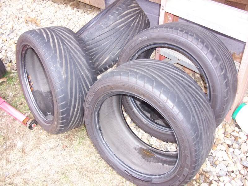

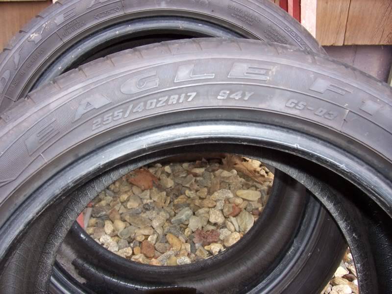

One of my 10 year old goodyear eagle ZR's finally let go so I had to throw the DR's on it to drive around. Just couple days ago picked up this set of 4 Eagle F1 255/40-17. Talked him down from 200 to 80 bucks! They have around7/32, 8/32 of tread.
I wanted to make crazy smoke show vids with the old Eagles. I found a :q:q:q:qter tire to throw on to make the vid thou.
