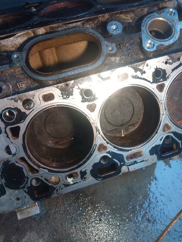

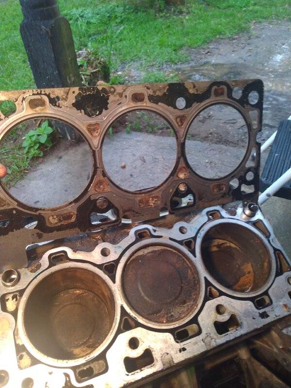

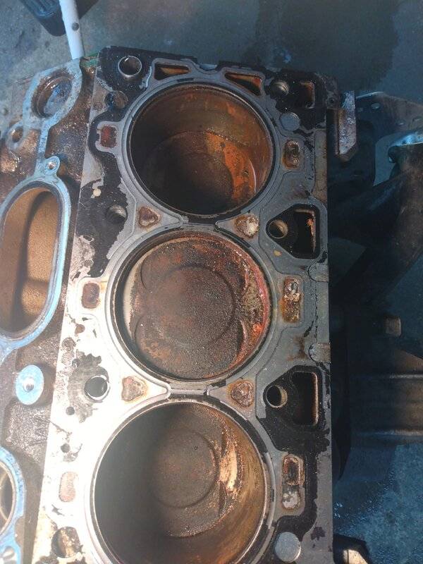

I couldn't let it go what you are seeing is the wounded motor I bought from the salvage yard two months ago. To recap I paid 265 dollars for this motor and it's been burning coolant and leaking coolant into my crank case. I know how to take thing apart and put them back together but diagnoses aren't my strong suit. Can anyone see where the head gasket failure point is?
On the plus side I don't see any cracks in the aluminum. I am going to attempt a rebuild. I was going to get another motor from the junkyard but another one I found here locally wants 450 for an LS v6 with 180,000 miles on it. Their direct competition that I bought an engine from in the past want 700 dollars for an LS v6 and I want to say he said that motor had 150,000 miles so I think I will leave the salvage yards alone and work with the problem I have already purchased.
