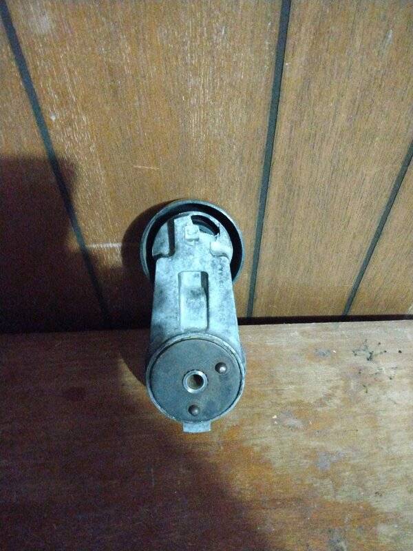

I took off the belt and started it. I was so happy it wasn't stuttering and skipping I left it alone after I took it off. Saw the tensioner bouncing when the belt was on with it running so I am gonna start with that and work my way to the damper.
I am just gonna start back over with no assumptions I feel like it could be even the idler pulley that was already on the salvage motor it might have been sitting around for a long while I will test all the pulleys.
The belt tensioner is fairly easy to mis-align. IIRC it "indexes" into a spot the timing cover.
It is also possible for the threads to strip out on the the timing cover where the tensioner bolts up.
A couple people on here have done that over the years.
Still start by removing the belt... and see if the damper is wobbling.
The only thing that looks out of order is this tentioner I am going to the auto parts store to replace it and swap my belt for a new one since this problem is wearing the sides of it prematurely. I don't know why it is misaligned but somewhere it is
It's to hard to see with the naked eye what is going wrong I'm just going to replace the two parts I can't really tell but I broke that tentioner trying to force the belt on so I feel it's a good place to start
