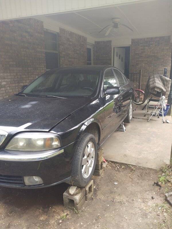

When I replaced this engine I did it from the top I caught hell lining up the motor mounts and I caught hell lining up the transmission. The belt I took off off my motor was somehow to small for this one. The salvage motor ran as smooth as a sowing machine until I put the serpentine belt on now it's running ruff and I just inspected the belt it's chewing the edges up prematurely so something is out of whack and it will take me a week or so to figure out what it is I have a mechanic coming out in wensday to check my work until then I'm leaving on the jack stands! Something just don't feel right I rather be safe than sorry
Maybe FOMCO changed more than the throttle body mid year. I have a bind somewhere but it all looks fine to the untrained eye but I can tell the transmission subframe is not in the same place it was with the other motor the bolts are not in the very center of the square of the mount that's the only visual clue I have that something it off.
I have pulled the transmission twice to reposition it. I don't see a reason to do it again unless I get a new transmission. It had shifting issues and the fluid was burnt when I drained it so yes you guys are totally right this car got no TLC.

There are paint marks on the flywheel and the torque converter. I missed a step here I believe I was supposed to have them in the same position but I thought that might be a v8 only thing so I just winged it.
But I can't say it's the motor because it continues to start right up I believe my abused transmission is the culprit
I may take the belt back off tomorrow to see if that smooths it out as that seems to be when the nightmare started.i had to order a belt that was longer than the two part numbers they sell for this year and clearly that still didn't solve what the serpentine problem might be.
If I turn on the air conditioner the stuttering get worse maybe it's a front cover difference but it all looked identical
