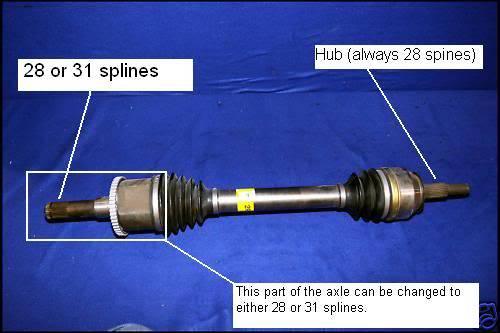

That definitely helped. I always wondered what was what in a diff. Thanks for that. It helps to now know what I'm looking at. I'm one of those people that works better visually than through text.
Yar, I dont know all what goes into it, but I knew they could be changed - right?

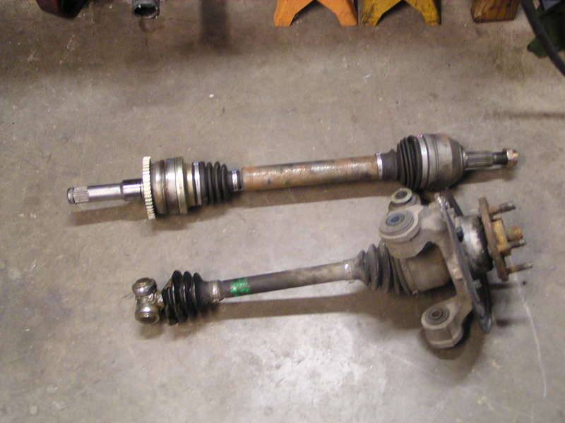

I have a LOW mileage complete termi pumpkin sitting in the garage, but can't seem to find a set of cobra CVs cheap enough to make it worth it. I also have a 28 spline trak-lok diff I am thinking about swapping in to the cobra pumpkin. At 5000 miles I think the gears can be reset fairly easily, bearings should be good to go as well.
