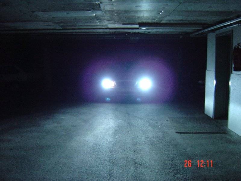

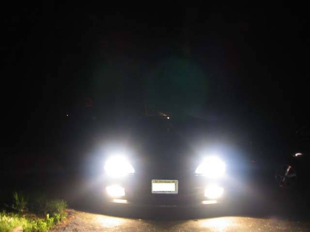

Yeah, thats why I had to change my order I wanted to go with the light that emitted the whitest light and I thought it was the 4300k but, it was the 6000k that emitted the whitest light. If your looking for the blueish tint hid I beleive its the 8000k that you are looking for. But, the 6000k has more of a white light.
6000k
8000k
That is insanely annoying^^^. I hope people remember to adjust them after installation before they blind other drivers.
