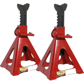

    BE SAFE! Make sure the car is securely supported on approved jack stands before you get under the car. Do not get under a car only supported by hydraulic jacks. The procedure is to raise the car with the hydraulic jacks, and then place the jack stands under the lift points. Then lower the car onto the jacks slowly until completely supported by the stands.
