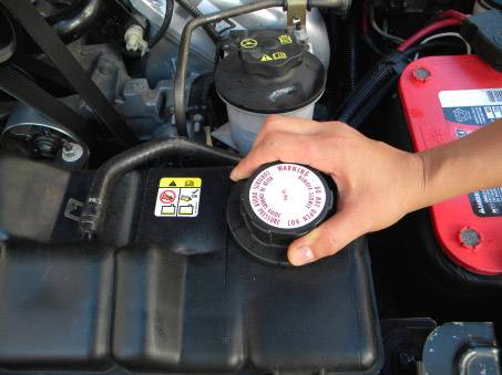

1) Car must be parked level or on a slight incline with the front higher is even better.
2) Remove the radiator reservoir cap and crossover plug.

(The crossover plug is normally removed with a ¼” socket drive but is frequently found to be seized. You can damage your ratchet if you apply too much force to remove it. It may be necessary to use a pair of vice grips around the edge of the plug and, in extreme cases, heat it with a torch. I recommend the use of anti-seize or grease on the crossover plug threads upon re-installation. It is never necessary to tighten the crossover plug much, just snug it, there is an O-ring to seal the system.)
