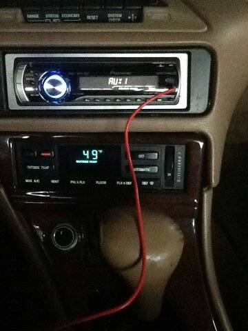

Wish I had that HVAC unit, my buttons are all busted up. Oh well, I'll find one some day. :)
Spree..replace it with any eatc from 95-98..they all work and have hard buttons that won't get all screwed up. Not too hard to find.

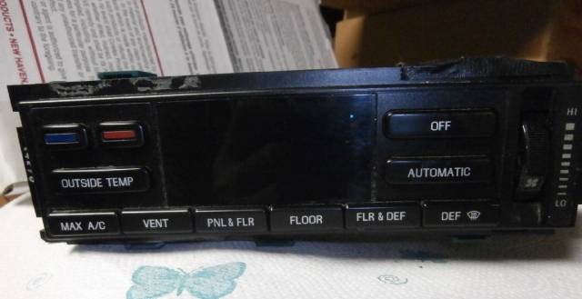

Very good, lets see some better pics of that thing washed/cleaned up.
here ya go Dan,
pm me your address, I'll send it to ya;
hook it up, test it, if/when it works pay whatever you want- I don't have much in it; no reason to think it doesn't work
I thought the only hard button that was compatible with a 94 was a 95? I thought the 96 -98 only worked half a$$. I thought I remember Sapper saying something about things not working right.
I believe that's true. I went through over a dozen of them from various Marks and other cars to figure them out and never once got a 97-98 to work in my black 94 and finally bought one from a 95 with the blue backing and it worked perfectly. Seems like Duck bought that one from me after the car burned.

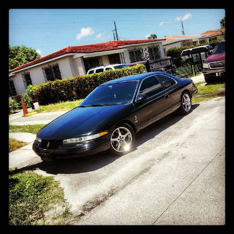

how does a matte black mark viii sound with american racing style 5 spoke rims and white letter bridgestones
Any unit from a 93-96 Mark VIII will work on any 93-96 Mark VIII. 97-98's only work on 97 and 98.
95 is identical in appearance to the 93 and 94, just has hard buttons. 96 is identical in appearance to 97-98, but only work on 93-96. They may "work" on other years, but not 100% correctly.
There have been some people that have successfully used units from other Ford vehicles, but those seem to be hit or miss.
sounds like a hub swap to start with; I guess it was/is popular to 'murder' a mark VIII- black out as much as possible, maybe some red accents thrown in; those are usually done gloss; I don't know of any car that looks good with a matte finish. Maybe a BMW Pinnafarina would?
