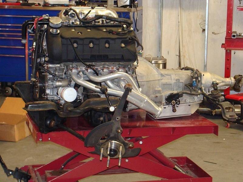

I've got the "Powered by Ford" COP covers in the shop right now to get some wild stuff done to them, and was thinking the black wrinkle would go well with them. Any advice? I'm not crazy about blue or silver FYI.

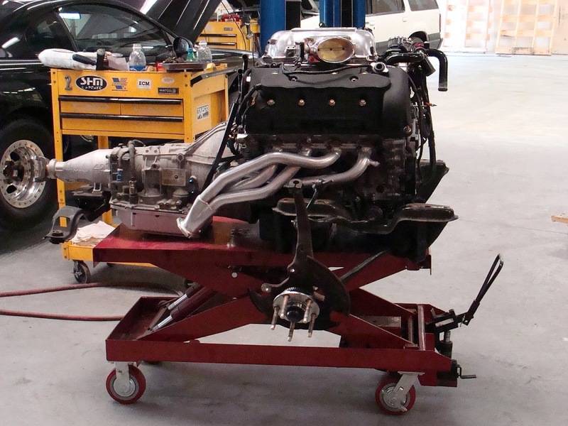

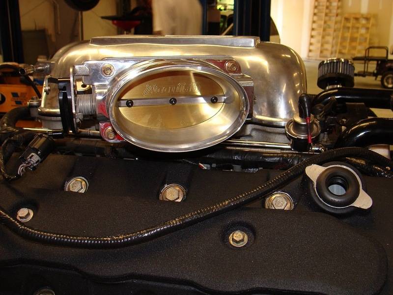

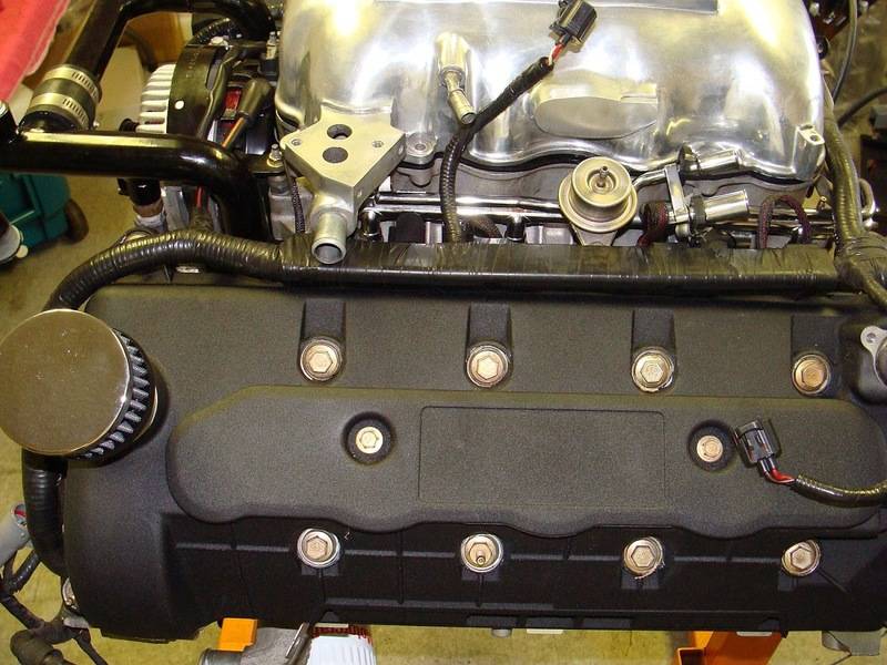

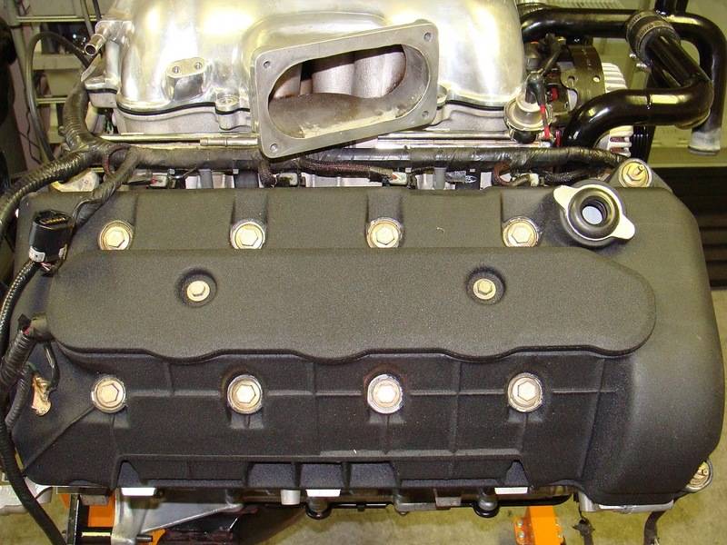

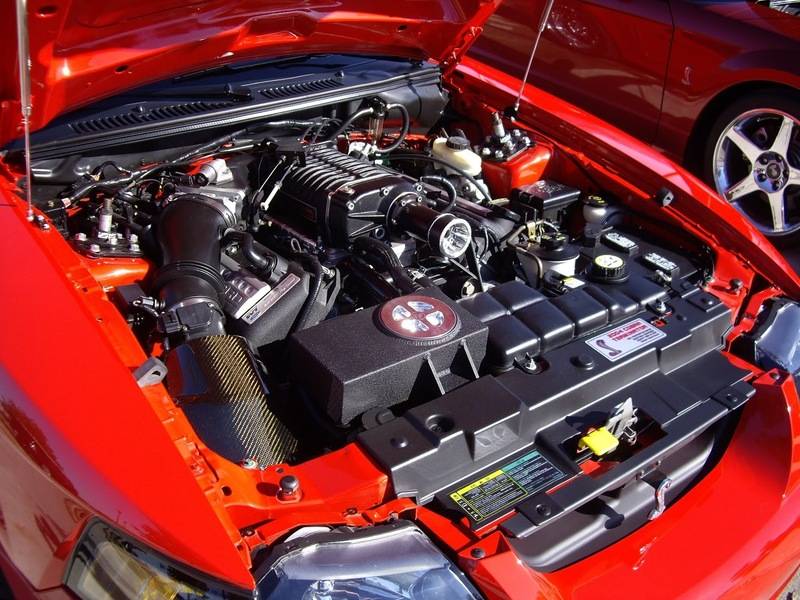

I have a black textured finish, and they are easy to keep clean with just an air hose. Don't put any type of towel on them though. Lint everywhere. It is way worth it for the coolness factor. I would do it again in if I had to, in the same flat black type finish :)
What did you use on the headers? I've never seen any type of paint keep it's color on those things.
Makes me so jealous cause I would love to drop the engine out the bottom of my Mark. Could get so much done so much more quickly :cool:
I purchased the headers with that silver jet hot ceramic coating on them.

I would describe the finish that it feels like sand paper.
the finish on mikes valve covers is called mini texture satin black. we use it on our spiral stair cases and railings at work daily. if you dont have the money to do yours in powdercoat, home depot sells rustoleum mini texture satin black paint in an aerosol that looks dead on to mikes valve covers, i know because we keep cans of it in out work trucks for fence and railing touch up, you cannot tell the difference from the paint to the powdercoat, and its 5 bucks a can!!

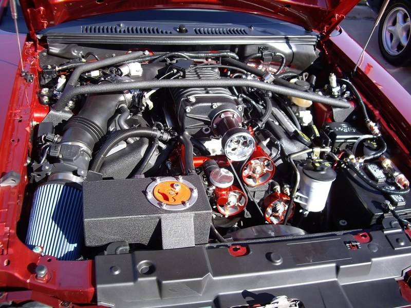

I like the black wrinkle finnishes. Here are my friends Kevin and Erics cars.:)

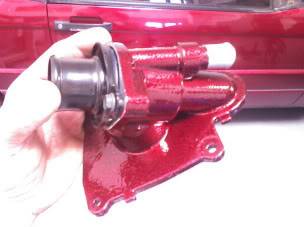

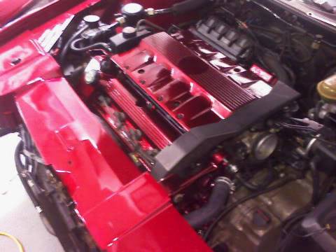

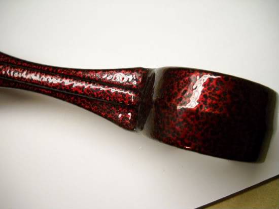

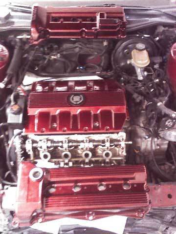

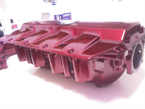

I used a red clear over silver vein - really easy to keep up...
wow red clear over silver vein i like that man, looks sick. i'm thinking of my valve covers and intake with a transluscent purple over silver vein i have been thinking for years to do an intake and valve covers a deep purple but that might look better over silver vein.
The vein in the silver also 'covers up' any tiny surface imperfections that you might have on the covers....
