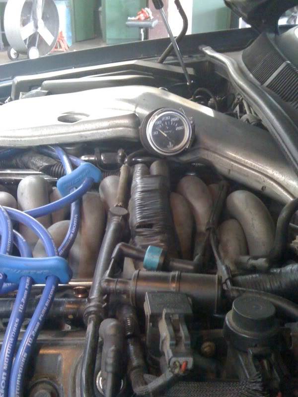

I keep seeing First Gen Mark VIIIs with various things stuffed in their intake hoses where the resonator used to be hooked up. Sapperfire has some gauge shoved in there and Ultimate looks to have a small oil filter shoved in his?

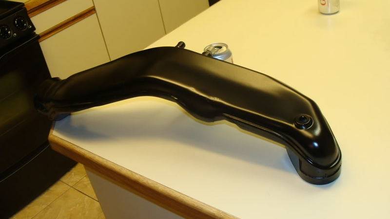

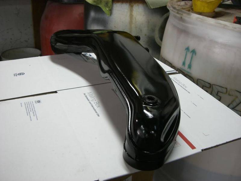

when i smooth them out i use a hole saw and i cut a piece out of the elephant ear that is hooked to that hole we all aim to cap off! i bevel the edge of it and epoxy it in, i then cover it in fiberglass resin.
this is one i did but the beauty cover went back over it so i didnt flush fill it like the others.

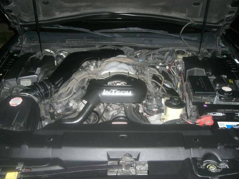

this was my black 93 i had, check out the 97 intech cover on a 93, dont look bad!
Mine is a $7 aftermarket temp gauge I picked up at O-o-o-Oreilly...
cut all the wires and stuff off of it and tightened it in the hose with the clamp...functional was the goal at the time...will be shaved...one day ...
I still think a mechanical vac gauge would have been cooler.
