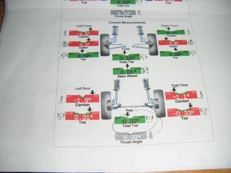

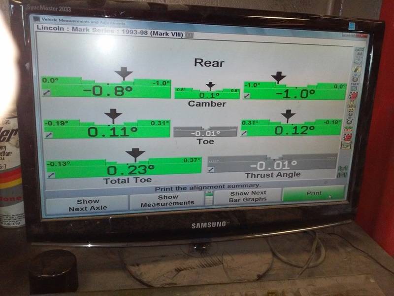

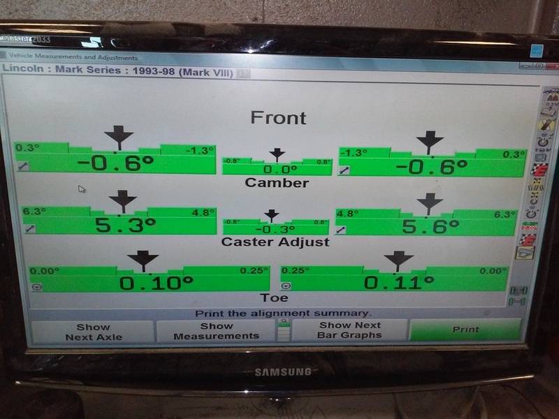

Finally removed and replaced the rear lca toe adj hardware. My god was that nut/bolt a seized on mf'er. Required fire and much powa but it finally free'd itself w/o breaking anything in the process. Utilized some clean hardware from our good friend Carlos.
Couple weeks ago we free'd up the "frozen" front end with ease so the next tech won't have any excuses. Looking forward to her specs being in the "green" for the first time in 9 years.
Back story- Many alignments over the years and many lazy techs failed to adjust her correctly due to "frozen" adjustments f+r. After all of this the only thing that was actually frozen was the rear toe.
Update:
Before-

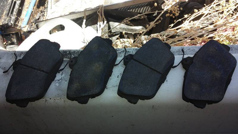

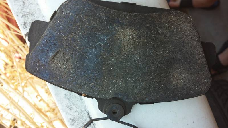

Very inconsistent braking, and could start seeing some hot spots in the front rotors, so I decided to replace the front pads.
Some bad spots in the pads, I thought that slotted rotors would help stop this from happening:
But I also decided that it has been 5000 miles, so go ahead and rotate tires (front to back, directional tires). Rear are completely bald, they were okay 5000 miles ago, I guess with my driving style I need to rotate every 2500 miles?

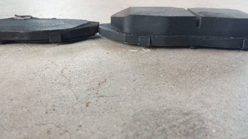

Pull off the back wheels and find the inboard side of the rotors have grooves, it looked like "plenty" of pad material left, but forgot about the locator spring and how it is attached.
Rear pad so worn down that the caliper piston falls out. I have only seen that before with the early MN12 calipers and late/FN10 thinner rotors. So I had the wrestle those back in so I could then screw them in.
nope, slotted rotors won't really help anything. just looks. (and less thermal mass so they heat faster and are more prone to cracking.)
those pads are trashed. what brand are they?
Bangster sounds like you didn't bed the pads in correctly
Bedding makes a huge difference in performance and how long they last.
I probably could have done better in bedding them in. They came pre heat cycled and scorched (the box within another box still smelled like a panic stop), and for the first 10,000 miles seemed okay. I also could take it easier on my brakes, I am harder on them on the street than most are on a road course.

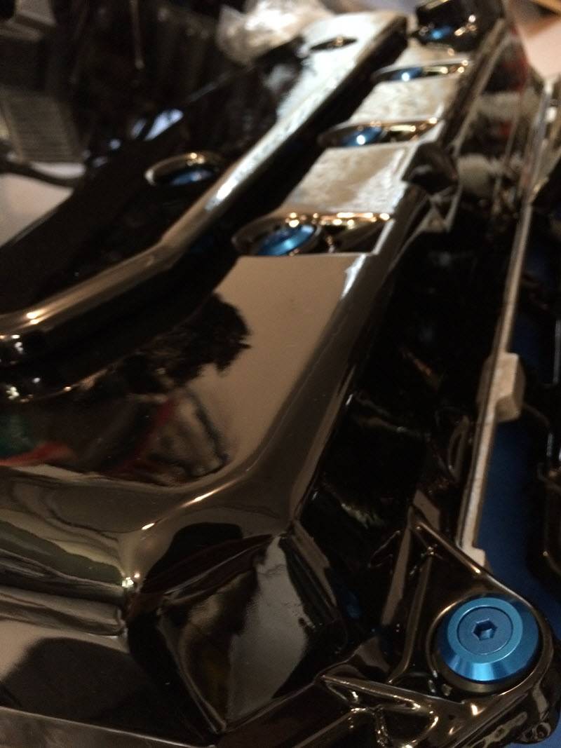

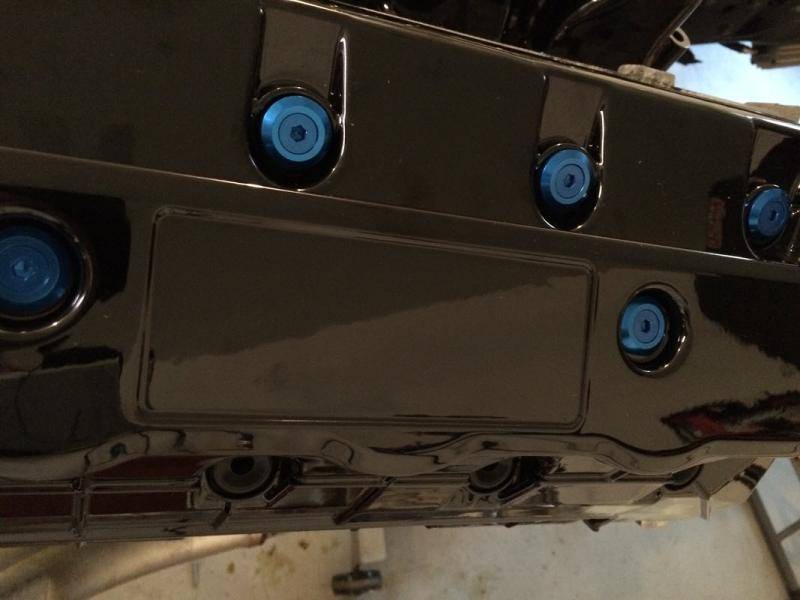

Got stuff back from the powder coaters...
I'm pretty sure a Big Fat Led Zep style LINKY tag is going in the rectangle area.

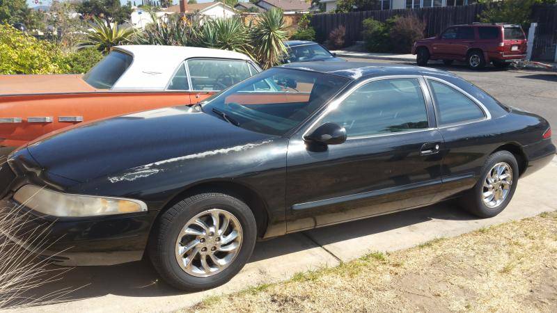

I purchased another 97 last week. A Black on Black LSC with 62K original miles on it for $2,250 in Beverly Hills no less. The car runs great and the interior is near perfect and was in the same family since new. The body is straight but the paint has the clear peal. The niece who inherited it at 47K miles nine years ago didn't continue the maintenance that Aunty did. The front brakes were wobbly dangerous but I limped it home to San Diego. Today for $57 delivered via EBay, I installed new slotted rotors with ceramic pads that solved that problem. Fairly easy as detailed on this site, but you definitely need a caliper compressor - thank you Autozone for the loaner.
The car also has the shifter data error CEL problem with the hard shifting to match. I found that the 30amp fuse for it was blown. After I replaced that the P light now comes on when you start the car, however when I put it in drive it goes blank. I found a new Transmission Neutral Safety Switch for $20.29 via EBay as well and when that get's here hopefully the problem will be solved.

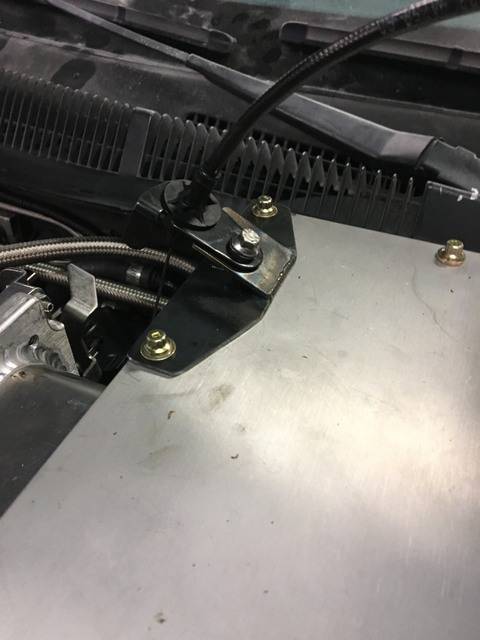

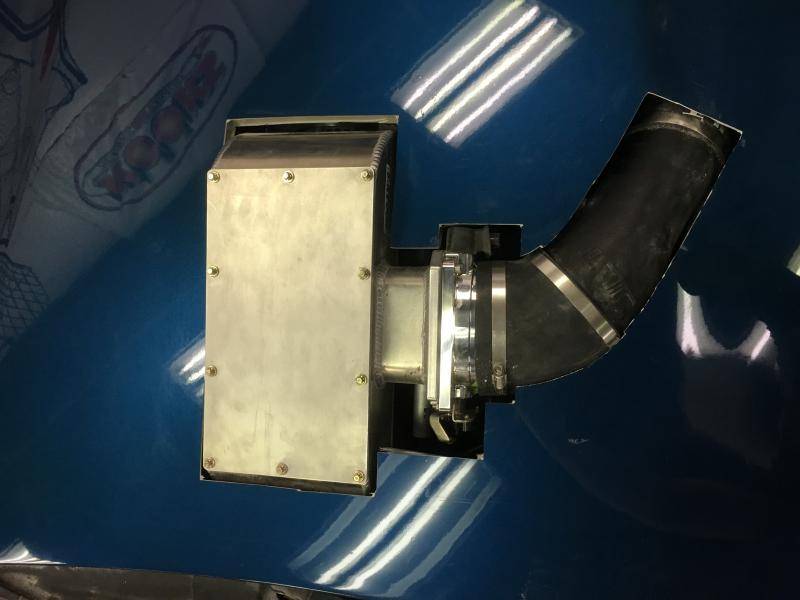

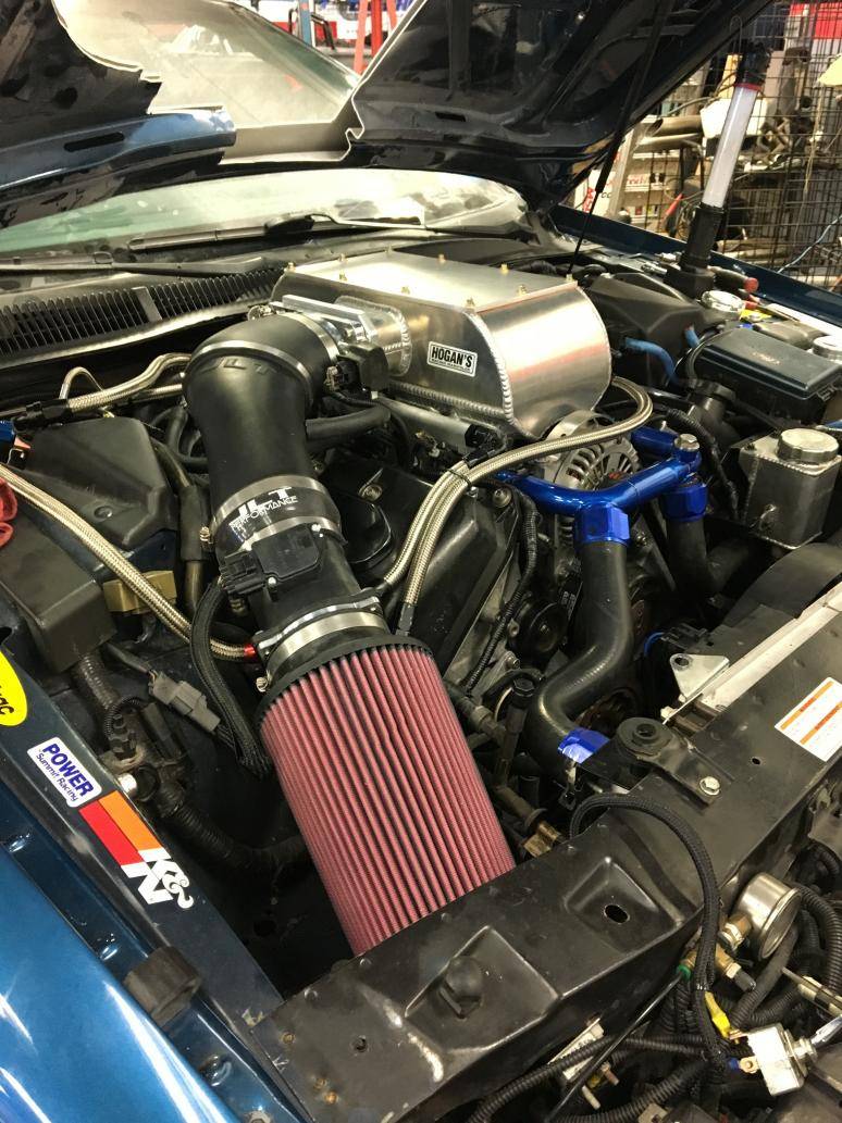

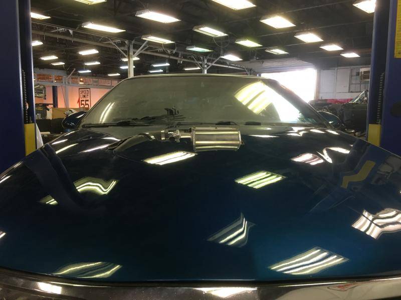

I was thinking of going with a bolt-on cowl scoop and just have it vinyl wrapped.
We'll see later down the road.
I was wondering what you were going to do with the hood after seeing that monster intake. I had used that Accufab throttle body on my Cobra. Sometimes when I let off the throttle fast it would stick a little when I would get back on the throttle.
