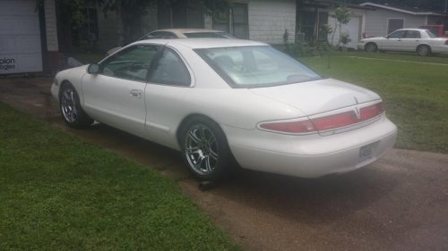

2 for Tuesday.jpg2 for Tuesday 2.jpgPulled my CE out of storage. Looks like the day I put it in there. The 97, and CE are the same paint, but look a little different.

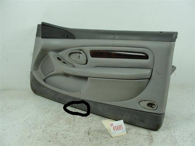

Did a little midnight repair and took apart the drivers door panel to fix some noises. Carefully tightened up all the little plastic nuts and bolts behind door panel itself, used some padding on a couple areas and adhered it w/ adhesive, wrapped some wires w/ foam tape where they were making contact on things.. That type of stuff.
It's a lot better now. :)
I'll also add..
I found a lot of noise was generated when hitting the lowest portion of both door panels in the very center. I used a 1"x2" long piece of trunk carpet, 2 layers (layers will vary) and slid it under the panel lip (flush w/ bottom) with adhesive under it. You want it to be a firm fit, pry it out a hair if it will help get the material under it. Noise gone.
Hit the spot and then hit it while pressing on the spot to see if there's a difference. If there is, try doing what I did. :)

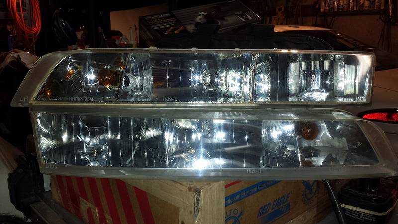

Replaced my passenger side ddm slim hid ballast in the 95 did tge drivers side about a month ago.
They lasted almost exactly 3 years bulbs still working great.
