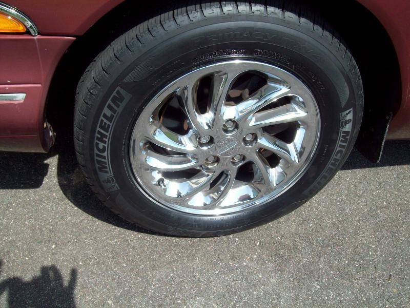

95 new wheels.jpg95 ch wheels.jpgI got around to changing the front air shocks on my 95. Nice new ford's did away with the klunk Arnutts created. 1/2 way there, so I put on the new tires and rims, that been hanging around for quite some time. Just a few more things, and wife gets her back. Oh yea, I got some nice Arnutts that don't leak for sale if you don't mind klunking noise. Very low milage.

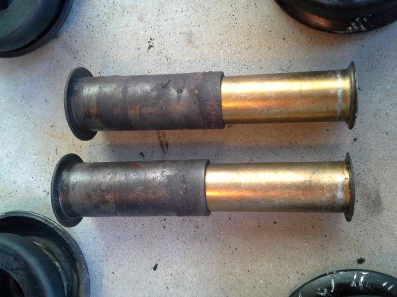

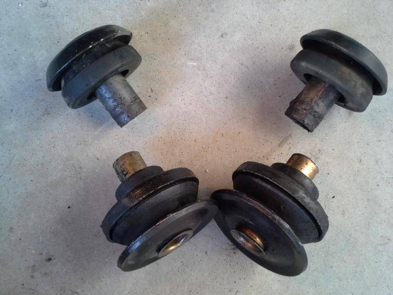

today I removed the factory SRBs at the subframe; I pulled out the bushings and sleeves very clean;
I know a few guys custom make replacement slip joint sleeves, per DLFs design (highly labor intensive) and charge well over $100 for a pair (4 pcs);Jay charges $135, DLF charged about the same or more, and Spree basically gave his away (traded for used parts).
I'm thinking of taking these to a local metal fabricator and seeing what they'll charge to duplicate the factory sleeves. Do they HAVE to be stainless steel? what are the oem's made from? seems like alum/alloy? Any predictions on what a shop will charge to make a batch of 20 or 30 pairs? If they're not much ($30-$40) I'll pass em along at cost

what's not cool? competition? I'm just wondering if a fabrication shop can whip out a box of em in a short amount of time- probably not as I'm sure somebody else has already gone down this road;
I wouldn't get stainless, so they'd be subject to rusting again in another 10-15 years (up north)...imo the sleeves don't need to outlive the car; one of the first things I noticed when I got a mark VIII is that a lot of parts are nearly impossible to get- Mark VIII owners usually don't own these cars b/c we have a big pile of cash to throw at the car
Can't believe you got them out, and they came apart....Good Job!

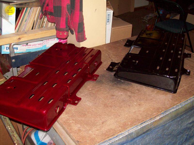

Just getting some stuff ready to install weather permitting. Nice trays Thanks Bruce/ Carlos
