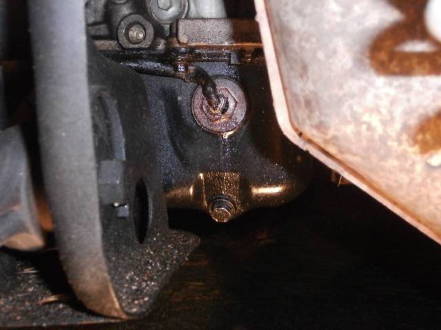

discovered another oil leak
is this a simple fix? I've already put a new ofa gask on this one

Did you degrease the bottom of the engine after the o f a g fix? That just looks like blow off.. or the oil pan gasket.
Heres a tip for ya if it is the oil pan... pull the oil dip stick out and throw it in the trunk until you complete the swap, you'll thank me later ;)
mmm, yea, definitely cleaned it around the front, where the ofa is...not so much back here...not leaking from where that sensor goes in?
Finish cleaning.. double check in a day or so after running, that's the level sensor and rarely leaks
