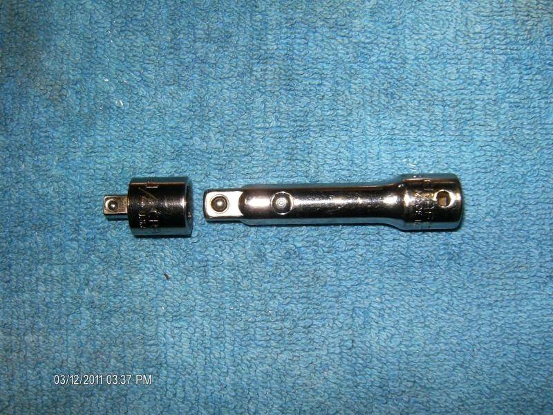

I dove into the oil adapter gasket today , had more trouble with the dang hose clamps than I did doing the gasket . Don't want to admit how long I was under the car but the wife is use to it. Got cold and dark so I'm done for the night . Seems the crossover fill plug is stuck can't seem to budge it afraid I'm gonna strip the square , why couldn't ford make that fit
A 3/8 I will never know .. Any suggestions on getting that loose? Then I can fill the coolant back up and get her going . I've had enough for one day have to finish next day off. Oh ya I did put a new thermostat and oil sensor in it while I was up to my elbows in coolant , this job has to be a right of passage for a mark viii owner .
Heat it up (I use a heat gun) and then use a 3/8" - 1/4" adapter on a 3/8" ratchet, it's less likely to break than a 1/4" ratchet.
I used a giant set of channel locks to break it loose. Was better than stripping the 1/4 hole or breaking that lil ratchet :rolleyes:

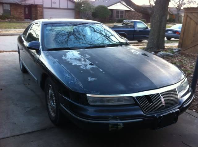

Did UCA's, LCA's, End Links and Coil Conversion on this beauty yesterday..... 94 Black on Black that had a hard life....
Jesus, now it's time for some flat black and a corner light...Though I highly doubt the owner gives a shoot.
Owner don't care, just his daily.... trans will be out in the next couple months I'm sure... slipping way bad
