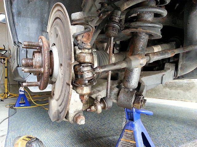

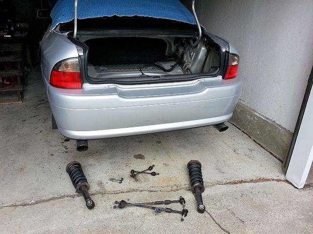

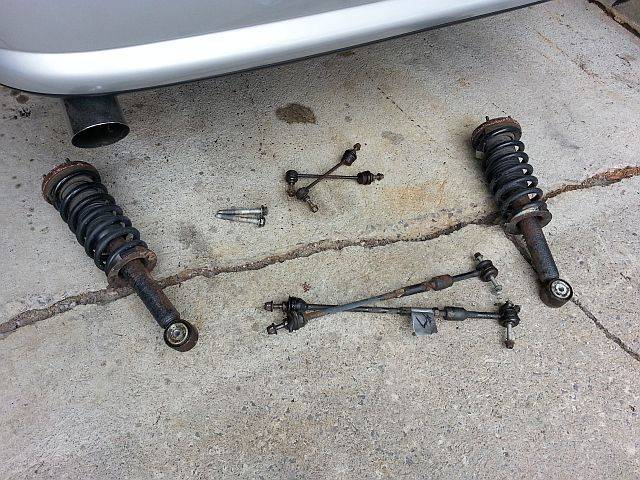

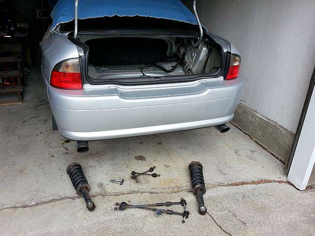

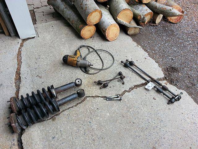

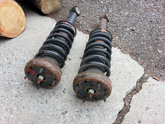

Started on this crap today.

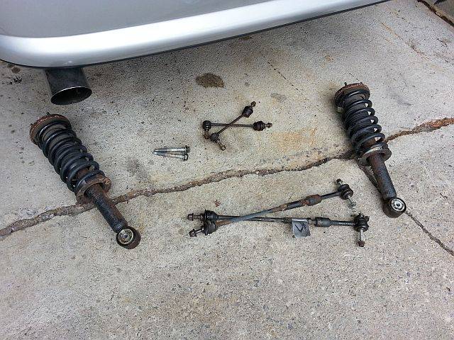

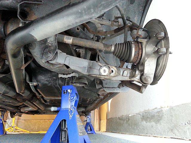

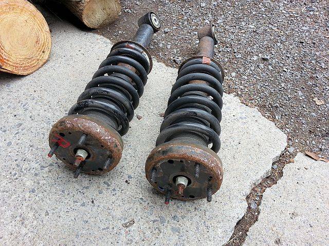

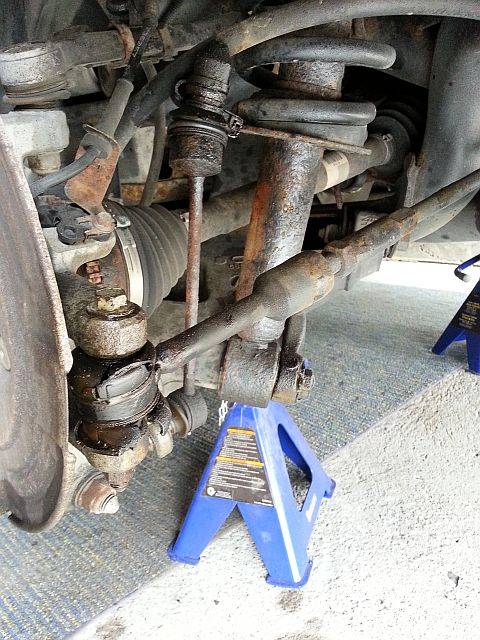

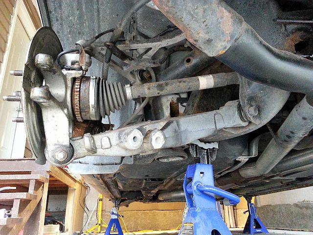

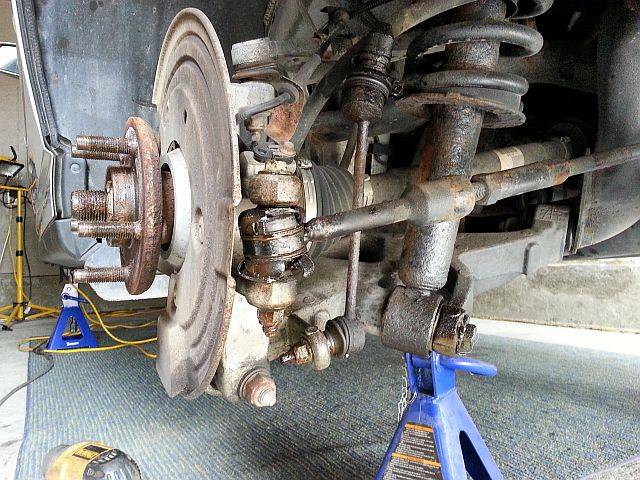

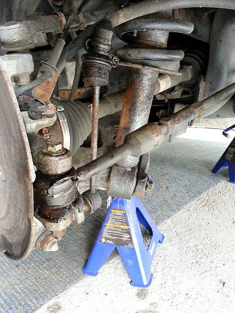

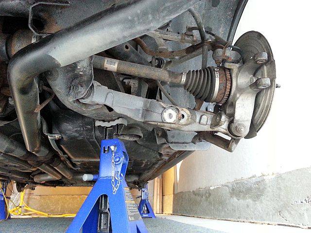

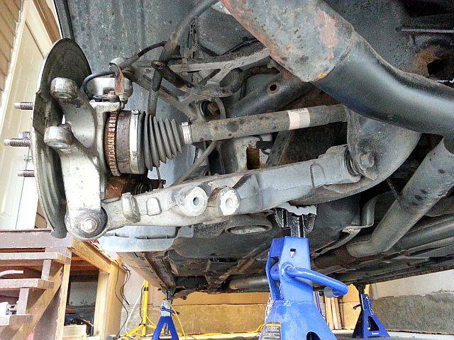

Still have to get both rear upper control arms out. Passenger side is shot!
Came out pretty easy after applying penetrating fluid on it for several days on end,
torch helped also but only needed on inner bolts to frame for the Toe Adjust End Links.
Lots of cleanup needed.

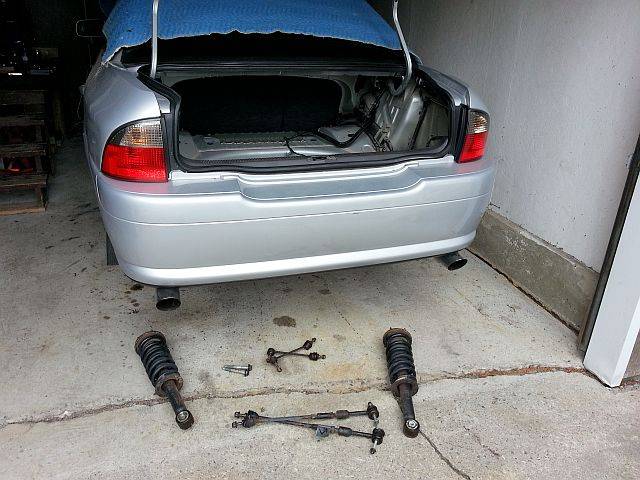

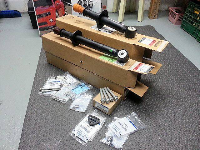

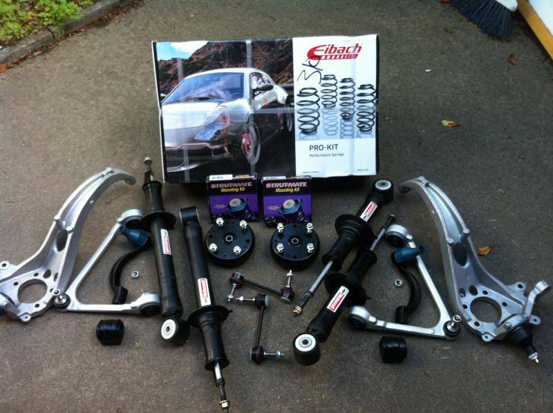

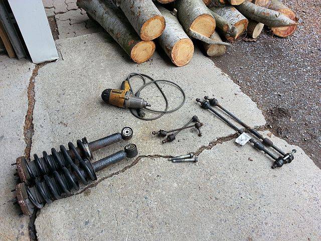

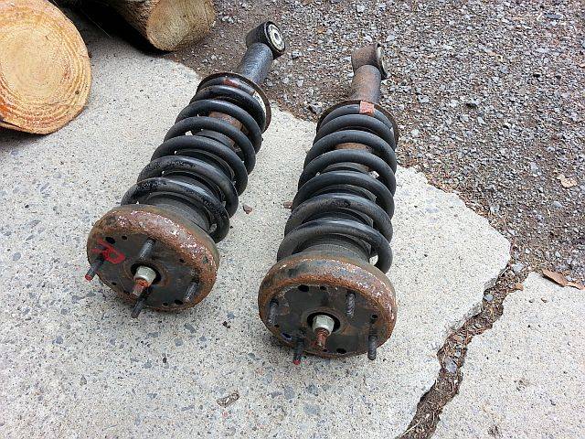

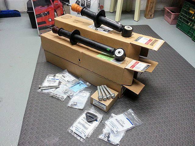

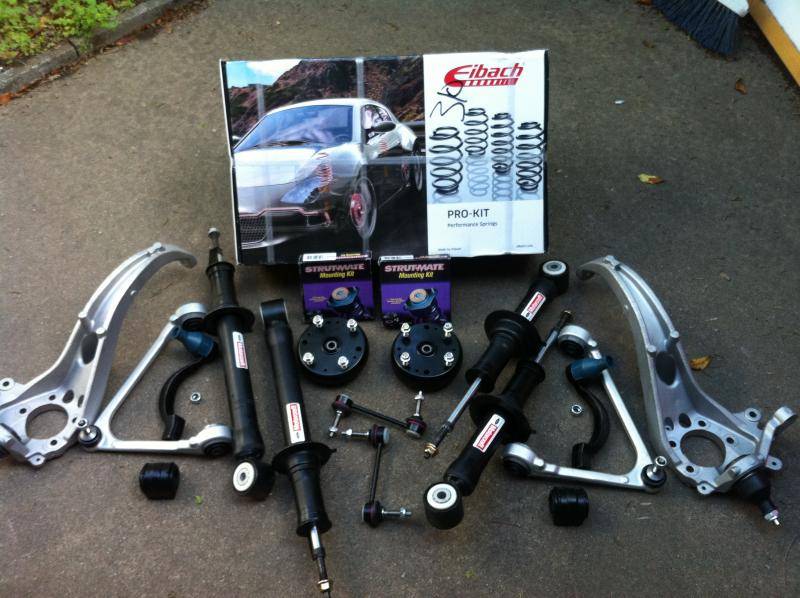

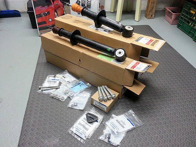

Have the rear Eibach lowering springs w/ new OEM shocks and fresh hardware going in.
Fronts already have the Eibachs in but new OEM shocks going in as well.

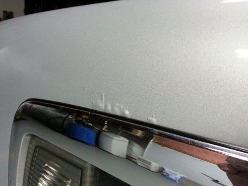

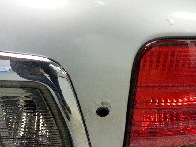

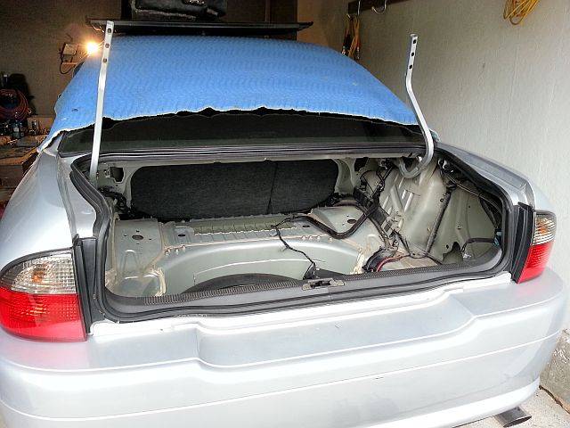

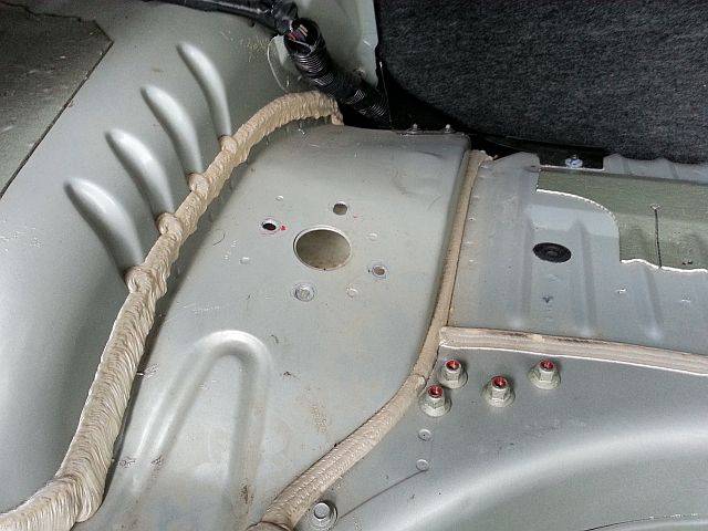

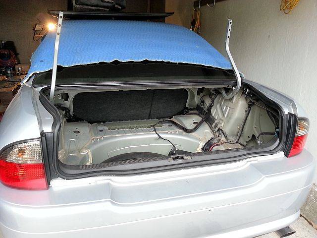

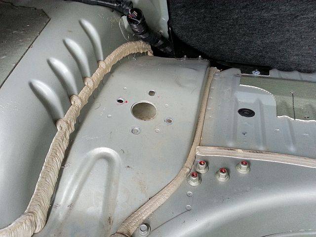

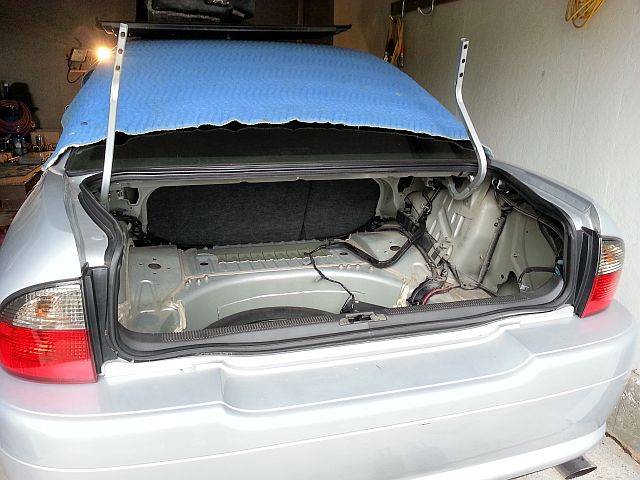

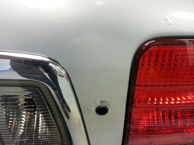

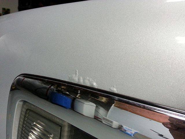

Trunk lid off for corrosion repair around keyhole and surround.
attachment.php
Surround and LSE spoiler to be color matched.
Wow what a busy weekend. First I went by the local Paint and Body Supplier, and had him mix the correct color, then I painted the lower rocker covers, the same color as body, to give the illusion of sitting lower, looks great. I painted the faded Interior silver pieces black, to match the existing black Trim, Installed the new console surround, with the one that came in, installed the BMW M-5 rear spoiler, and also painted it to match. already looking much better.

Are those OEM Sport shocks?
Supposed to be ... Stealership ran my VIN and came up with the following:
VIN: 1LNHM87A91Y674425
2001 LINCOLN LS V8 SPORT
Code: DWAAE // Description: SPECIAL SUSPENSION
- - - - - - - - - ORDER - - - - - - - - - 2001 LINCOLN LS V8 SPORT // SPECIAL SUSPENSION
2X Front Shock Absorbers // 18124 (AST-25)
'00-'02 V8 Front "Special" (Sport) Shocks: ASH24464 or BU2Z-18V124-R or 1W4Z-18124-DA or AST25
1W43-18045-DA - AST25 - Shock Absorber FRONT COLOR CODE GREEN - w/PERF SUSP
2X Rear Shock Absorbers // 18125 (AT-704-G)
'00-'02 V8 Rear "Special" (Sport) Shocks: ASH24468 or BU2Z-18V125-U or XW4Z-18125-BA or AT704G
1W43-18080-BA - AT704G - Shock Absorber REAR COLOR CODE PURPLE - w/PERF SUSP

Borrowed a friend's brake tool set and turned the rear calipers all the way in/out, then left them close to all the way in.
Both rears don't appear to be tight or tough to move. Further cleaned up. All four brackets going for sandblasting.
