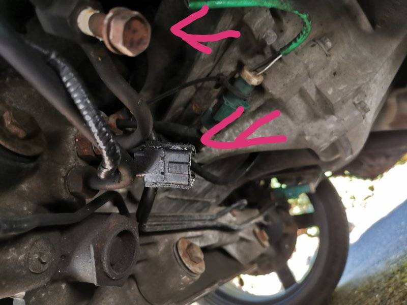

Well over the weekend I found my rh front sway bar end link was ripped apart..so threw a bolt thru it till today going to get a new one now. But also saw this while under it poking around. Power steering pressure sensor? Any ideas ppl ?

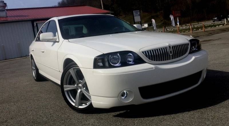

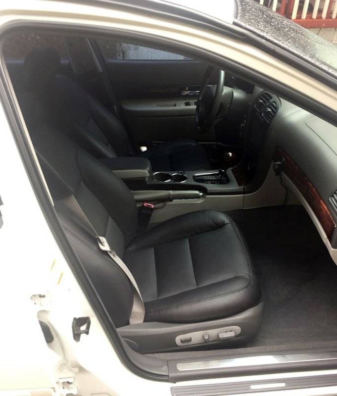

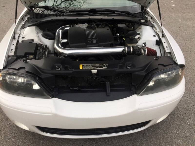

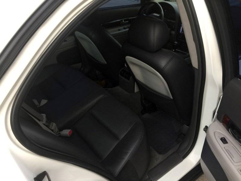

2006 bumper cover, halo headlights, halo LED fogs added. Rare optional perforated & logo embossed Gen1 front and rear seats added and dyed dark graphite to match interior theme. One piece aluminum cold air intake added.

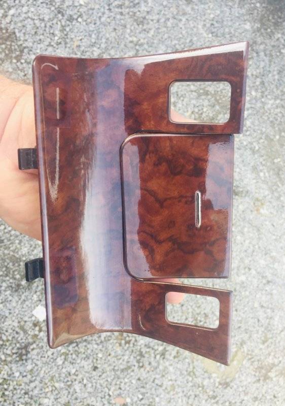

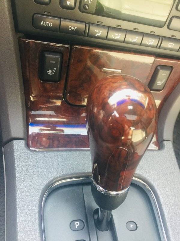

Some small details that make huge differences. After the shiny new walnut shift knob the ashtray and heated seat control walnut trim items were showing dullness ageing / scratches and not as vibrant. Took them off, wet sanded with 600, shot 5 heavy coats of clear, let dry two days, wet sanded with soapy warm water using 1000 then 2000 grit, and then a good hand polish with compound. Perfect match now. Wish I had taken some before pics.
Any suggestions on the type of clear? Will 2k work? Duplicolor?

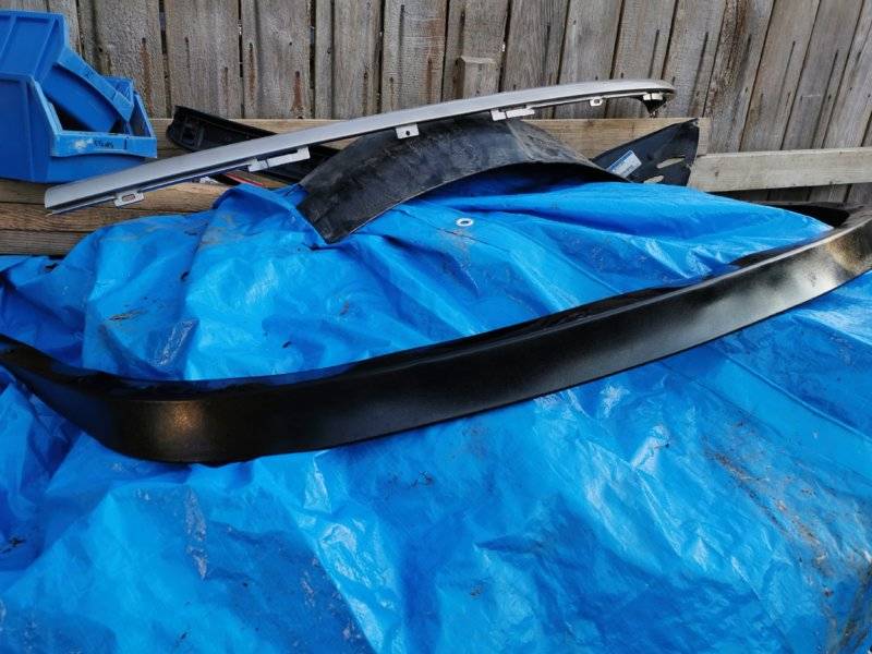

Well Ween going to the pick and pull everyday this week (as work is shut down...damn corona) and stripped more from the 02 in the lot, got a woodgrain steering wheel, and scored a mach 1 lip off an 02 mustang! I'm stoked! So currently going thru my haul and cleaning em up for paint etc ...pics to come

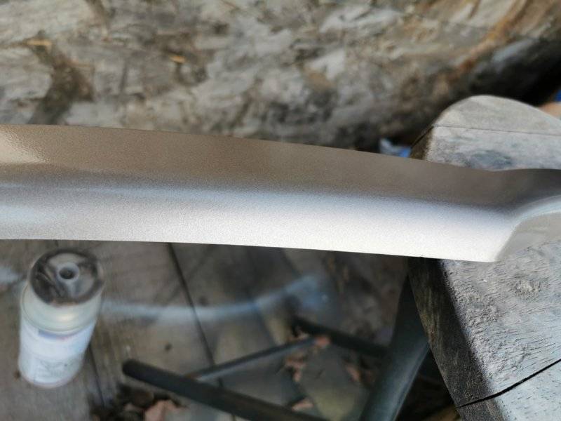

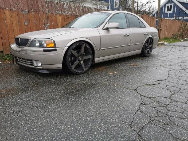

Spent the day washing and prep/painting the parts I scored from the junker. Tomorrow will be an install day
DuKeNoMaD
Feb 2, 2020
175
46
Vancouver
Ok so only installed a little..had to declare some bits...but got the mach 1 lip on. Damn it looks good
DuKeNoMaD
Feb 2, 2020
175
46
Vancouver
Installed some freshly painted side skirts....looks so much cleaner than the black plastic (also discovered I have a bad Rus problem on the rear rockers )

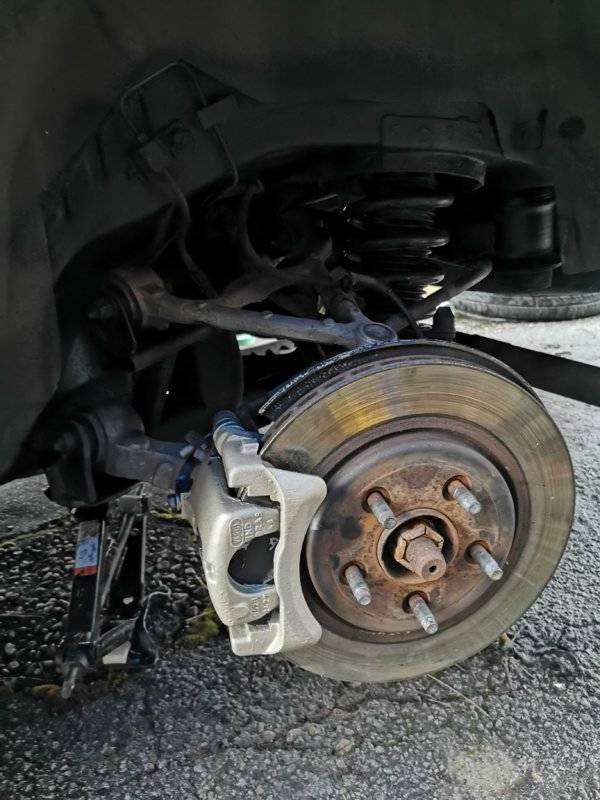

Well to add to the tale, got a VI today. So now throwing in a set of gently used motocraft struts. Rear is done.
