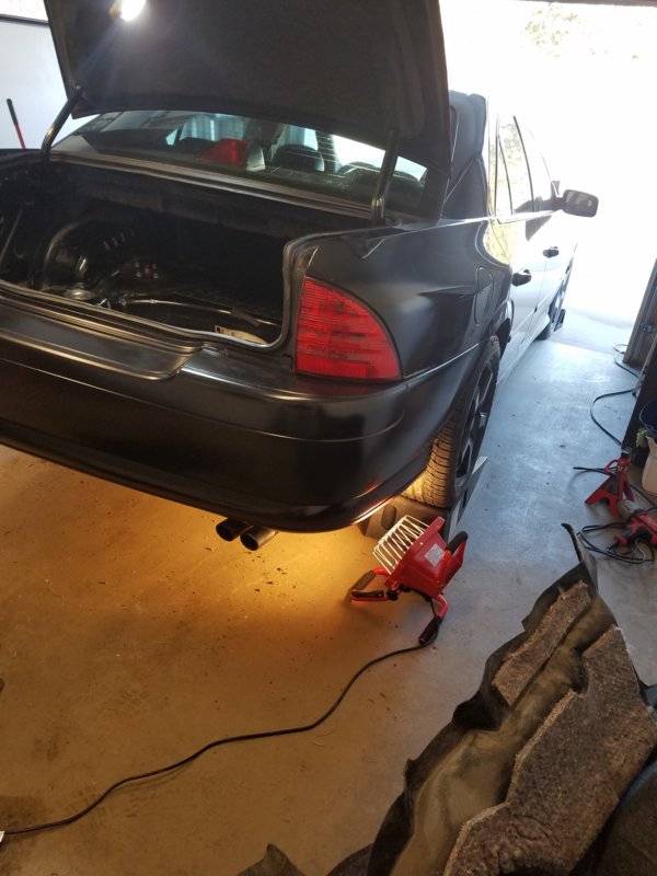

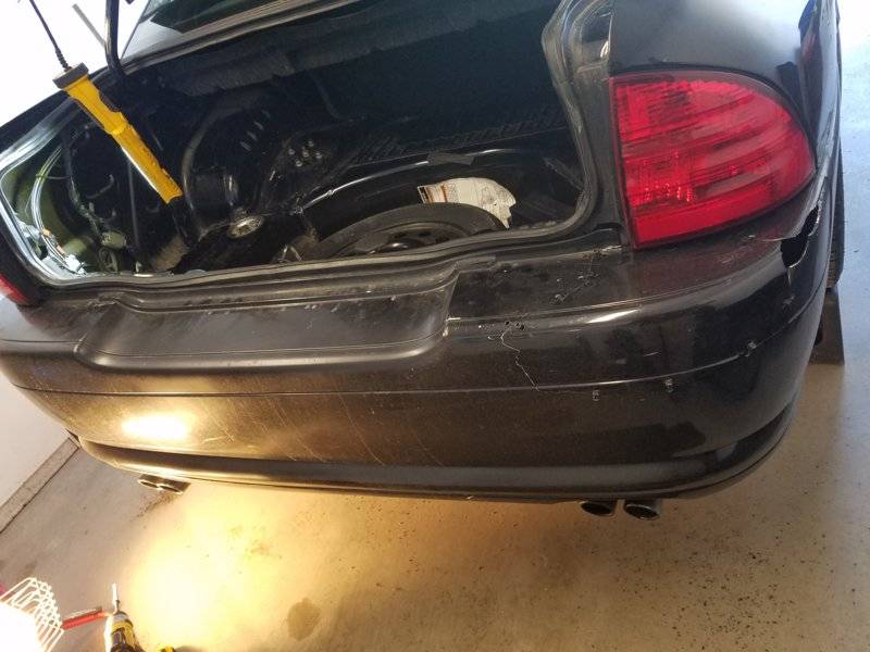

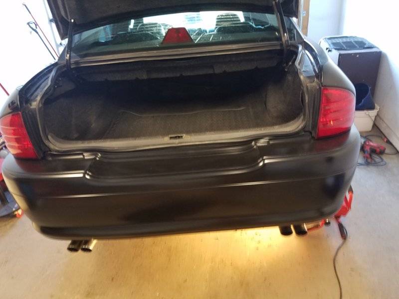

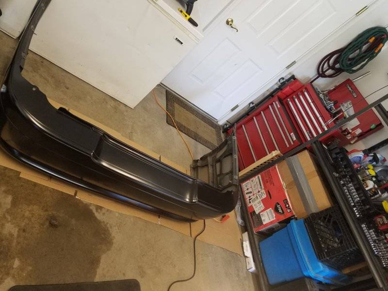

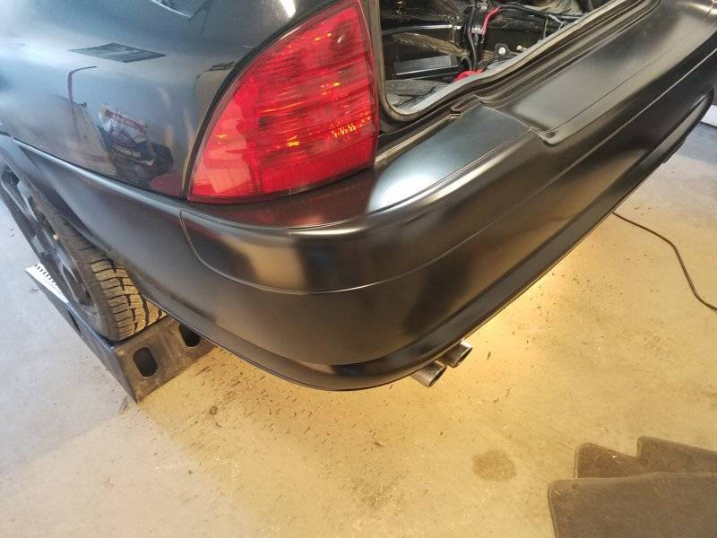

I replaced my rear bumper cover today but found out the LSE rear valance is much easier to get off than the regular LS Valance...5.5 millimeter bolts on LSE Valance and they put Phillips head screws on the LS valance which are rusted and then strip easy ...so will be putting on the LSE valance later but here is the difference

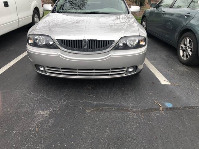

Today and I have been wanting to do this for some time now, restored the headlights on my ride.
Various fine grits of wet sanding, heavy cut polish followed up with fine cut polish and a lot of elbow grease.
Came out looking pretty good.
The original UV coating on the lenses is now gone. Looks good, but they really need a top coat or else they'll haze up in a few months. 2k clear is what the headlight pros use, a 2-part clear in a spray can

I’m pretty sure the top coat has been trashed long before I hit it yesterday, the many scratches and wiping bugs guts off over the years...
I did however apply a good quality wax on them yesterday, which will help in the interim.
I stopped short of doing a great job on the headlights because 2500 grit was the finest wet sand paper I had available.
I can still see some fine scratches when getting up close and personal.
I really want to hit it with 3000 and follow up with 5000. Then rough cut polish, fine cut polish, 2k clear and finally a wax.

I have an 2002 LSE V8 ...My rear bumper cover was damaged before I even bought the car ...picked up a Rear Sport Bumper Cover from a Salvage yard ...I didn't have time to swap the LSE Valance with the sport Valance the day I replaced it because like I said in my post...the LS Valance has philip head screws and they're rusted into place ...Taking my the LSE Valance off the broken bumper cover was a breeze because Ford used 5.5 mm bolts to lock it onto the Bumper cover ...so the LSE Valance is still sitting on a shelf in my garage ...I will swap it out this summer

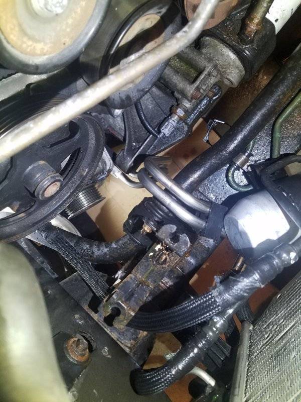

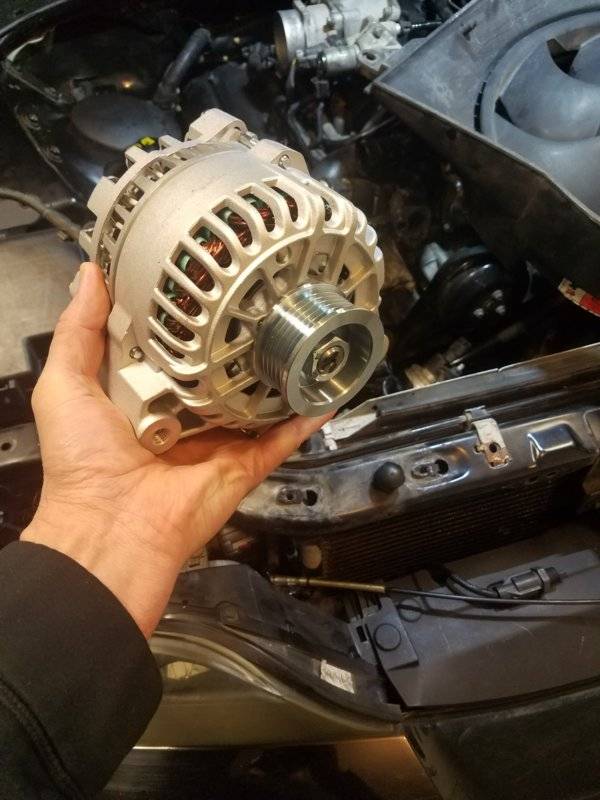

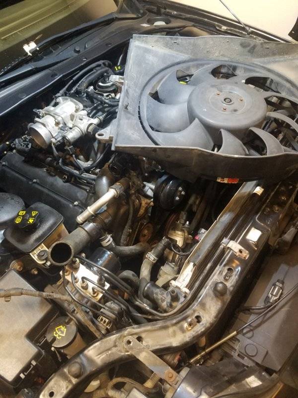

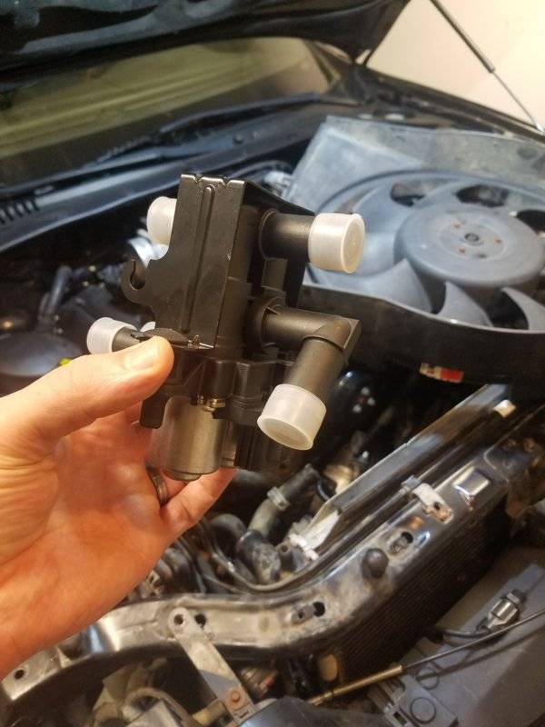

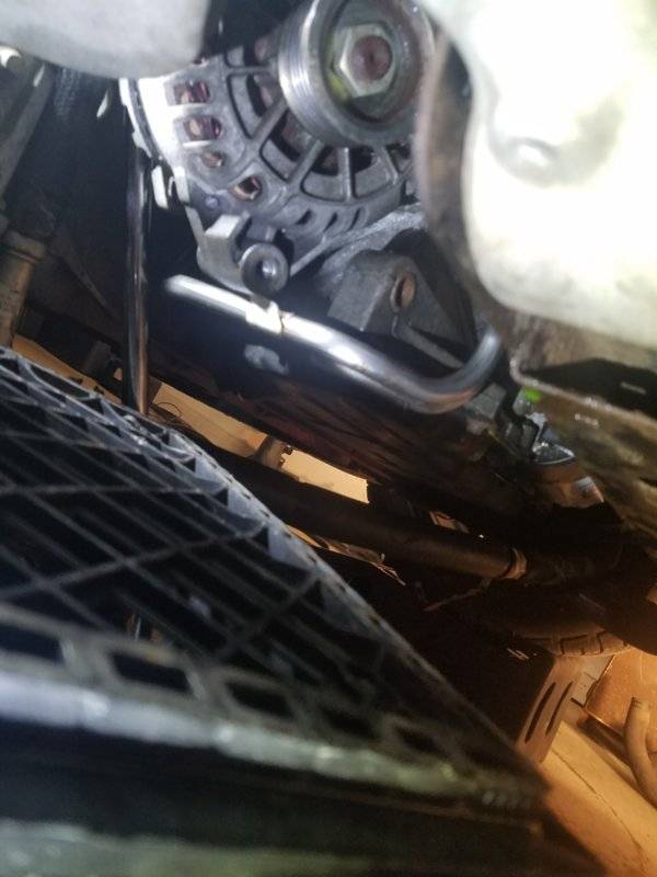

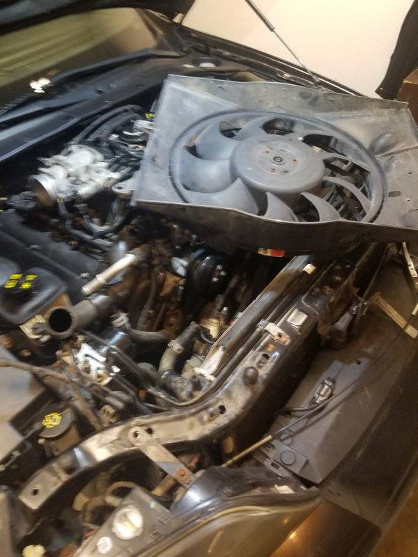

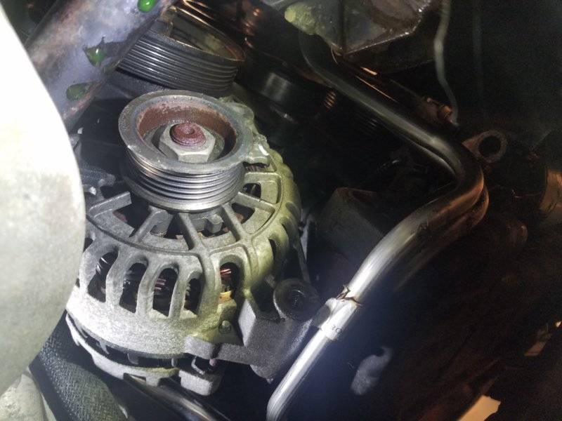

Rebuilding coolant system and installing new Generator ...the infamous DCCV ...at least I learned from doing it last time to take out the fan shroud
Just a quick note for everyone with a 1st Generation Lincoln LS 3.9 if the generator is original it will need some persuasion coming out after you remove the three bolts and I found today that removing the DCCV and fan shroud is making this replacement a breeze
