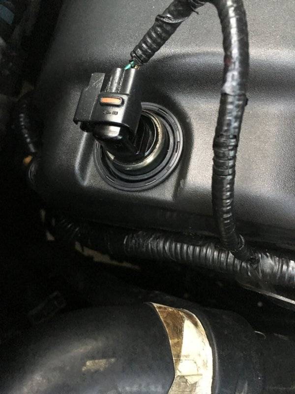

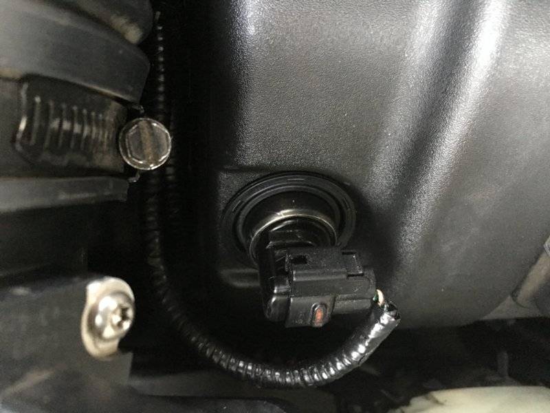

I changed out the VCT seals. It was getting a bit messy and I would occasionally get a whiff of burning oil. $30 at the dealership. Pretty simple switch in and out. What made it the most difficult was not wanting to scratch the valve cover black paint. I'll post a picture when I get back into town from business trip.

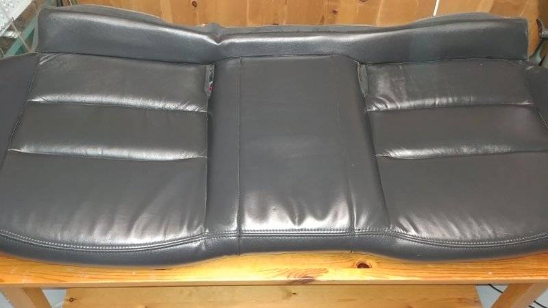

Had to take the rear seat out to swap the fuel pump (and vacuum up all the rat poop) so I cleaned and conditioned it a bit.

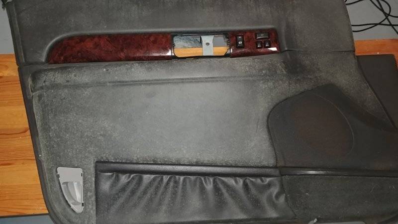

Also had the door panel off to have a go at the window regulator. I'm ashamed to admit that the entire inside of the car looked like this after taking the cover off after 3 yrs.
Here are a few pictures with the new seals.
