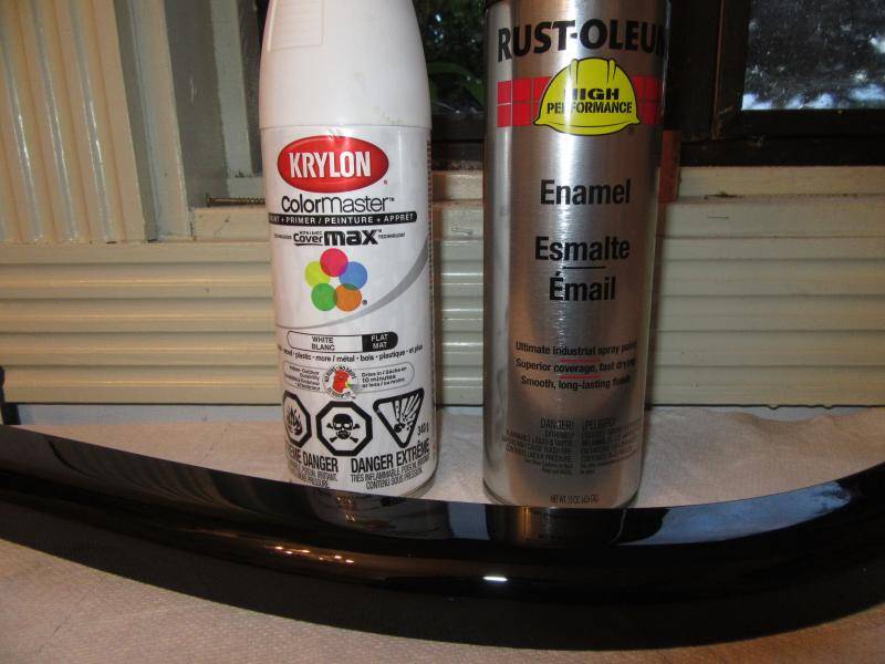

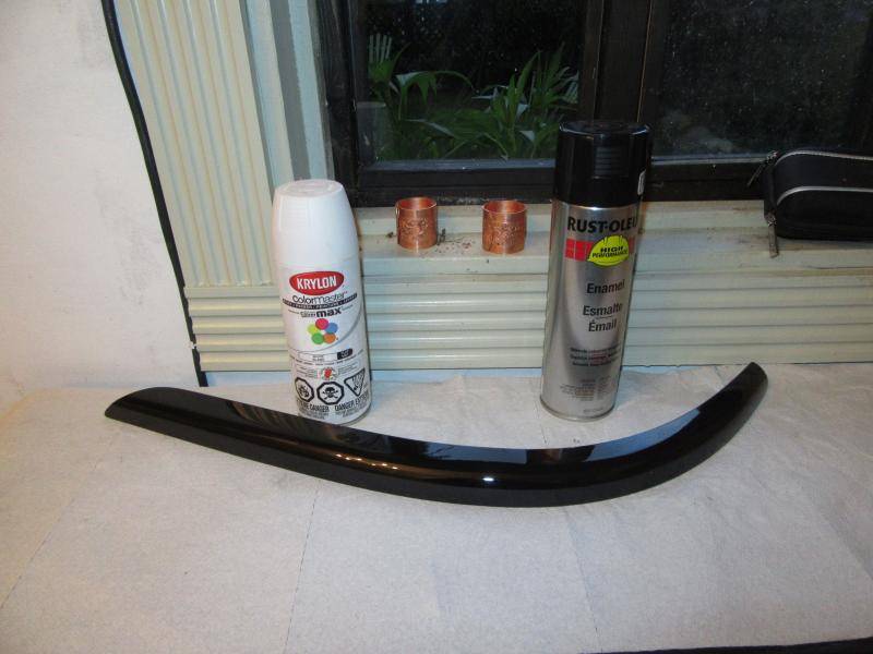

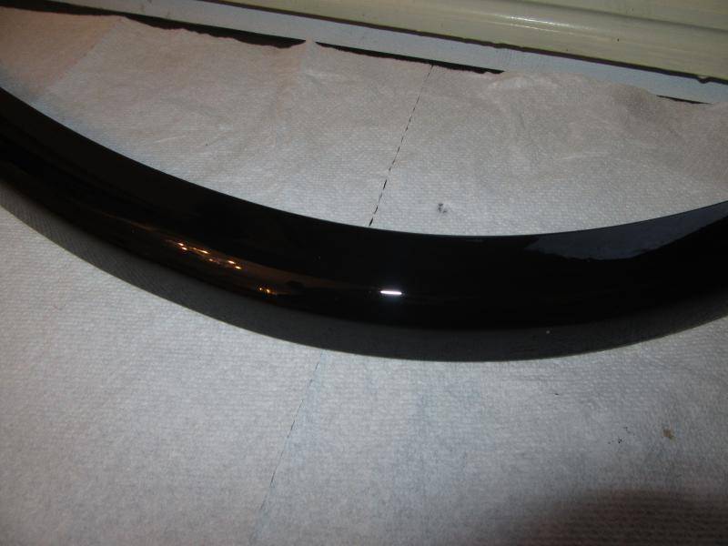

So I got some metal enamel and some primer.. This piece is just one coat of the enamel paint with no sanding and no primer and it looks amazing already. I am going to lightly sand the second piece with 600 grit and prime it then paint it to see what one turns out better. Then I will use the preferred process on my front two trim pieces. IMG_0342.jpgIMG_0347.jpg
replaced the fuel filter and rotated the tires...then realized I am in need a suspension pieces pretty quickly....
I need to do this to my rear spoiler, it's looking pretty rough
turned out like **** with just 1 coat no prep other than cleaning... 2nd coat orange peeled... light sanded down the other trim pieces and uses krylon metal primer and about to throw my first coat on lightly
