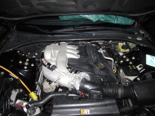

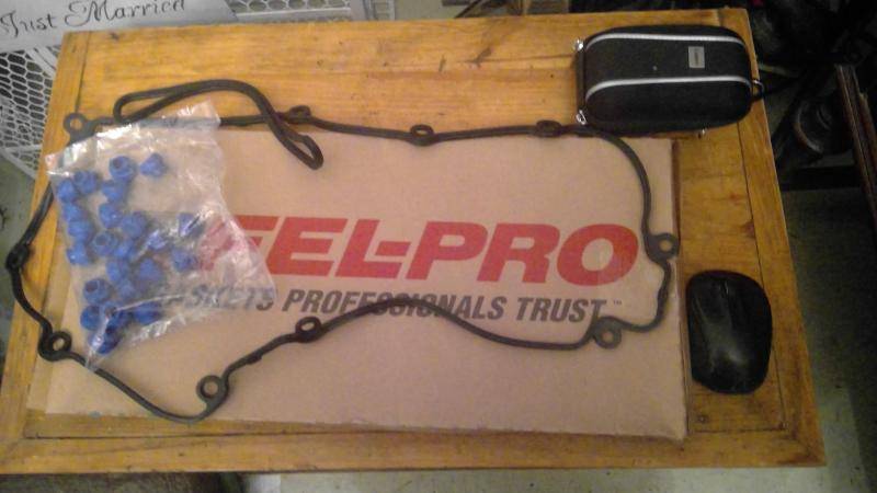

Upper intake gaskets came today so I figured i would get crackin on the valve cover gaskets.. should be driving by dinner time tomorrow WIN_20160617_21_25_16_Pro.jpgWIN_20160617_21_27_27_Pro.jpg
Just finished up the tune up.. It wasnt even close as bad as everyone said it was going to be... valve cover gaskets,plugs, coils, pcv, crank case vent hose etc... oil change blah blah blah lol... IMG_0429.jpg

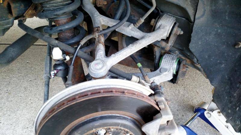

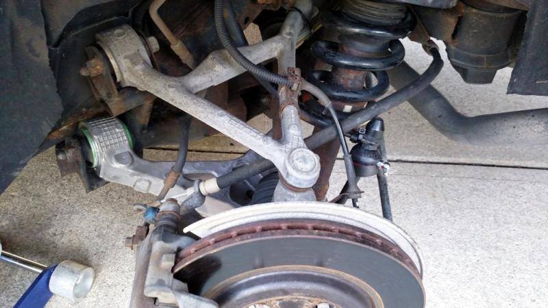

Okay since posts without pictures followup are always frowned upon...
I replaced the passenger side LCA and both rear sway bar link ends while I was in there with Moog HD greaseable units. Yes I know the factory Sport shock housings look rusty, but they still dampen just fine and are not leaking. Plus after replacing the LCA, I now have to save up for the Bilstein B4 struts/shocks.
Wow, that is one rusty underside. Sorry for noticing. Where do u live? Where has that car been stored? Just curious.
Now about those Bilstiens: after reading posts by you and others, I was sold on getting some of those (Jaguar parts?) for my sport 2001 LS. Then, I looked at the prices on FCP Euro and even with a 5% discount and free shipping they're in the high $300 apiece. Maybe since they include the spring and are Bilstiens they might be worth it but certainly saving up will be necessary here as well.
PO had the car rust proofed when new and never drove it in the winter, but the car is now my daily driver so it has to deal with mid west winters (three now). The sub frame has some very light corrosion in spots, but the uni-body is still clean. Do not ask me why the struts/shock look like they are 25 years old with 200K miles on them. They are the factory originals with only 52K miles.
