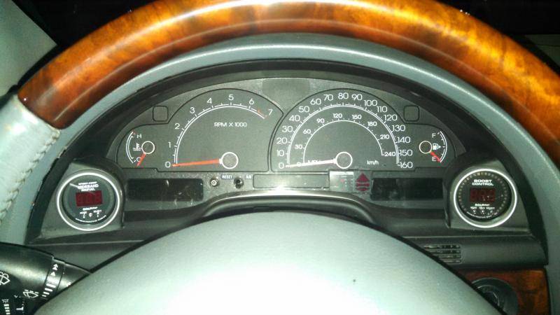

Wideband installed last night
Wideband on the left, boost gauge/controller on the right.
Looks good with that set up (including your radar detector under the speedometer). I think your build will also show how the axles hold up under higher HP. That could be interesting.
Thanks. The radar detector was a "prototype" to test fit and practice on. I have the second attempt finished, just need to swap them out.

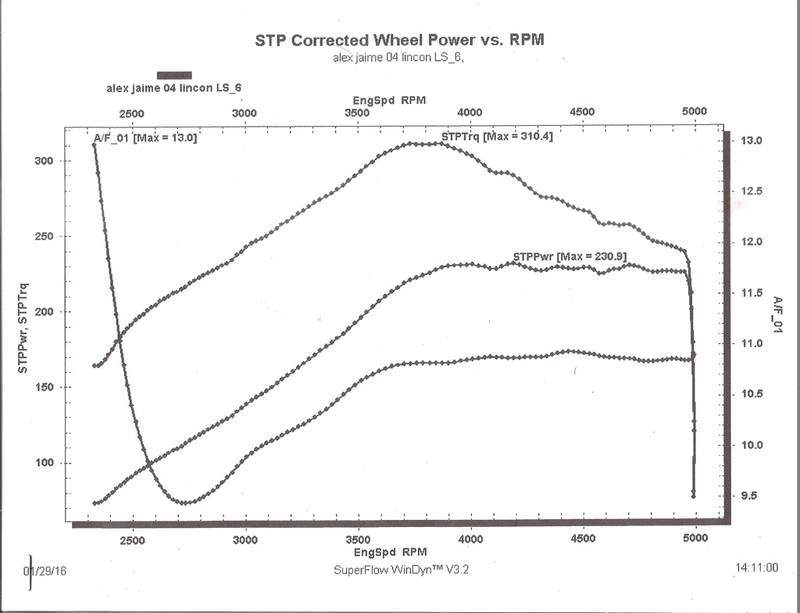

Tuning session was 90% failure. First can't do 12psi, bummed about that but alright I'll take 7psi. Next issue, we never even got a chance to crank up the boost to 7 because we couldn't even get to 5 lbs before the throttle body would close and not allow the engine to redline. The tuner said it was some kind of failsafe code, the pcm probably detected some issue through some sensor and to prevent damage it would restricted the throttle body from opening 100%. It would rev up to about 3500rmp and then plateau and not climb anymore. Whatever the issue was, it had to be fixed before it can eve be fully tuned. He tuned ir for drivability so at least I won't damage the engine being lean until I can fix it but until I fix that issue, we can't even baseline at 5psi. I was very very bummed about this part. So a set back indeed but oh well, at least I can drive it around safely.
Anybody have any insight on this? I'll post the dyno run sheet so you guys can see this run plateau vs the 5psi from a while ago.
That's strictly a programming issue, and the bad news is that may not be something that can be dealt with. Without seeing the program log, my guess would be the turbo is boosting the manifold pressure too high. The MAP sensor detects this, the computer decides it's too high and shuts it down. In the GM world boosters will use a 3-BAR or even a 4-BAR MAP sensor, and use a program like EFI Live to program it. I think SCT offers a similar tuning package, you might contact them and see if their tuner will allow you to convert to a 3-BAR MAP. If the programming can be made to accept the new MAP, then you won't have any problems.

Old 5psi tune dyno run
Current dyno run with throttle issue
that is definitely very odd, I would suspect that someone would need to see all the engine data to figure out what and why the car is doing that...
I wouldn't think that it could be a overloaded sensor since the last time tuning the car, it had no problem at the same power level. I'm not saying that it couldn't be a bad sensor or damaged wiring, but the sensors were working fine for the last session.
No, it is almost certainly an overloaded sensor, and it would be the MAP sensor because the turbo, when turned up, is boosting pressure in the intake manifold. He's trying to tune for power now, which means turning up the boost, and that he's only able to get to 5PSI before the computer says no more almost certainly means the MAP is going out of range and the computer is going into a safe mode. I could be wrong, of course, as I'm no turbo master but I just can't see how it can be anything else.
If nothing else, I'd suggest uploading the tune and the scan parameters to whatever forum the tuning software company has to see what might need to be changed to fix the issue. While I may not be a Lincoln fan, I'm always up to see what can be wrought from any car. I'll tell you all a secret, I even occasionally think, what if I were to just make my LS a project and put a suitable engine in? What if I just put it in the upcoming garage and corrected all the GLARING ENGINEERING FAILURES on the car and made it the car it should have been? But then I think, why not put that same power into a nice little Fiero? Or maybe a late 60s Volvo P1800? Or even that 70 model Pontiac Apollo for sale in the next town over? Or hey, how about that Datsun 280Z 4+4 I passed yesterday? Or even, dream of dreams, I pick up another 1972 Buick Skylark, which was my first car? My actual first car has been beer cans for decades now, but I could always find another...
just saying... it wont even get to the point where it was before... if he was at least getting to the point he was at before, and it wasn't allowing them to turn it up farther then I could see that being the case, but he is still 70 hp away from where it was at running fine...
