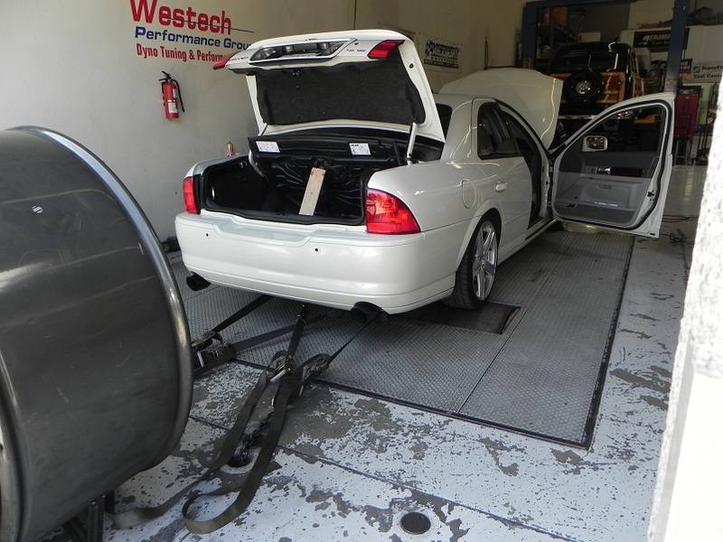

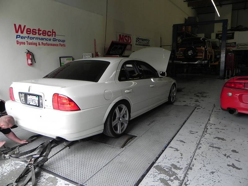

I dont know what stock rwhp is, I got 225 with a tune, 2.5'' exhaust and magnaflows. That would be a 20% loss, which normal would be 15-20 I think.
Working that back, it would be ~360 to the crank. ILLS hit 350 or so with his so I'm sure I can push it to that with a little more boost but I decided not to risk it for now.

As for the build: well done, and 300WHP should not be disappointing. I know that for some reason there was a dream of 400WHP on this, but the reality is a few pounds of boost is not magic. You probably gained ~70HP at the crank, which is 14HP/PSI...anything over 10HP/PSI is doing good! :cool:

I'll be making an exhaust and turbo vid, then I'll post up the dyno vid as well.
