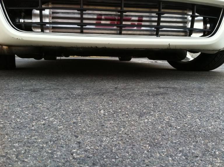

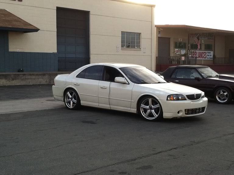

Looking good. Your bumper looks like mine on the bottom with the scrapes. Also I wish they made those intercoolers in black for a "stealth" look.
Yeah, it was mainly my dad not going slow enough when I first installed the eibachs. Well I also took out a big chunk of the bumper cause I reversed with a cinder block under neath the car when I lifted it to install the 19's, I was pissed but it wasn't noticeable unless you were under the car.
Agree on the stealth look, black looks pretty sweet. I have read of people painting them with regular paint but on most forums I read, they would say to just get it anodized instead of painting.

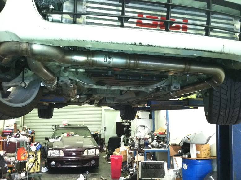

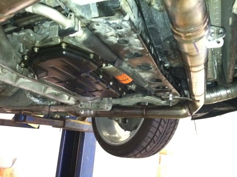

BTW, it seems like the front wheel is touching the piping in one of the pictures. It won't be a problem at a full lock?
I haven't driven it yet, I think they did over the weekend though.
Tires wont hit the pipes at full lock.

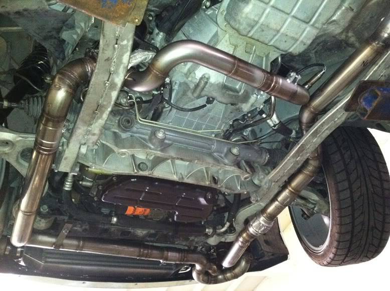

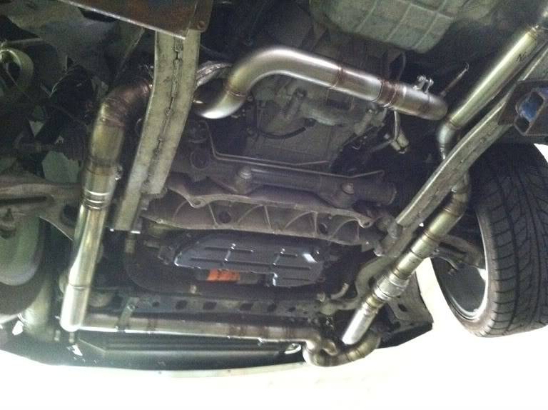

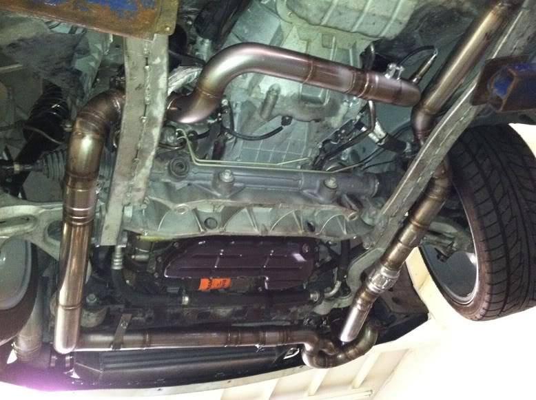

Holy Major Piping Reroute, Batman! :eek:
Curious to see how that ties in with the rest of the exhaust/piping. That looks like it was an ungodly amount of custom work.
I'm impressed with the precision of the work shown. Why was it that you didn't go remote. There's plenty of room in the rear, and the piping is significantly simplified.
