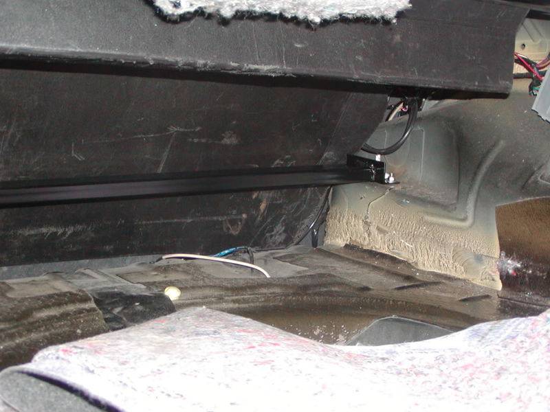

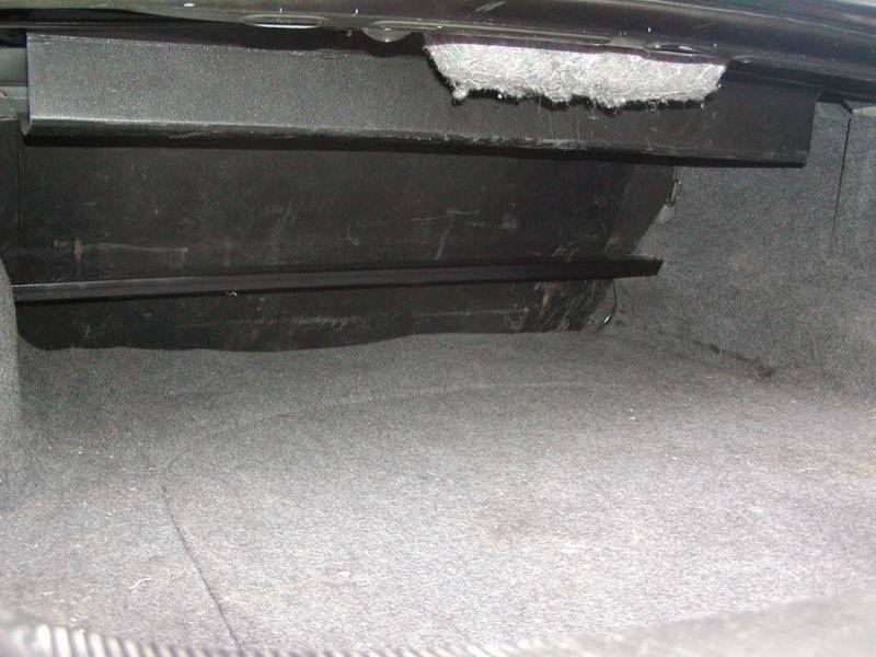

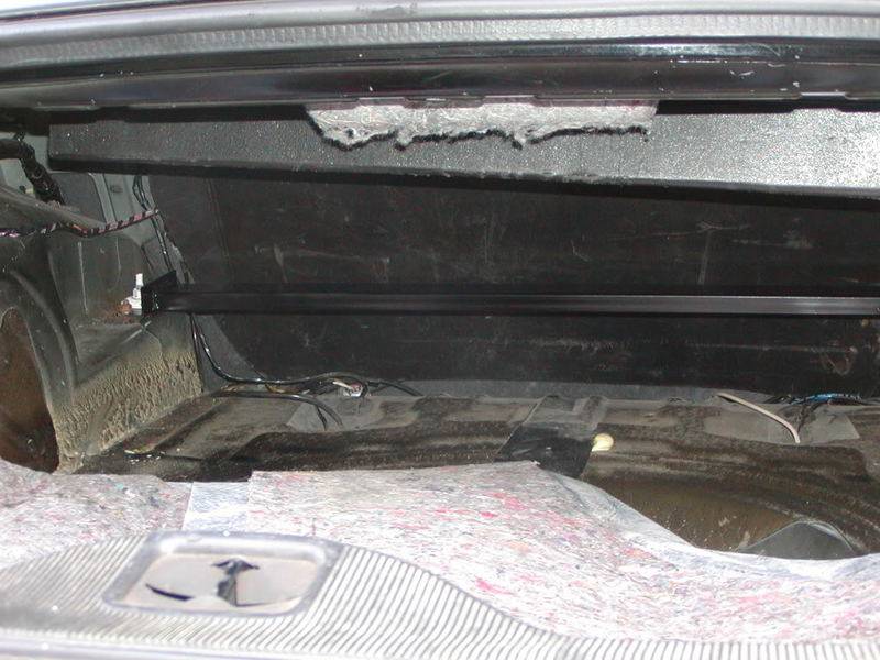

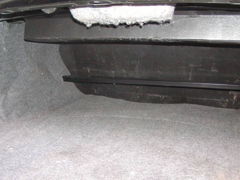

Building a rear upper shock mount brace....
clean install.
keeps the shock towers from moving. its just more bracing to keep the car from flexing.

Nice work but those angle irons are gonna flex without angle braces...but what do i know im just a fabrication specialist
How is that suppose to keep the shock towers from flexing?
I suppose it would work like a panhard rod.

any little bit helps. i would have used 1/4 inch steel and made a round flange to bolt to the shock bolts and then welded a mitered pipe to the flange, but like i said any little bit helps. looks good.

Maybe if the square stock was located higher on the angle irons and wasn't welded as well, I could see that happening, but since he's got the square stock down low, and welded good (And I know Bob, its not gonna budge)
Its easier to push over a post at the top, instead of down where it is sank in the ground, right? :)

The same way any and all rear(or front monte carlo brace) shock tower braces work.Think of TOWER as what the word says "tall" flexable unit. Now if you tie 2 towers together they now push on each other. The towers are not twisting they push in only. Its not something that the car will fall apart if not there just a nice add on.

Well, lowest point is best but not like the mark is gonna flex anyway...the shocks are dead vertical with no angles to them to push the quarter frame inwards like most cars

I thought about adding some gussets, and I might later just for grins. But really, the load is transferred across the bottom side of the bar. I don't believe that there is really a lot of load deflection going on anyway.
But what do you know, I do torque fixture (typically over 450Nm targets) fabrication as well as electronic design and repair. :)

I thought about that, but I didn't have 2" angle iron handy and I didn't want to weld up a bunch of 2" flat stock to do it. Plus, the higher height allows stuff to slide under the bar.
really this thing is pretty pointless and jsut for looks. in order for the the shock towers to flex you would have to be having some major malfunction of the inner structure of the car. there really isnt much force coming up threw those shocks. plus most unibodies use a strut brace witch is in fact way more usefull than this as all the waight of the car is transferd threw the strut towers unlike the mark viii because it has the bag or spring in some cases right under the frame rail. so all the forces of the suspension are going up the the framerail not he shock tower.
