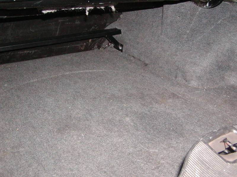

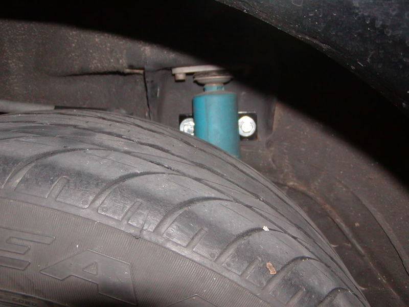

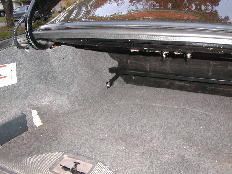

I definitely feel a difference with the front and IRS brace. The rear shock brace may by more esoteric, but I had a free afternoon and fabbed it up. I may make some changes to it this weekend so this may not be the final design.
I'd say that would be the order of install.

Okay, Rev 2. This should address any strength issues.. :)
