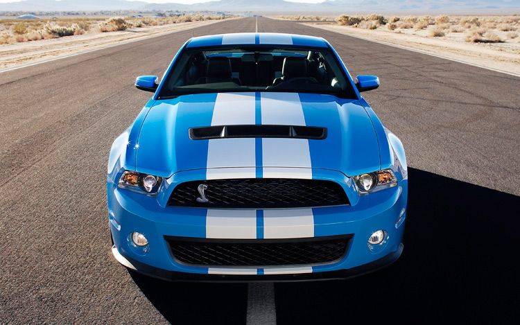

Just installed mine
Niceeee! Too bad its a photochop.. :( It does look pretty big but I dont think its that thick from front to rear. Hmmm...
wouldn't you put it near the front of the hood? not the back?
like mustangs?
Yea i probably did make it too thick lol. I was just joking obviously. And yea on the mustang it is towards the front. I thought the point was for the warm air in the back to leave as you drive forward and force air through the front grill?
I believe what they actually do is offer the air a path out just back from the radiator - reducing the high pressure the occurs in the nearly sealed engine bay. This improves the flow of air through the radiator and overall performance of the cooling system. When you look a a Ford GT - it's the design taken to extreme.
I do not believe it is actually meant to remove the engine heat from the engine bay.
those are ducts that match to the back of the rads. so the airflow comes in the grill and out the ducts, with no buffeting or high-pressure restrictions.
Its towards the front for the reason that QuikLS explained, it pulls hot air out of the engine bay by letting the air coming through the radiator go straight out the top. It would work towards the rear but not for that sole purpose, then it would just be to get hot, stagnant air out of the engine bay. That and I wanted it towards the rear because I was thinking it would be an easier install but I wont know until I get a spare hood.
