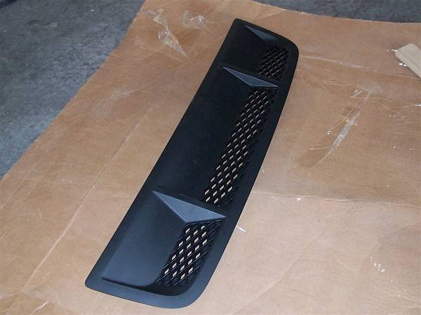

Yea I know most of you are gonna think Im retarded or something for damaging the "lines" of the LS but this car has some crazy heat soak issues and it needs some better airflow in that engine bay. So at first I wanted to do some kind of a wide cowl induction style, then I thought about just some small extractor vents on the sides, then fender vents, then a hood scoop but for the cheapness of how much the heat extractor is for the GT500 thats whats gonna go on. The TCI converter is on pause right now(broke my truck, LS = DD now) and I can cut the hood open and 3M tape this thing in, probably within a few hours. I want some opinions tho, I plan on putting it towards the windshield/rear of the hood to pull air out. I think it measures something like 32 inches so its quite wide and should work very well as opposed to nothing. QuikLS if you have any pointers on cutting open the hood please step in, I believe your the only person to have done this so far.
Oh and if you say yes to this mod, Id like an opinion on paint matched(ceramic white I think it is) or leave it flat black to go with the Mach 1 lip and factory GFX..
it is going to be very tough to fit that.
one reason it the lines of the hood - chances are the curvature will be slightly different - so matching the hood to the lip will be tough.
the other piece to remember - the LS hood is 3-ply in some spots. so you'll have to think through how to seal that up so water does not get into it. You are gonna find the the opening in the vent will not be cleared of the hood in some spots - so you'll have to figure out what to do about that.
"You are gonna find the the opening in the vent will not be cleared of the hood in some spots"
What? sorry for this dumb illustration but like V= that? V is the vent and the = is layers of the hood? So blocking it so to speak? And if it does, I can trim back on some of the other layers. The underside can look like complete crap for all I care, as long as it works. Functionality here not show stuff, all tho I do want the outside to be flush. I just cant really find any other vents that I like that are cheap. This thing costs $31.
also wanna make sure that it will clear the top of then eng, not sure on the LS but most cars dont have alot of room between the top of the eg and the hood
right -there are gonna be spots where the inner plys block the opening. not only do you have to worry about the fitting but making sure water doesn't get in.
Ill just keep some plastic wrap or duct tape in my car in case I get caught in the rain?
In all reality tho theres not much else to do in order to get heat out of the engine bay. If I fab some kind of tray or something to evacuate the rain/water away from the top of the engine its gonna cancel out a lot of the actual heat extracting purpose of the thing, dont you think?
