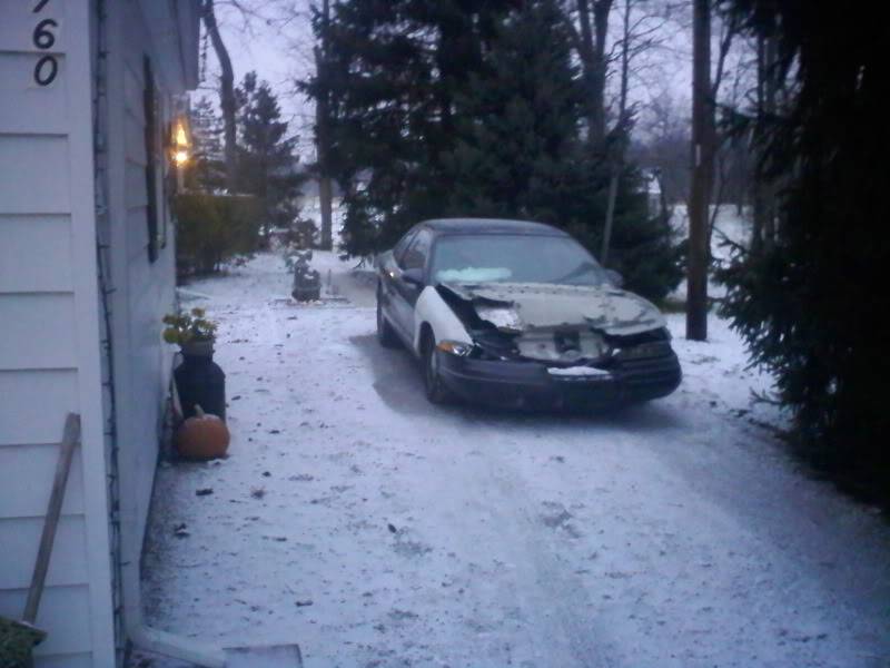

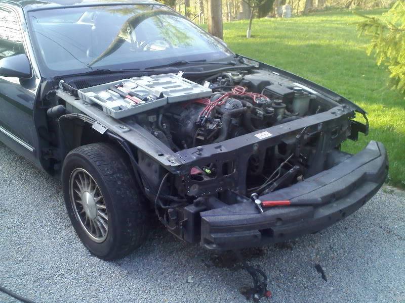

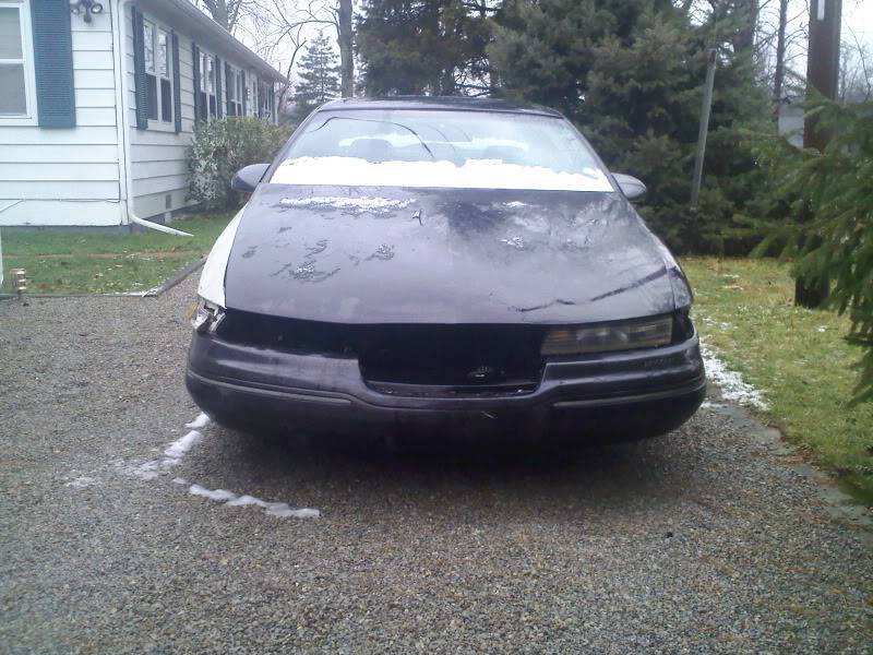

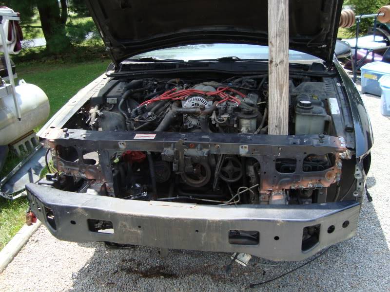

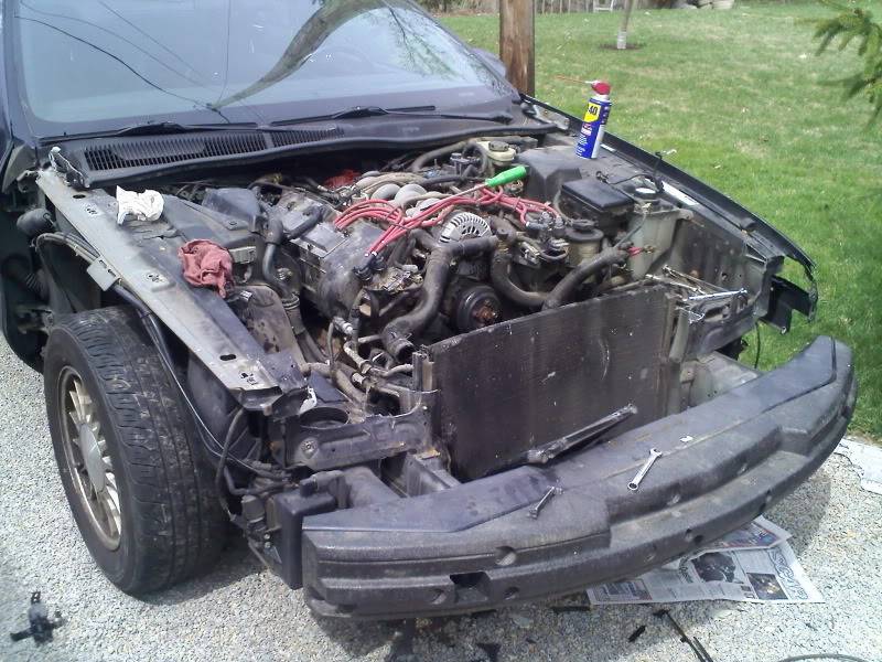

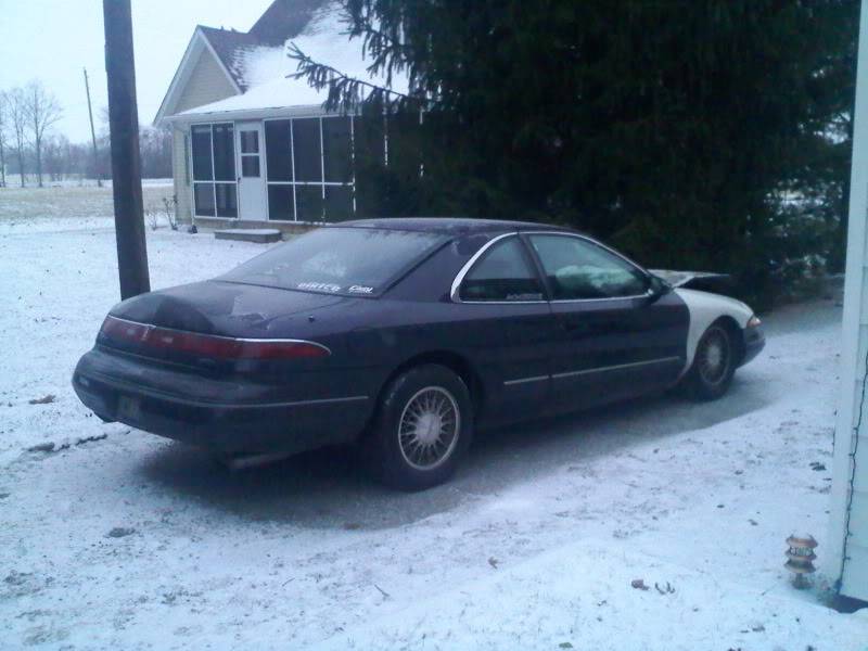

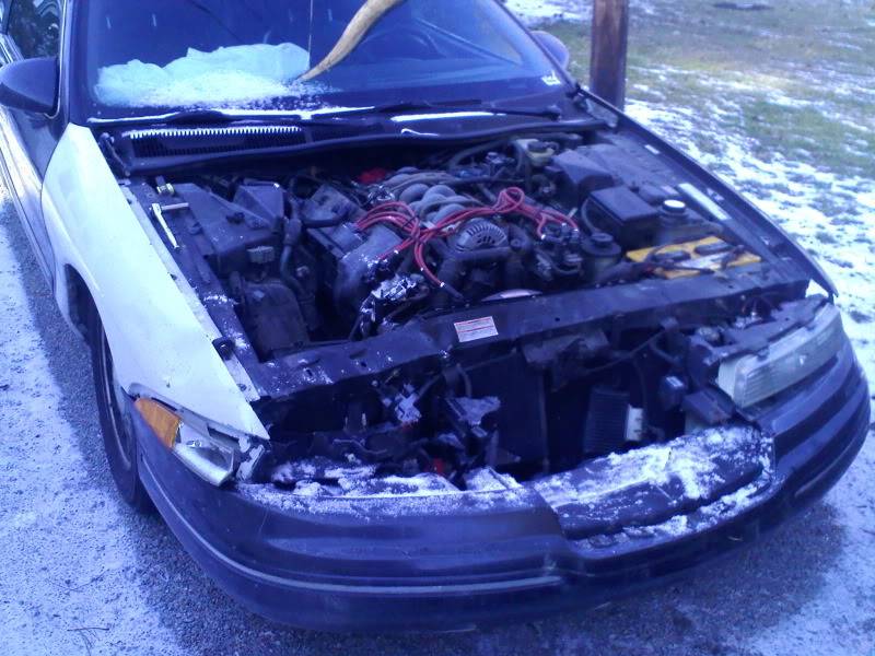

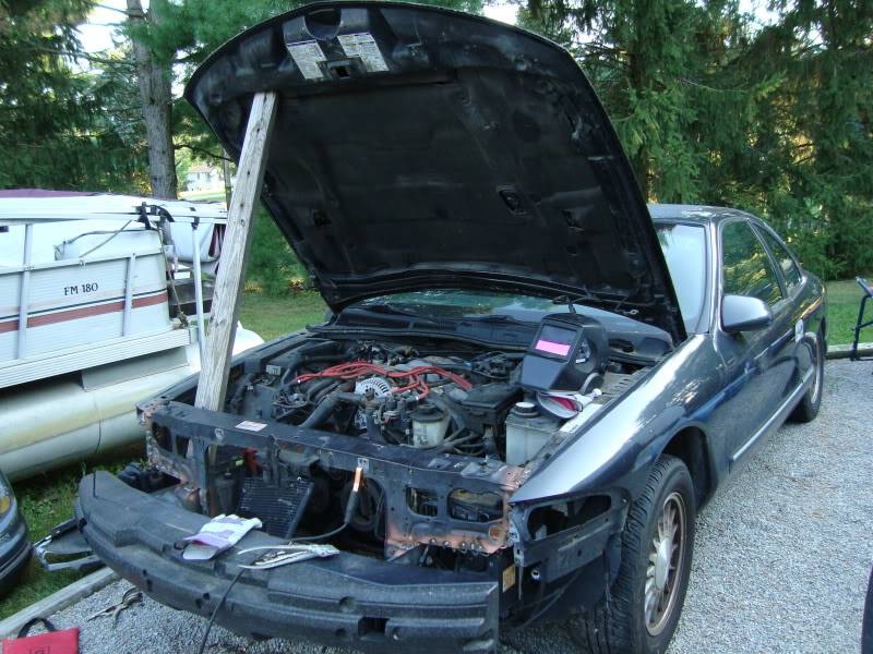

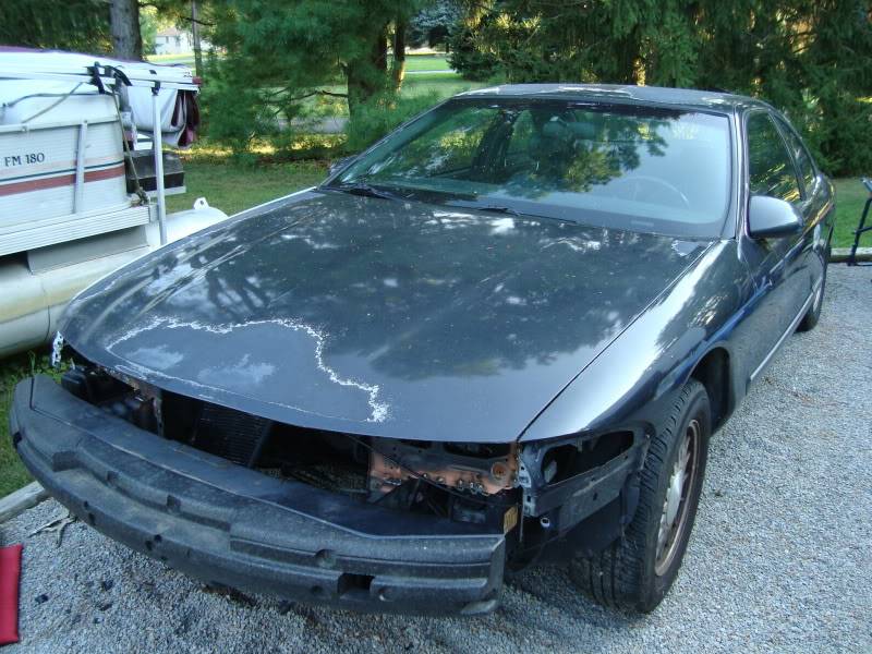

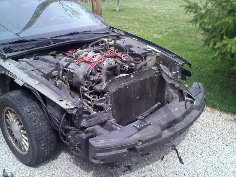

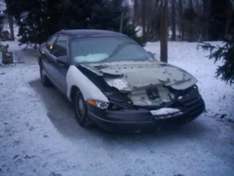

Here it was when I got it home:

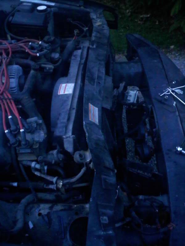

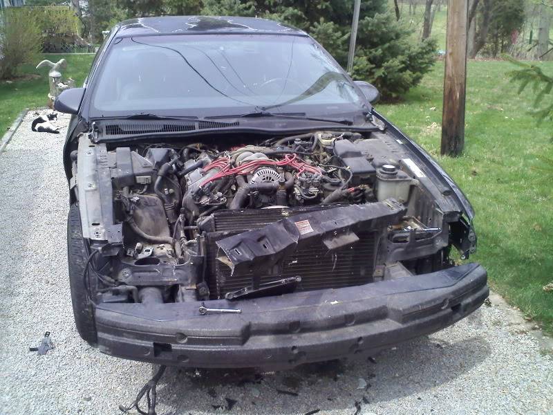

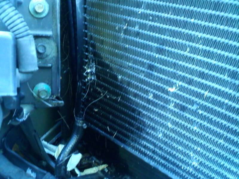

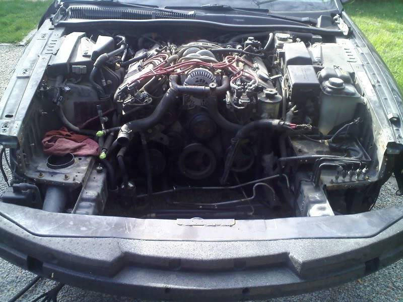

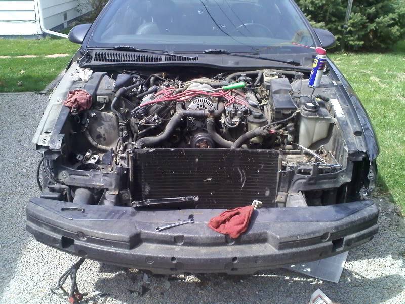

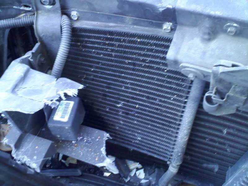

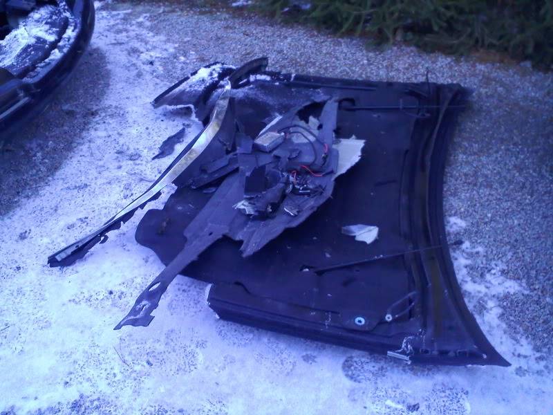

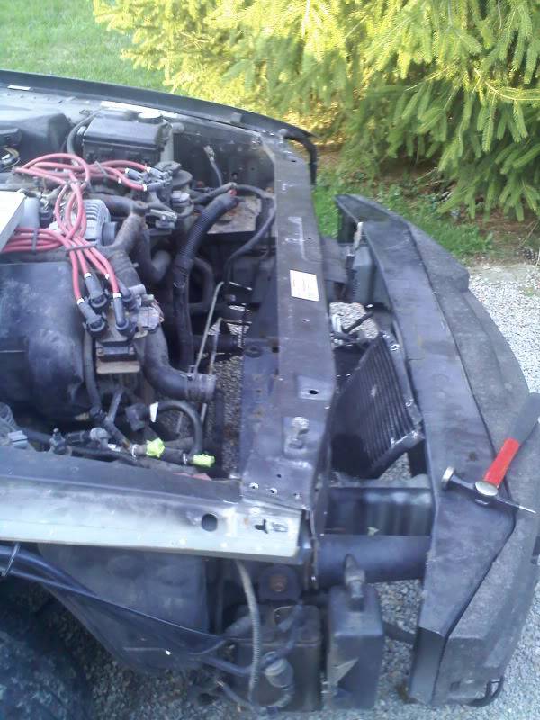

Then tore some of the carnage off of it

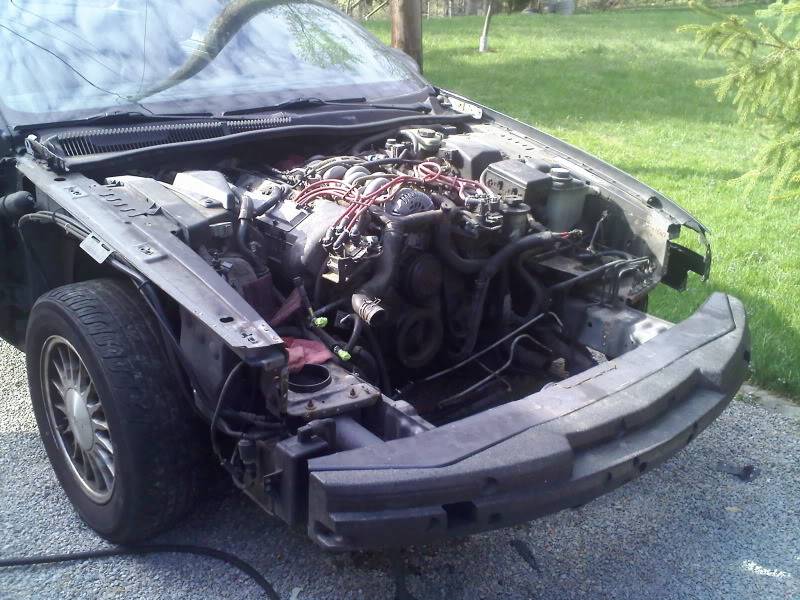

Exposing the wreck underneath...

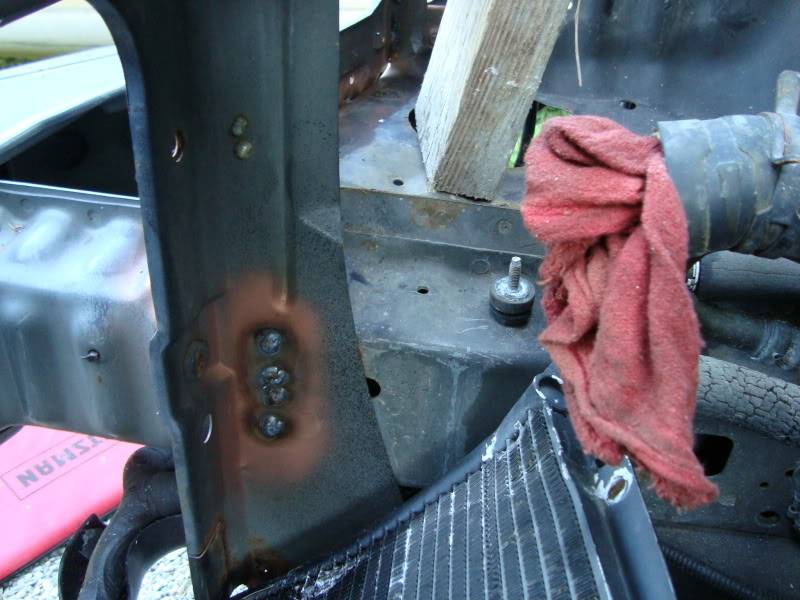

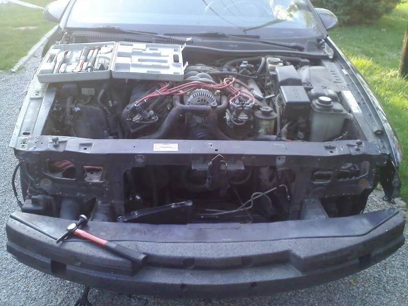

That is all too familiar to me! Hey you're going to need a core support, I have a guy that is selling me one for $50 bucks, I just need to go pick it up sometime but if I can straighten mine without replacing it, it's all yours for $50 plus shipping. PM if you're interested.

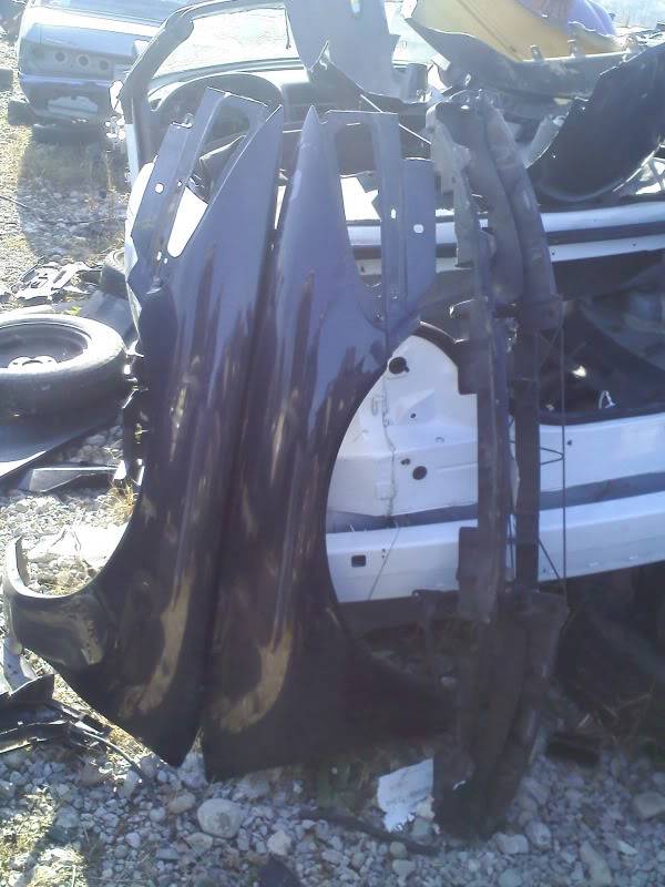

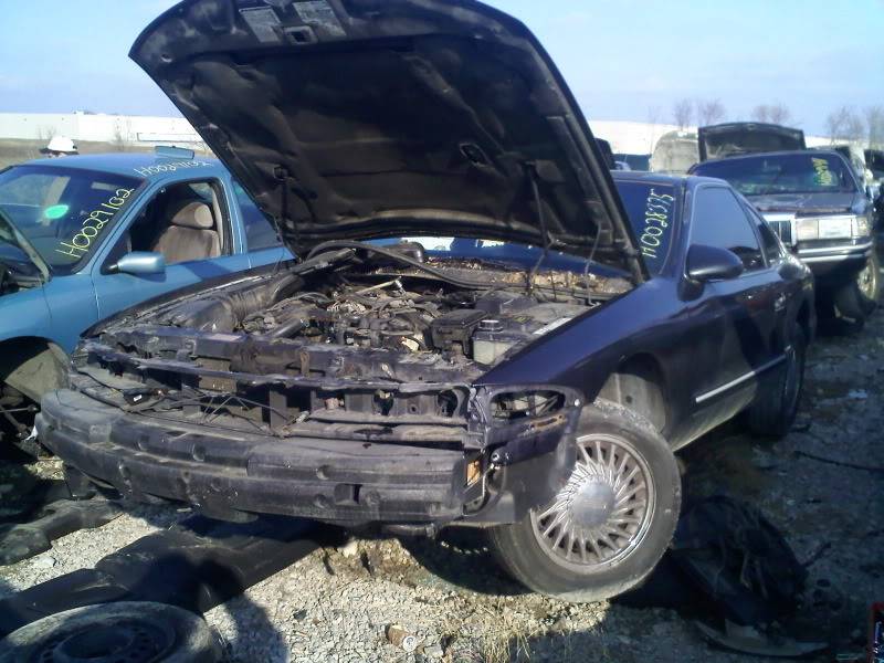

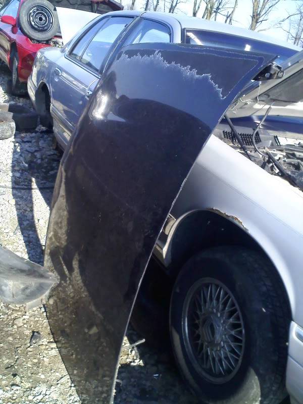

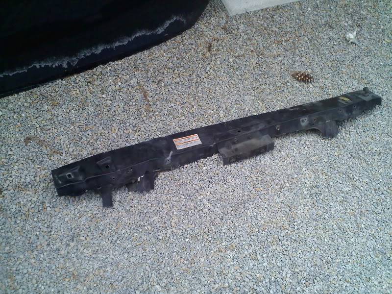

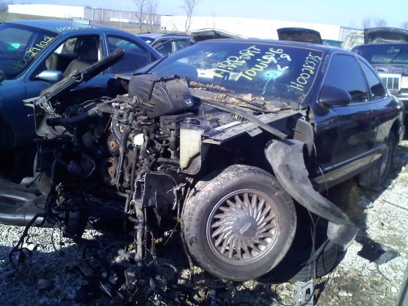

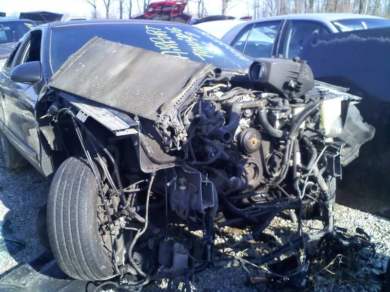

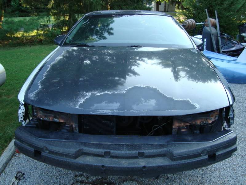

Here's pics of the car at the pull n pay that I got the front end off of...

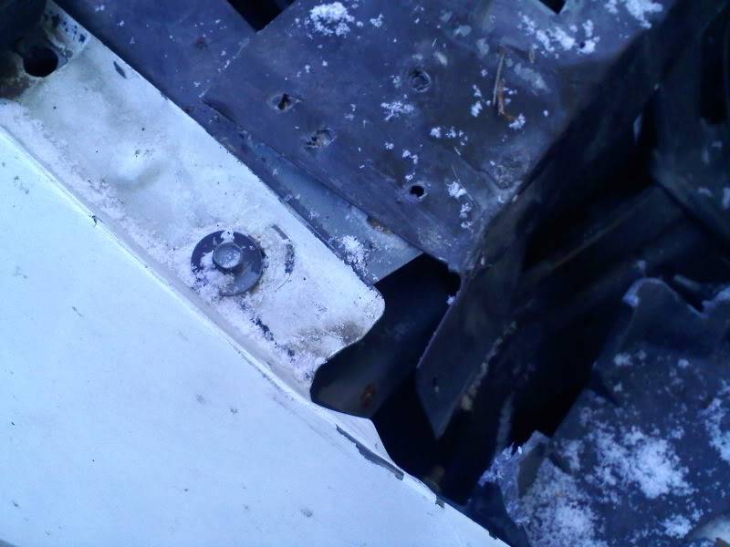

So after I got the parts I had to let it sit in the driveway like this for a little while because Ohio kept getting snow after snow... then rain, and more freakin rain... which is why my sinuses/allegeries are going nuts right now :mad:

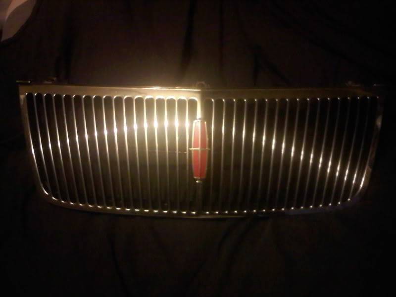

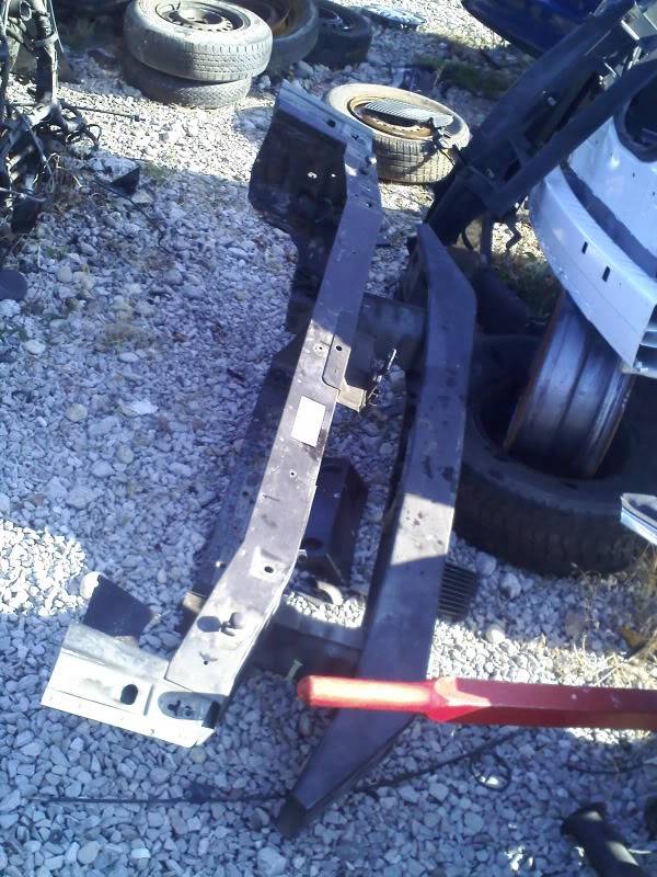

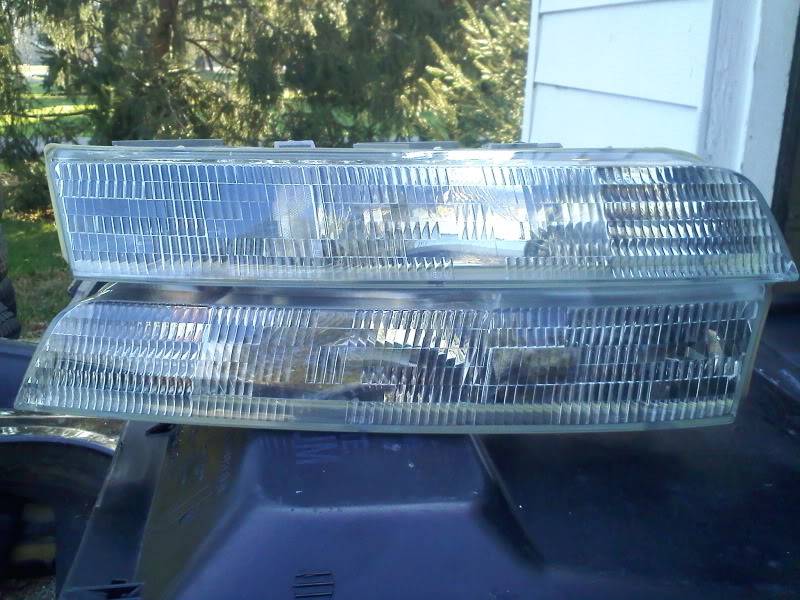

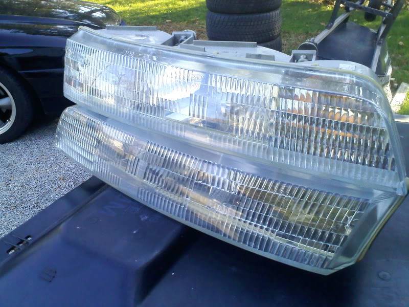

Here are a few items that I now have bubblewrapped and in my closet for safe keeping!

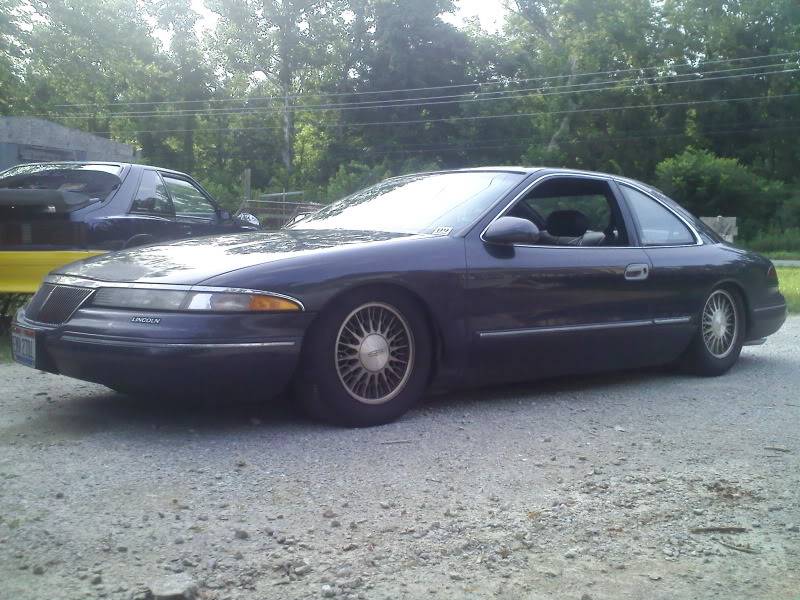

I cant wait to get it to look like this again...

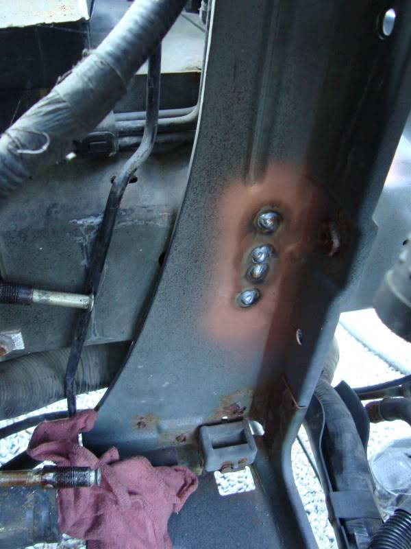

Drilling out those spot welds isn't fun. I replaced mine a few months ago and it was very tedious. On top of that, the replacement support I got had very messy spot welds (I don't know how, but they were globby). Yours certainly looks a lot cleaner than mine, lol
Just as soon as I can finish putting the new front clip on my buddy's '88 Mustang coupe I'll be able to get more dedicated to this thing!
Cutting the spot welds out is the fast part... cutting 2 sets of spot welds, then prepping them and the new panel then filling them back in is the slower part! :lol:

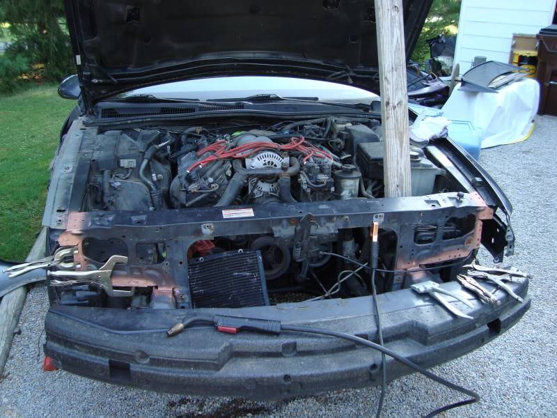

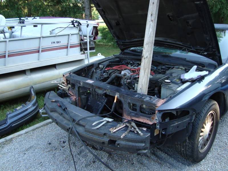

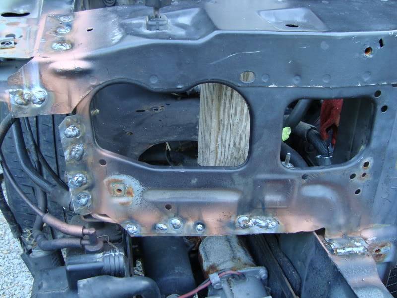

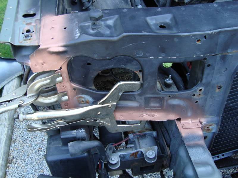

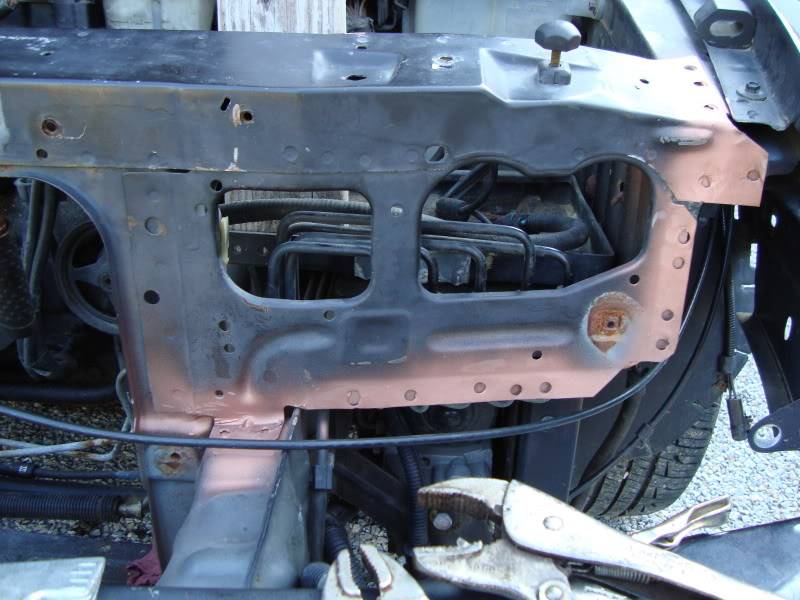

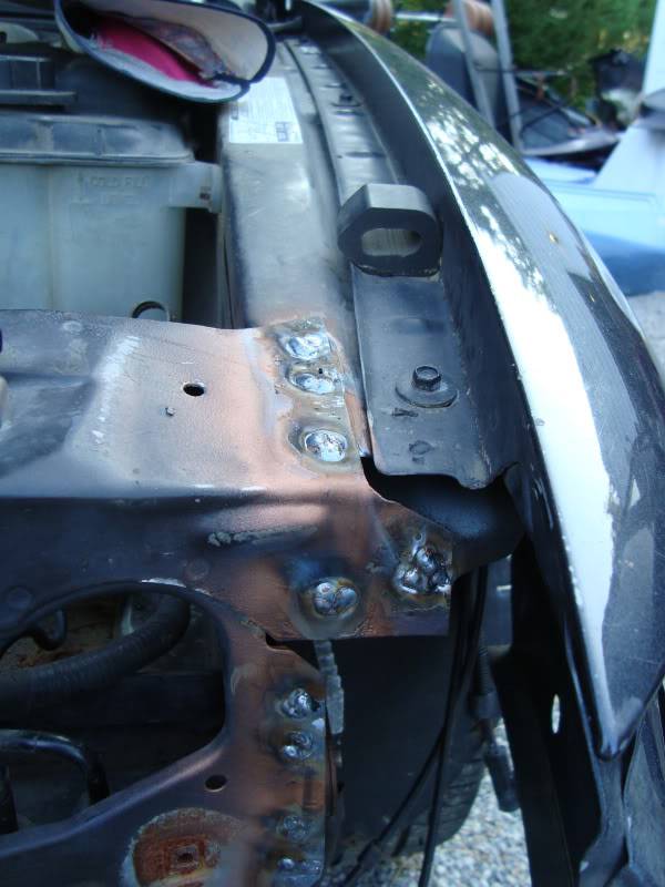

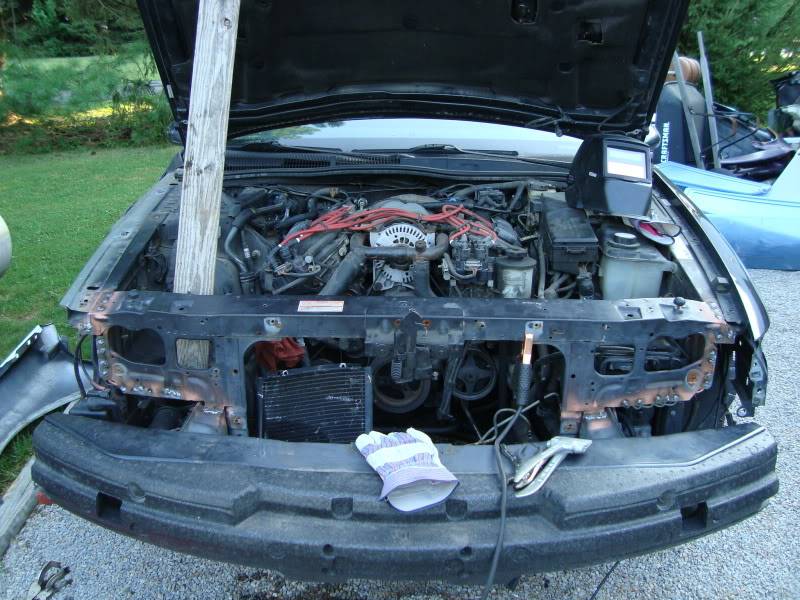

I started pretty much where I left off a few months ago before the weather got kinda crazy! The humidity hasn't been completely unbearable here the past few days so I did the final grinding on the car, panel straightening, and other clean up on the car and the core support to get the two to properly mate up. About an hour or so of hammering, grinding and a little weld thru primer on tuesday left me pretty happy with how it fit.

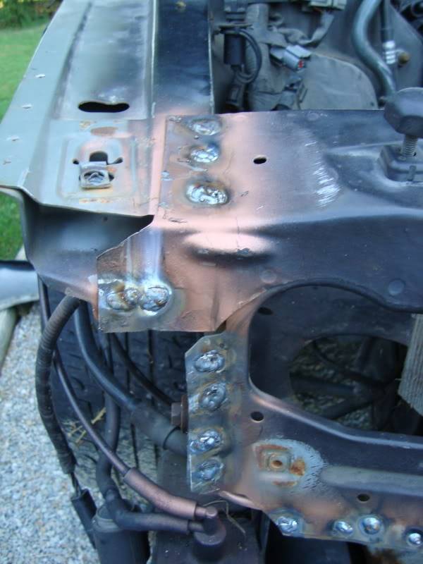

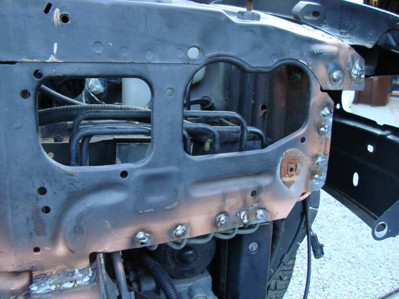

Got home from work yesterday and dragged the welder out in the driveway, along with about 6 pair of vise grips to hold everything in place and proceeded to weld it up!
Overall I'm extremely pleased with the way it turned out. Couldn't have been better I think! I once spoke with Jamie on the phone about replacing a core support in these cars, and he had said he had done a partial on one of his old cars and it turned out real nice, I was going to do the same thing until I saw that only 4 spot welds on either side of the radiator held the bottom half of the core support to the fram rails. So I have a completely new core support that is the same color as my car already! (minus the copper color for the weld thru primer)
Bolted the hood on it, and was able to shut it and open it for the first time in almost 8-ish months with the hood release in the car!!
