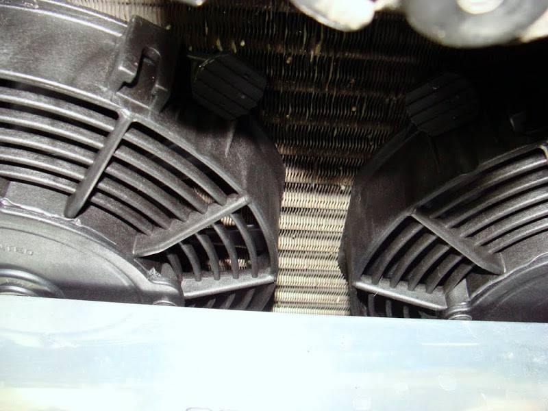

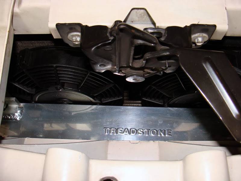

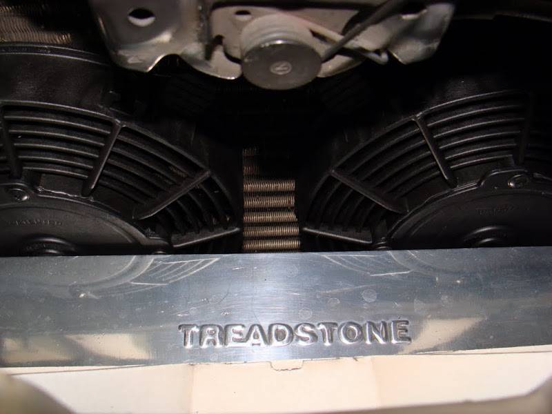

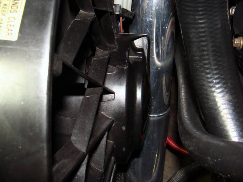

OK Here is the update (change in plans) - Aric is going leave the Mustang fan in the car as is, triggered by the VLCM. He is not going to install the HO 16" Spal fan. The 16" Spal fan will be plan "B".
He is going to install the two 7.5" Spal fans as a stand alone dedicated system, and will use the A/C system as the trigger switch. When the A/C is turned on, the two 7.5" Spal fans will turn on and run until the A/C is turned off. My SL Mercedes has a similar set-up with two pusher fans for A/C, and a viscous clutch cooling fan, and it works very well. Remember, the Mustang fan did just fine without the A/C on.
He has to move the intercooler towards the bumper a little to fit the fans where he wants them on the condenser using spacers.
He is going to swap out the 180* thermostat in the car with a 160* t-stat.
Hopefully, these changes will do the job :) If not... See plan "B"
Fan shroud

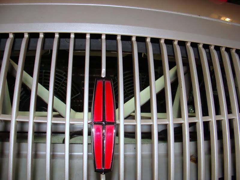

Mike, if its possible you should see if you can get a fan shroud made for the mustang fan. There are alot of exposed fins on your radiator core that the mustang fan is not pulling air through. The shroud will make sure that the air pulled by the fan will go through the entire core, not just in front of the fan.
Here it is. The car takes much longer to warm up now. I am going to switch over to Evans coolant http://www.evanscooling.com/ for extra insurance. Hopefully this will enable me to drive The Mark with the A/C on whenever I want, regardless of how hot it is outside. :)
My first time out driving the car with the new fans was to Caffeine and Octane this past Sunday morning. It is about a half hour drive from my house, and the car did not warm up completely to half way on the temp gauge. I noticed a fine layer soot on the bumper when I got out of the car, so I think Aric might need to look at the tune again.

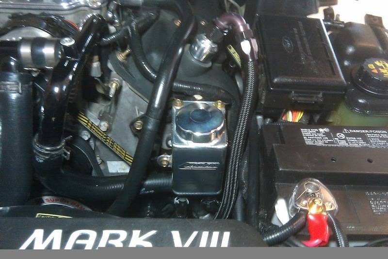

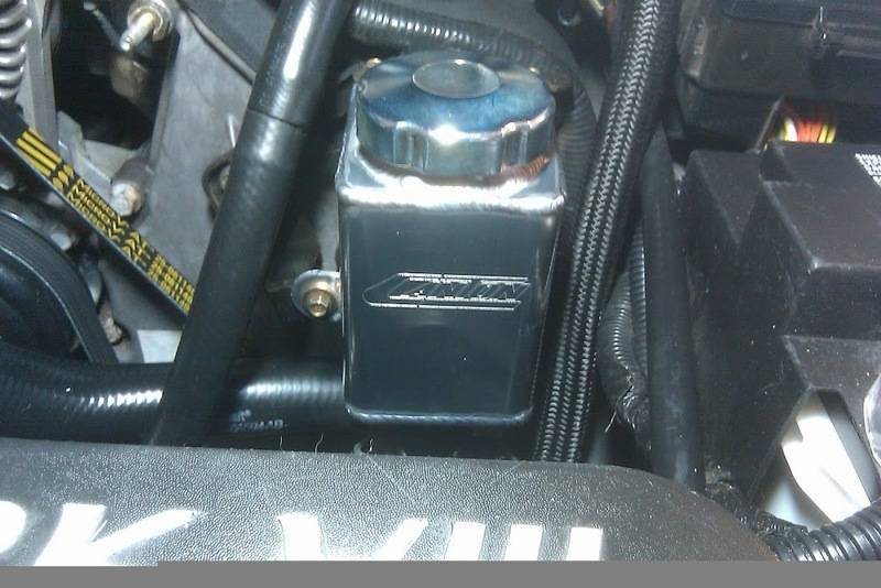

New bling for The Mark :) Aluminum power steering tank. lol I decided to install this while I am waiting for my appointment on the 22nd to install this tank, flush the coolant, and dyno tune. Took maybe 10 minutes to install, and I probably saved myself $100 in labor charges :)

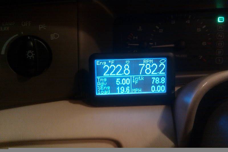

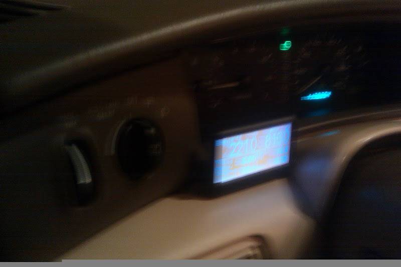

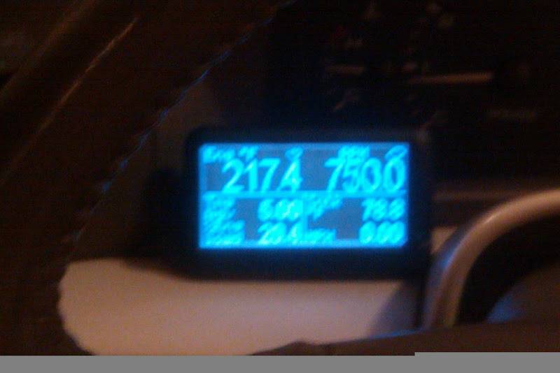

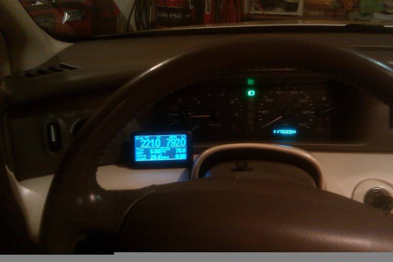

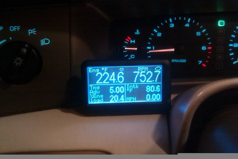

Here's some pics of the new OBD2 gauge. I need to still figure out where to hide this thing, but for now, this will have to work :)
While your IAT is better then mine while just sitting there your ECT is much higher. I really have to beat on mine in very hot weather to hit 220*, normally the car never goes above 212*.
Sorry but so far I am not very impressed with the Evans stuff. :(
The Evans coolant will run at a slightly higher temperature but technically remove more heat at higher engine loads. Plus the fact that The Mark is highly modified and will make more engine heat.
OK, I had to cancel these plans last month, as I almost went back to retired 30 year IBM employee status when IBM did not renew my now IBM contractor status Purchase Order.
Luckly, my contract was just approved, and renewed, so my hobby is back on track for at least the rest of this year! :) lol Don't tell Wendy though... I told her I was done spending money on that car! ;)

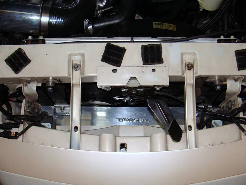

Anyway, the plan is still the same - to remove the t-stat completely, and wire the Spal push fans to trigger on when the main pull fan turns on.
I dropped the car off today, and it should be done by tomorrow.
The car seems to be predictable with the temps - with A/C on or off, stop and go, interstate speed, the temps end up in the 220-245 range when I finally park the car.
I hope these latest mods get it down 10-20 degrees.
Next on the list if it doesn't cool it down is one of John Temples custom bumpers! I hope that bumper would allow room to unstack some of the coolers in front of the radiator, and improve air flow across them. :)
lol Well, That didn't work :) Got the check coolant warning on the message center at 248 degrees just driving the car around town. It was at 250 when I parked it in the garage.
No steam or boil over. The car was running normal in fact. I did not notice anything out of the ordinary, other than the factory needle is pegged on hot at 250 degrees :eek:
It was around 79-80 degrees out today. I had the windows down, an the a/c off. I am going to wait and see what happens with John's bumper, and then decide if I am going to continue running the Evans coolant, or switch back to green coolant. I am not convinced the bumper is going to make a difference yet.
