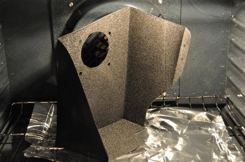

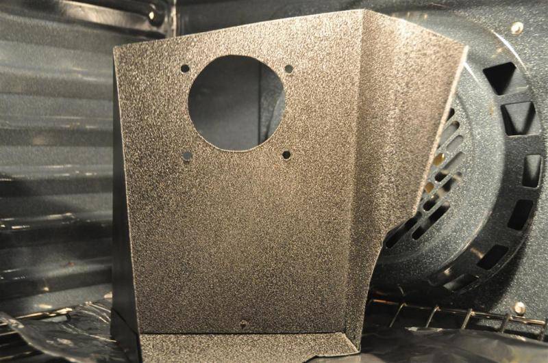

Well when I painted over the Rustoleum Satin Black, after letting it sit over night, and sprayed it the next day with Kyrlon Ultra Flat... it bubbled up in places. Sanded it down some and painted it again, same bubbling. Guess those two don't mix well! Had to let it sit another day and sand it all down. Just sprayed it with VHT Hi-Temp Black Wrinkle paint for engine parts, valve covers etc... looking good now. It's a slow dry paint needing 48 hours before reassembly it says (option is to bake it at 200 degrees, which I might consider... just don't want the oven to smell like paint). Might let it sit until Tuesday... it's hard to wait though.
LDM, prepping question. Did u wipe down the heatshield with alcohol before painting? I did and noticed it cleaned off a bit of a greasy coat from the heatshield. May have contributed to the bubbling. Primered mine about an hour and a half ago. Letting it set up til tomorrow before painting.
No I didn't use alcohol before hand, that could be why. It's been sanded now though, so it should be ok (it didn't bubble with the first coat of Rustoleum, only after the 2nd coat with Krylon).
It's been in the oven for 30 minutes at 200 degrees after painting with VHT hi-heat black wrinkle, and the black wrinkle looks perfect now!

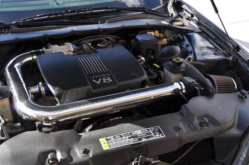

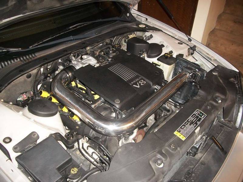

Looks very good. I have a feeling we are going to see many different, but yet tasteful paint jobs, on these heatshields. :D

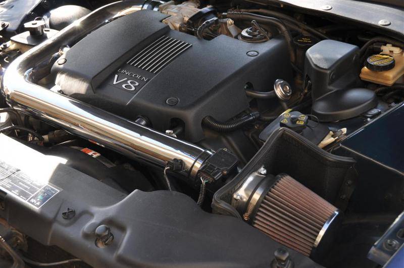

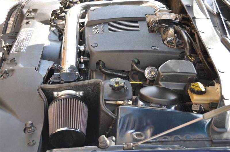

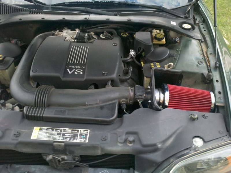

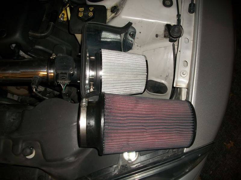

That looks great LDM. You got your intake tube first but I beat you to the install...lol. Unfortunately my K&N filter didnt fit. It's pretty long so I bought a $25 spectre for now. I'm going to ask for a new K&N from santa.

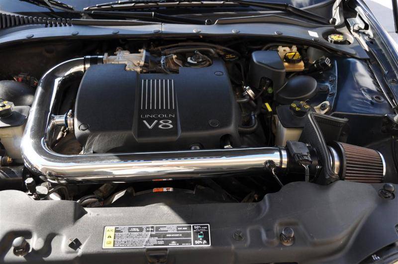

Hite337 & 01GLS, both of your heatshield installs look great! Looks like it's meant to be there. The unpainted heatshield blends in good with the new intake. I am also liking that black rubber painted heatshield install look. Just kind of disappears and blends in there. Good job guys!
lookin good boys. FYI... i dremel'd the front cover a little to make the seal fit a little better.
Install pics look great. For those of us who purchased a heatshield, we need to all remember Hite when he needs a favor or a price break from any of us and not be greedy. He really looked out for us and could have charged a lot more.

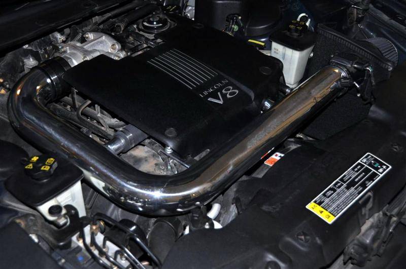

LDM that looks straight up OEM.
Thanks! I think it turned out great! (I used this VHT hi-temp wrinkle for paint, then 1 hour in the oven at 200 degrees to dry/bake).

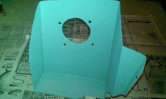

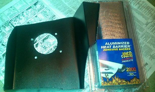

Slow progress is better than no progress(And I see the small run to the bottom left of the pic but not that pressed about it since it will never be seen once on the LS because it will be covered with heat barrier anyway). LOL.
Step 2 complete...Step 3, heat barrier application to the inner walls of the heatshield is next. Just need some time to sit down and trim it nice and neatly. Summit got it here in one day with regular UPS shipping. Kudos to them. Good thing about living in Ohio. :)

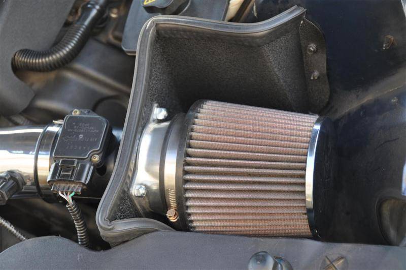

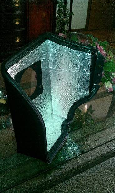

Looks good. I thought of applying a layer of something similar but thicker to just the engine side of the heatshield
Funny you mention that. I hedged back and forth before committing to the inside walls. Once I started, there was NO turning back. LOL. The adhesive on that Thermotec is stout!!! :D

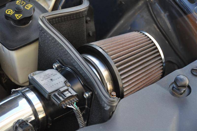

Almost done....
That looks really good Marcredd! Good job. I like that idea! Everyone's got unique and quality looking heatshield installs.

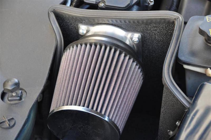

I added another gasket on the MAF adapter side, and cut and trimmed both gaskets on each side to fit the MAF and MAF adapter.
Thx LDM. It truly is going to be interesting to see the results of everyone's efforts into these. Hite has us addicted. LOL.
