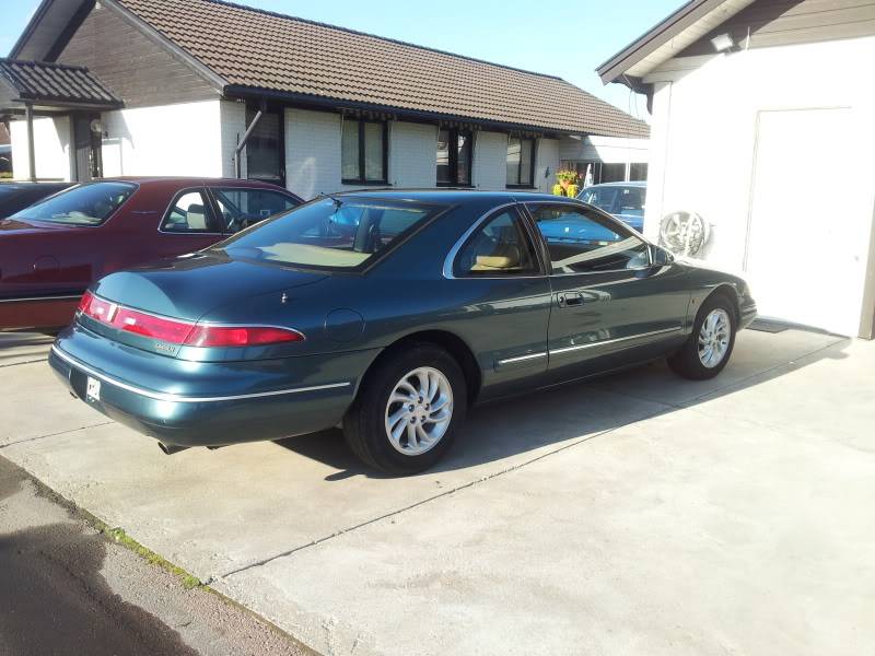

So a few days ago I finally began working on the car with installing the sound system and other minor things.
What am I going to do? I'm going to lay down sound deadening material and also install a stereo system containing of:
DLS Nordica 6.2 front speaker system driven by a DLS Ultimate A3 amp. And in the trunk there will be a JL 12w7 driven by a DLS Ultimate A6 amp.
Today I also bought a Kenwood DDX3021 headunit and got it in place.

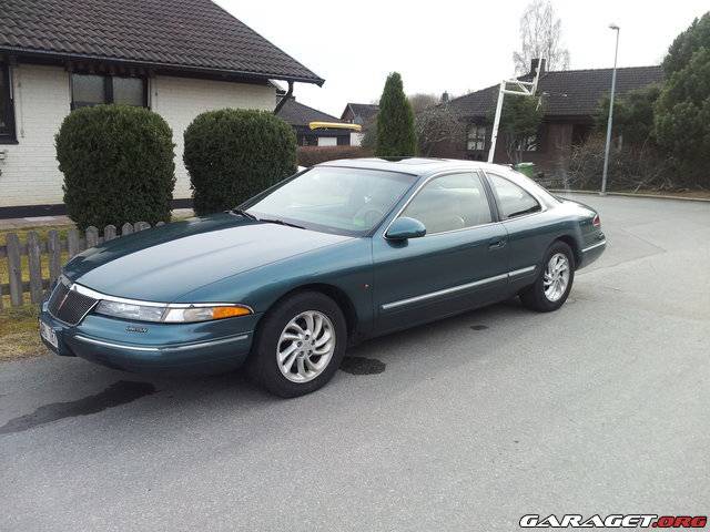

Time for some pictures, first of the car itself.

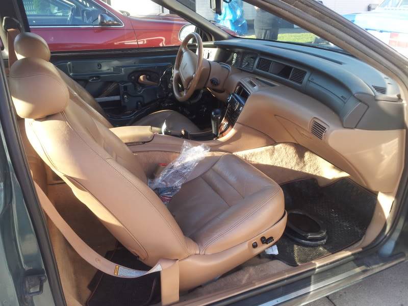

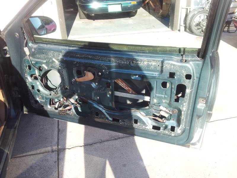

And lets tear it apart! Sorry for the crappy pics, cellphone, sold the DSLR to afford the sound system :rolleyes:

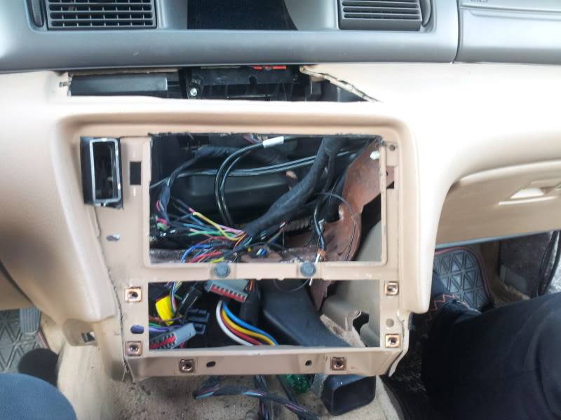

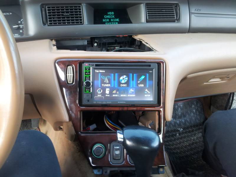

First off, try to get the headunit in!

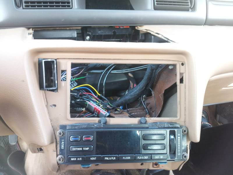

And lets cut, much better!

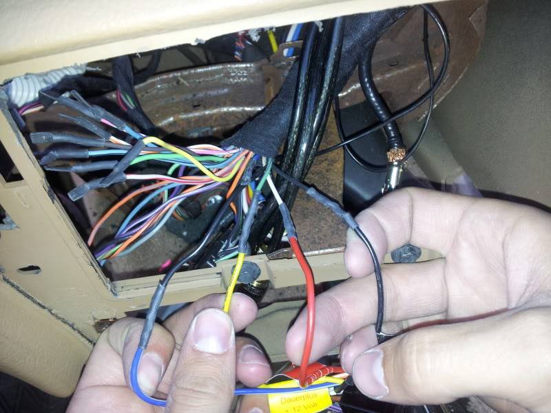

For future reference if anyone needs it, how I connected my wires.

It's pretty much flush with the console. That was just a test fit. I don't have it in the car right now because I have some other things to to so I'm waiting with mounting it permanently.

The headunit itself will not be attached by the "cage" (or what ever it's called) that comes with it because it's just way too big. It's absolutley ridicilous how big they've made it, with spacer of 1/4 inch both on top AND bottom to get the stereo itself to even fit in the cage. It's stupid how big it is. I'd have to remove all of the wood trim both above and underneath the stereo just to get that thing to fit. No way I'm doing that.
So I just grinded enough so I have to press the stereo in with force and it's weight is on a bracket that goes underneath. Gonna secure it to the bracket with some DIY methods and I'm good to roll. Best way to do it when the mounting bracket that comes with it is just stupidly big.
The wiring will all be redone except for what I showed in the last picture which is the grounding (black to the right), power wire (yellow) and the ignition wire (red, starts the stereo when ignition is on). The last one (blue/white to black, left) is my remote.
If at all possible for you and I don't see why it's not, try to ground the HU directly to the solid steel behind it, not to the harness. There is a lot of wire in that ground from the harness to the other end and the shorter the ground, the better. I never use the harness black ground at all. I ground directly behind the HU. Sand away that rust look back there in a spot and use a hole that is already back there. Put a solid copper or w/e round terminal on the end of the wire and either use a screw that's a tad bigger than the hole or a small bolt, washer and nut. Usually will eliminate any and all engine noise if it were to occur.

NoLimit95: Great advice! I will redo the grounding tomorrow then :D Thanks for the tip :)

loks like the head unit fit with minor modifications, no issues?override the park function to watch while moving?
Not a single issue with it. Took som measurements with the eye and ut the hole abit, som grinding and it's a tight and perfect sqieeze. Quite hard to get it in so thats good, wont be attacking me during hard acceleration ;) As I said, the mounting cage thingy was stupidly big so theres no way that could fit in there but this I made is hopefully rattle free :) Can't eait to get home from work and continue on the car :D
