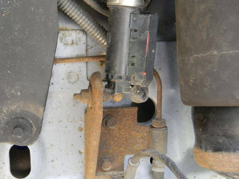

On a side note...the crescent wrench flew off the SR flat and broke the bottom off my air ride sensor, that's enough to pi$$ a person off! :( I'll never find one of those around here anywhere!

Pleas o please tell me that 19 year old 200k ball joint is going to come out easier then that! I'll worry about that sensor later.

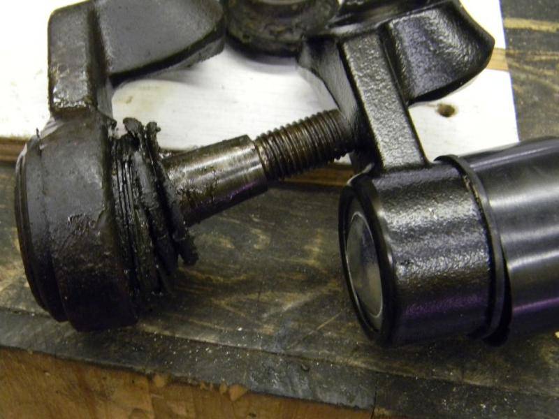

I used a ball joint fork...beating...beating...cussing, and more beating!.....holy sht! It finally fell apart!

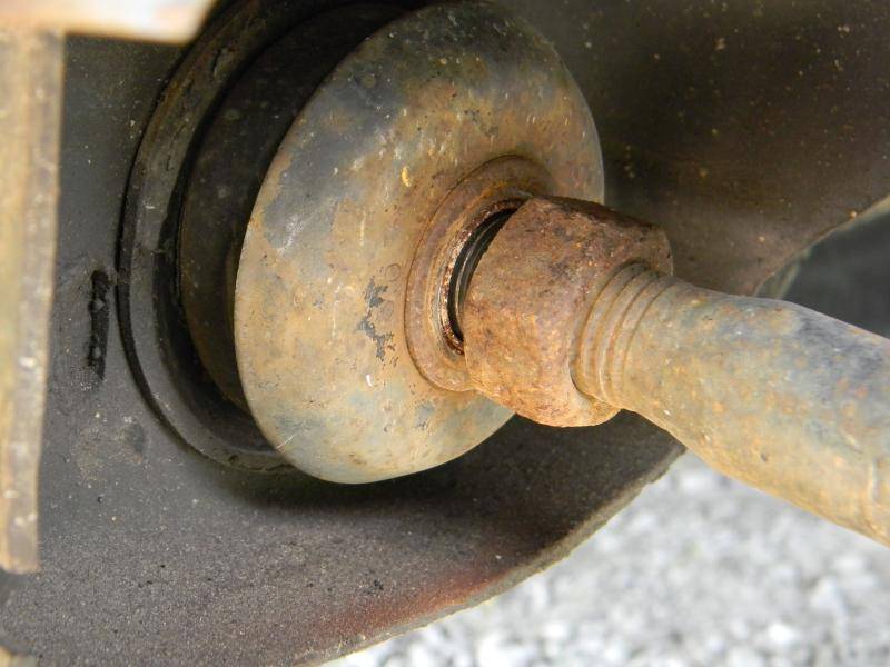

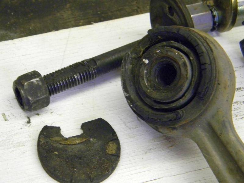

The rear (front SRB is causing me problems getting off the SR but it turn's so....it's coming off (and doesn't look good). The rear (rear SRB looks pretty good) and slid right off.
Forward SRB's are still attached to frame and don't come off by prying them! (going to have to wait till this weekend) then getting out the grinder!.

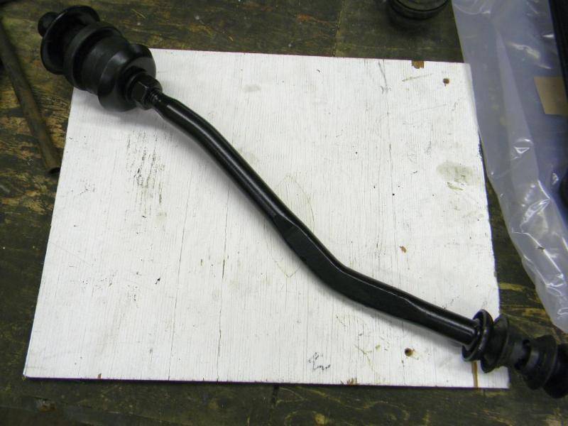

I measured the front spacer end cap at 1.125" and rear spacer end cap at 1.375" so if I would have made them out of tube at 1.250" end cap's...they would have worked perfectly and been easier to make. :) (pic's to come when I get these out).
Going to use a wire brush attached to my drill press to clean up SR threads (the thread's look real good) not sure why that 30mm nut caused me so many problem's?

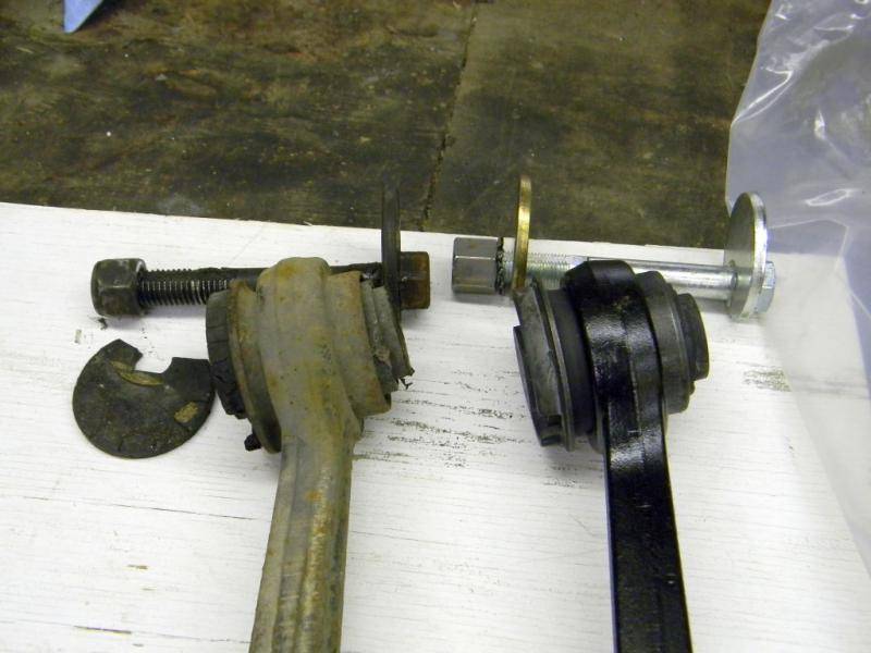

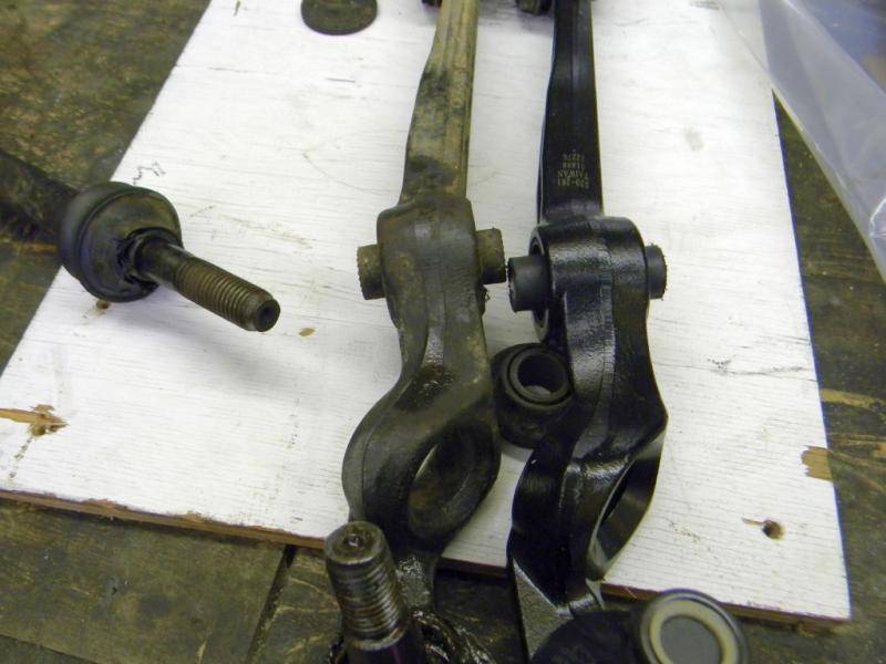

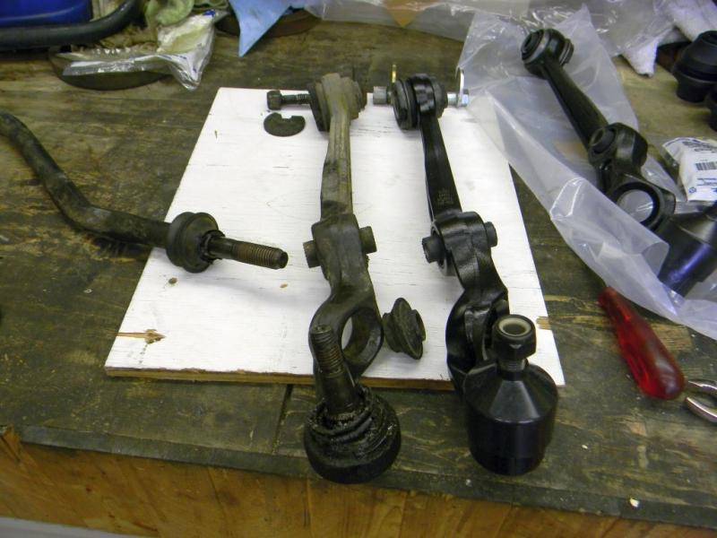

The only difference I can tell between the old LCA's and the new one's is the new one's have a bigger base where the ball joint is (I was allway's told the bigger the better) :) Everything else look's exactly the same!

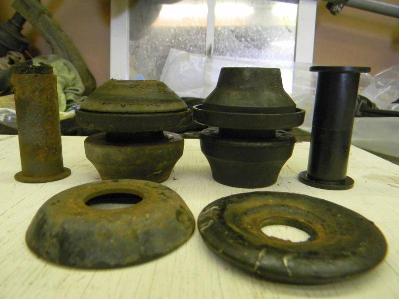

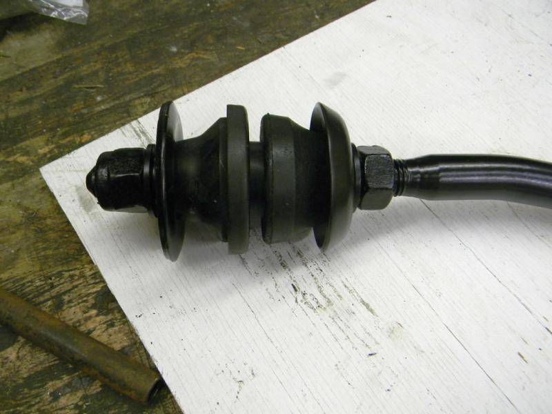

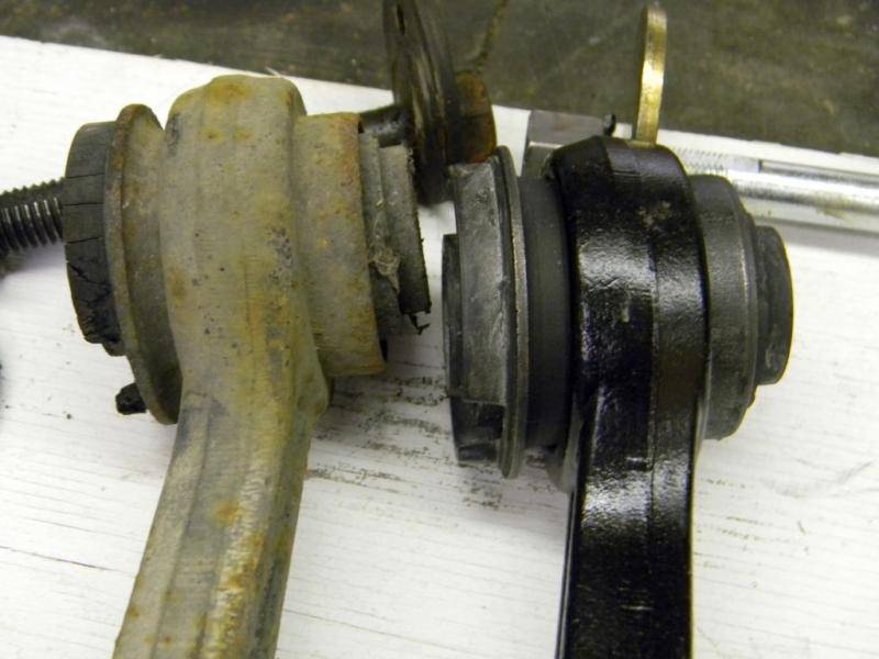

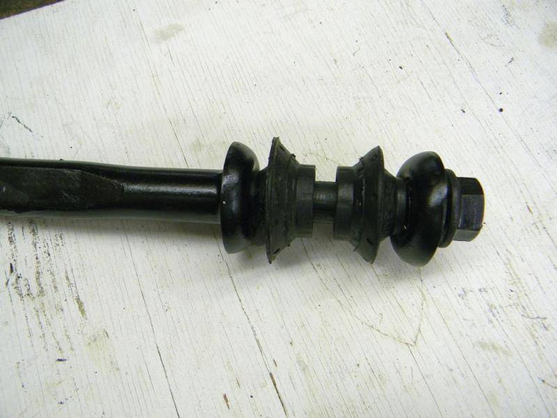

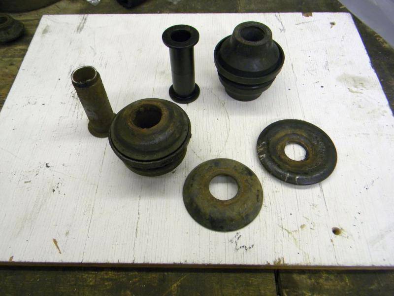

Had a minute to grind off end cap on front, forward SRB spacer. Man, that thing was messed up! (that was never coming out without grinding)! Took some pic's of new and old front STB's and spacer's. There's a big difference between the two.
Are the new bushing's different from the old one's or are they suppose to look the same?
I'm drilling front stock washer to 1" for new spacer and painting everything! (pic's to come).

That's what they look like after being compressed for so many years...

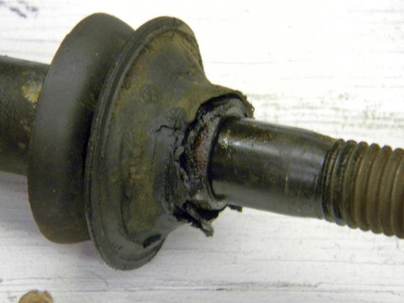

I definitely recommend that separator tool. It's so much easier than a pickle fork, and if used carefully, it won't mess up the ball joint boot if you happen to be taking apart the front end and are going to be reusing that ball joint/control arm...
That is cheap enough! I will be ordering one, but this boot looked like this before I took it off and the pass side look's the same.
