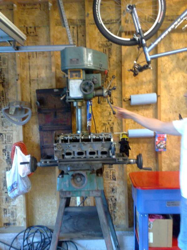

I'm about to have some fun playing with timesert in this junk head I've got. When I tear down this motor I'm timeserting all the plugs.
