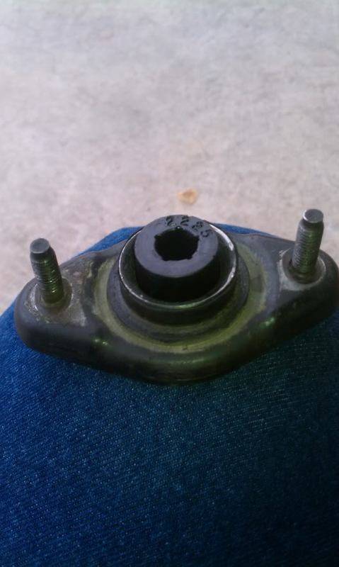

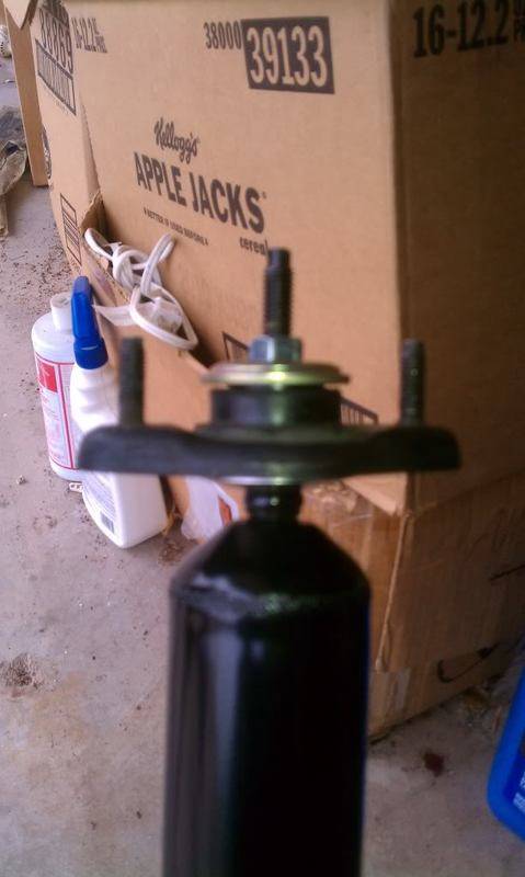

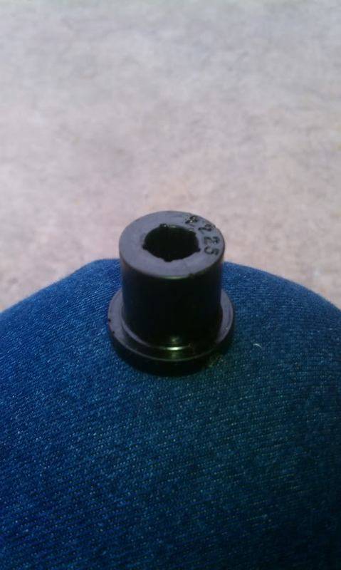

Since I did not have new shock mounts for the car I made my own and it works with the factory mount. Here are pics.
I took this... A Energy Suspension polyurethane bushing from Performance Suspension(p/n 2225).
Put it in the factory mount.
Then put it on the shock and it works
All for the low low price of $4.00 I have a working shock mount.
Now the only down side is that the lower shock bolt dose not fit in these piece of crap, f:q:q:q:q:qg Monroe shocks! I guess this is where Home Depot comes in to car work
