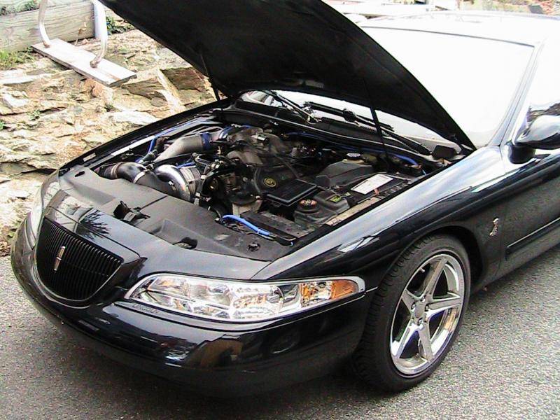

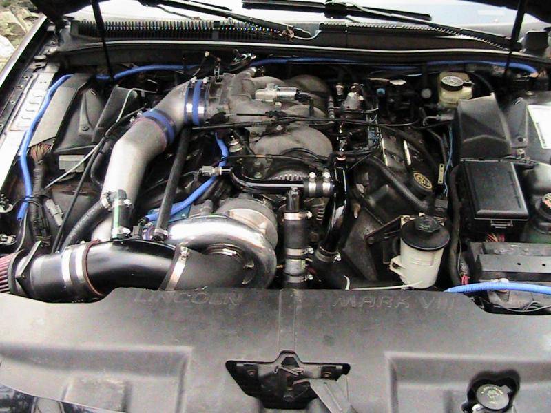

This is what I used from it:
1. Oil Feed Assembly
2. Oil Drain Assembly
3. Coolant Pipe Assembly
4. Discharge Assembly
5. Mounting Bracket Assembly (I only used the belt and Idler pulley parts and then theres like 4 or 5 other bolts that hold the bracket to the block, if you call and talk to someone you can tell them and they'lle give you the correct bolts, I don't remember exacly whch one they are).
6. Supercharger Assembly (The 3.6" pulley will put out around 6PSI)
7. The Vortech intake tube wouldn't fit between the fan and engine so I bought a 4" 45 degree tube and a 3.5" to 4" 90 degree rubber hose from intakehoses.com, then I just used a lightning MAF and KN filter. Siliconeintakes.com has some pretty good stuff too.
There is an a/c line you have to bend to get it to fit and I still had to trim the fan shroud alittle and mount it down about an inch lower to get it to fit in there.
8. Ford Racing 42lb Injectors
9. 255lph fuel pump form SCP
