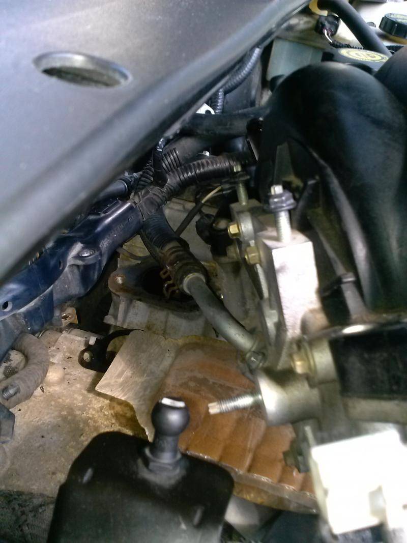

  13. SoulSoak
    SoulSoak Dedicated LVC Member
    Messages:
    566
    Likes Received:
    66
    Joined:
    Jun 1, 2013
    Location:
    Holland
  14. joegr
    joegr Dedicated LVC Member
    Messages:
    18,154
    Likes Received:
    2665
    Joined:
    Dec 10, 2005
    Location:
    Gulfport
    "My manifold is free aside from this pipe on the back. I can't seem to get the hose clamp off to get it free, do I unbolt the metal hose from the back of the intake manifold or what?"
    I disconnected that vacuum line at the other end (the check valve for the brake booster) on one of mine. On the other it came off easy enough from the metal tube.
    Just be careful with the check valve to not break it. Twist the hose to break it loose.

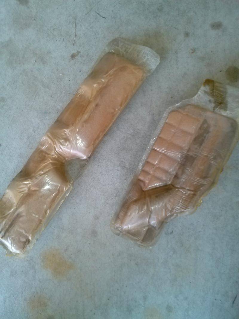

  16. SoulSoak
    Messages:
    566
    Likes Received:
    66
    Joined:
    Jun 1, 2013
    Location:
    Holland
    Nessescary for reuse? And/or what's the purpose of these?

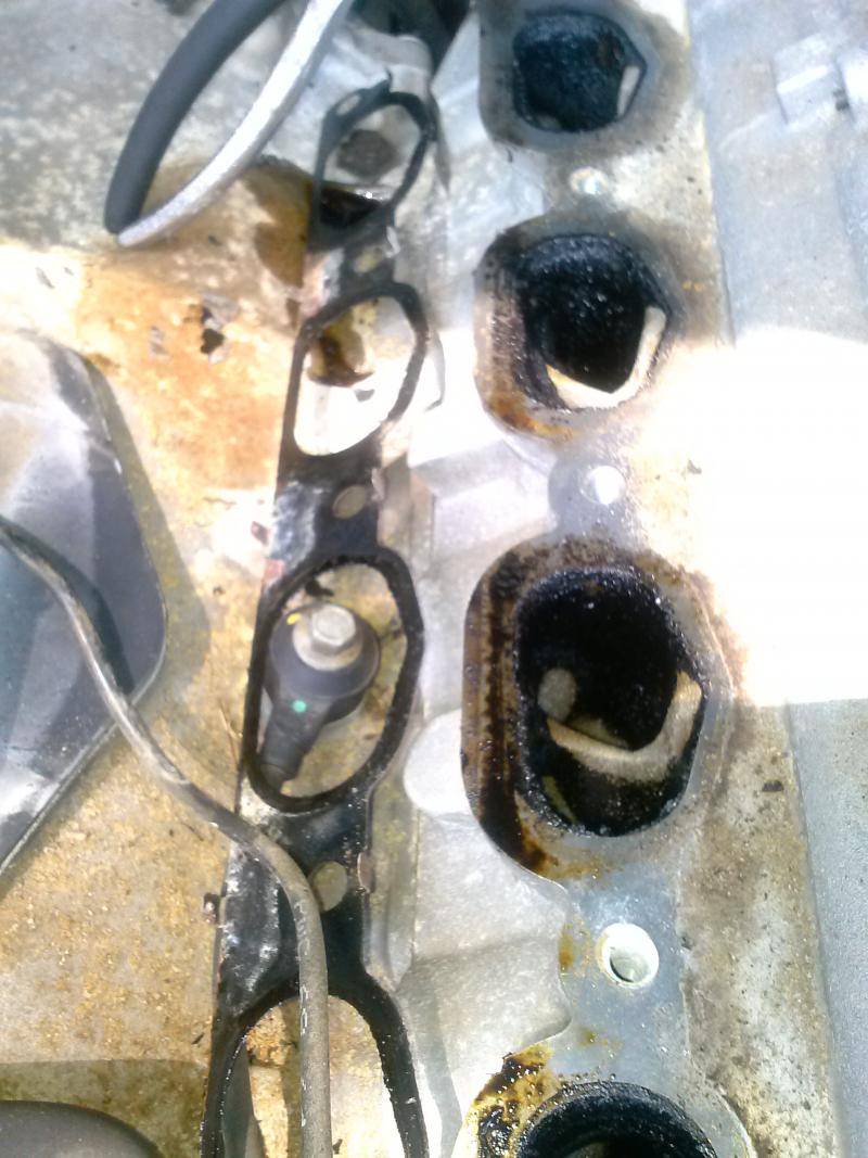

  17. SoulSoak
    Messages:
    566
    Likes Received:
    66
    Joined:
    Jun 1, 2013
    Location:
    Holland
    Also, is this oil/carbon build up normal? And do you recommend cleaning these ports with a certain carb cleaner or something before reassembling?
  18. joegr
    Messages:
    18,154
    Likes Received:
    2665
    Joined:
    Dec 10, 2005
    Location:
    Gulfport
    I think so. I only had one under my 04, and thought that it looked like there should be two.
    Insulation, I think. Noise and/or heat.
  19. joegr
    Messages:
    18,154
    Likes Received:
    2665
    Joined:
    Dec 10, 2005
    Location:
    Gulfport
    It has been for me. It's oil from the PCV system. You'll find a pretty good puddle of it in the bottom of the intake manifold too. I consider it okay since I have no noticeable oil consumption (no need to add between oil changes).
    I used a vacuum to suck out anything that I could that had fell into the intake ports when I removed the manifold. Then I stuffed paper towels into the ports so that nothing else would fall in. I cleaned the mating surfaces for the gaskets, but I didn't clean down in the ports.

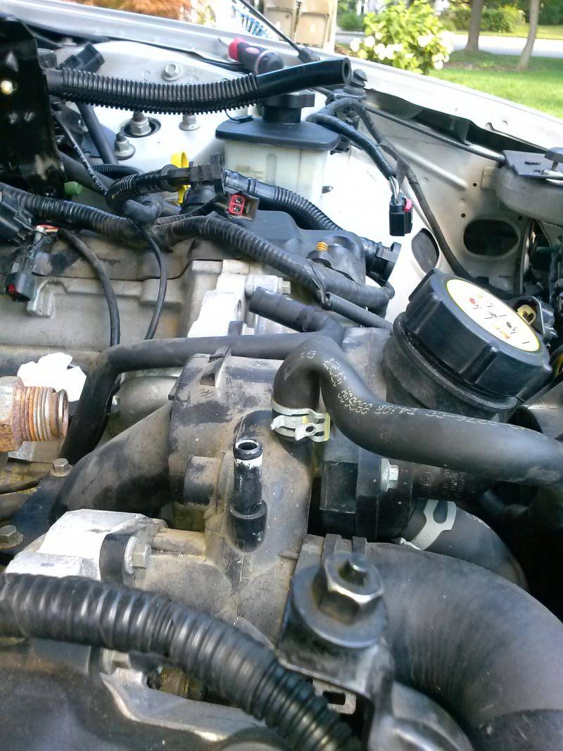

  21. SoulSoak
    Messages:
    566
    Likes Received:
    66
    Joined:
    Jun 1, 2013
    Location:
    Holland
    Just noticed this hose looks pinched quite bad, it runs to the Degas Tank. will this affect performance? If so, I'lhose.t cut a couple inches off the hose.and reattach it via the hose clamp because I didn't order this house
  22. joegr
    Messages:
    18,154
    Likes Received:
    2665
    Joined:
    Dec 10, 2005
    Location:
    Gulfport
    That's the engine air bleed hose (it automatically bleeds air into the degas bottle). It's not completely pinched off, so it's probably okay. I think that it's long enough to cut that part of it out, and that is what I would do. In the worst case, you can probably buy a long enough piece of generic hose to replace it. I don't recall it having any tight bends anywhere that would have to be molded.
