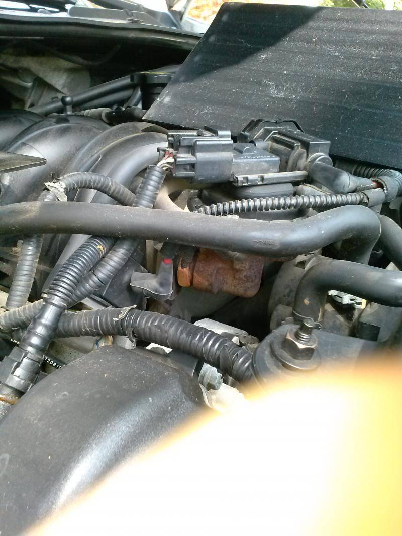

    Can someone identify this part for me? it's connected to the metal structure directly in front of the intake manifold. This part is very rusty and looks terrible, it has a metal line that runs from it down under the intake manifold. It also has wiring harness clipped to the top of it. If it's cheap to replace I may just add it to my parts list because I'm ordering everything today. Thanks

    Looks like the bottom of the EGR valve....

    That's the EGR valve. It's not cheap. It's normal to have the iron part of it rust, just like the exhaust manifolds. (Just like them, it has hot exhaust gases going through it.) I promise that the rusty part won't be what fails.
    Now, that you've found it, you will need to disconnect that exhaust tube screwed into it to be able to replace the 9N499 part.
    You can remove the throttle body and loosen the intake manifold, or you can leave the throttle body on the intake and take the intake off. Either way, you have to disconnect that exhaust tube. BTW, you'll also need the tool to disconnect the fuel line at the fuel rail.

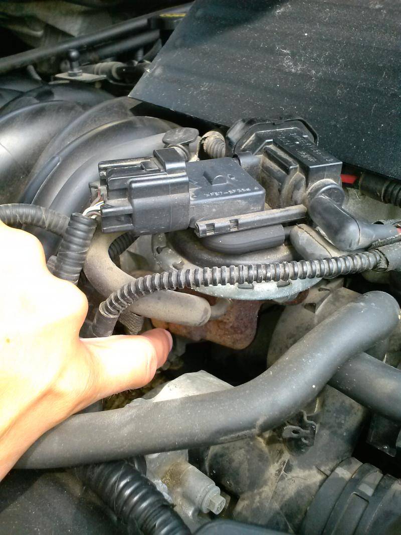

    Thanks Joe, couple questions though.
    1: I'm assuming by "exhaust tube", you're referring to the metal tube approx. 3\4" diameter and looks to be of brass, running downward underneath the intake manifold correct? And if this is correct, do I just use a crescent wrench and loosen it until it's free?

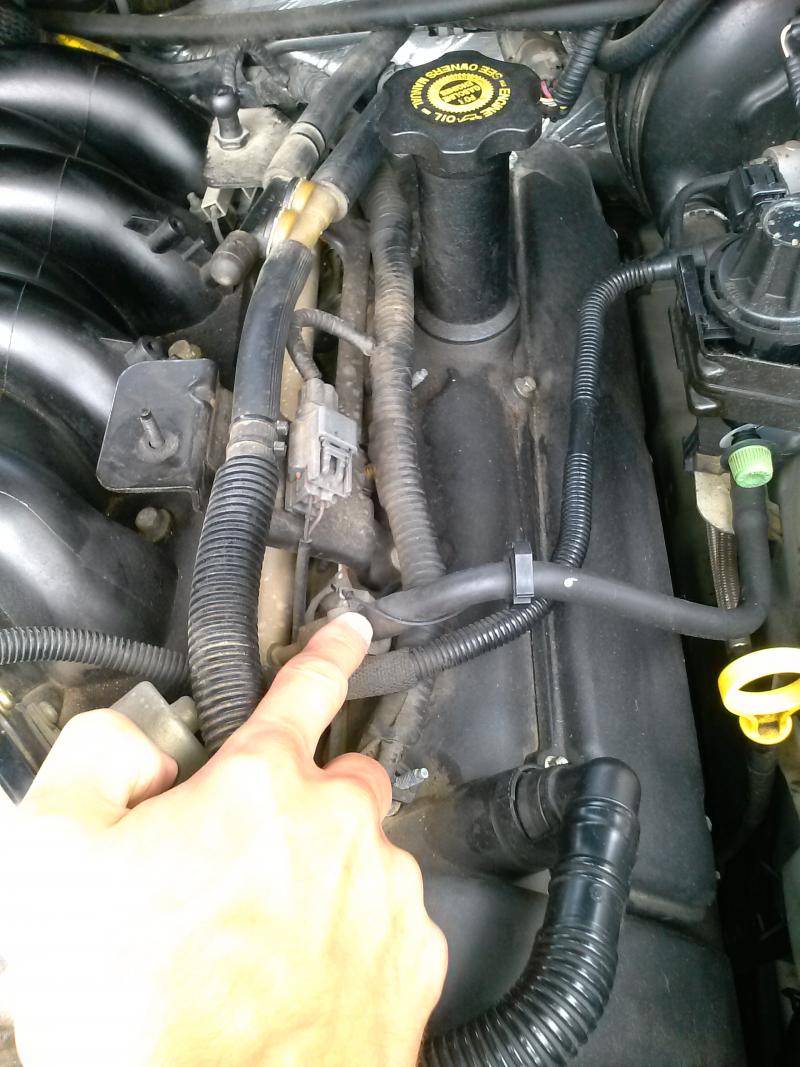

    2: Is this line I'm pointing to in the picture below the fuel line? And if so, is the special tool I need to disconnect it something I can rent from AutoZone? Also, any specific tips or comments pertaining to disconnecting the fuel line that I should know before doing so? Thanks again.

    1. Yes, that line. You're wrench will have to be narrow to fit in there. You may want to remove the fuel pressure sensor to avoid the chance of hitting it with the wrench handle and breaking it.
    2. Yes, that's the disconnect. There's no need to rent the tool. It should be less then $5, or for less than $15 you can get a good set that includes all the other sizes that you might need one day.

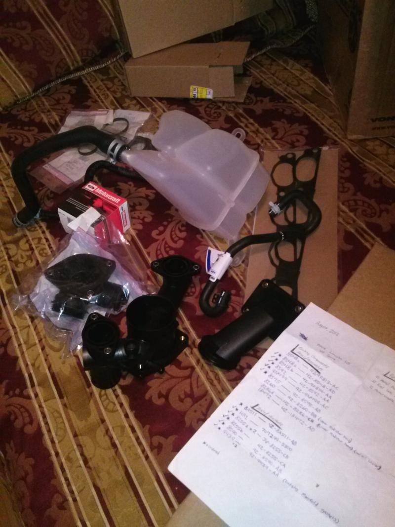

    Alright.. I got my parts on the way. $414 worth, damn who would of thought rubber and plastic would be so expensive lol. And I didn't even order everything on my list, that would have ran me almost $700!!
    Regardless, I'm excited to do some surgery. I will update later, parts will be a week.

    Ohhh yeahhh... Coolant system overhaul here we go!!! Now I just gotta find some time. Once I do, and get this done, I'll update. God bless
