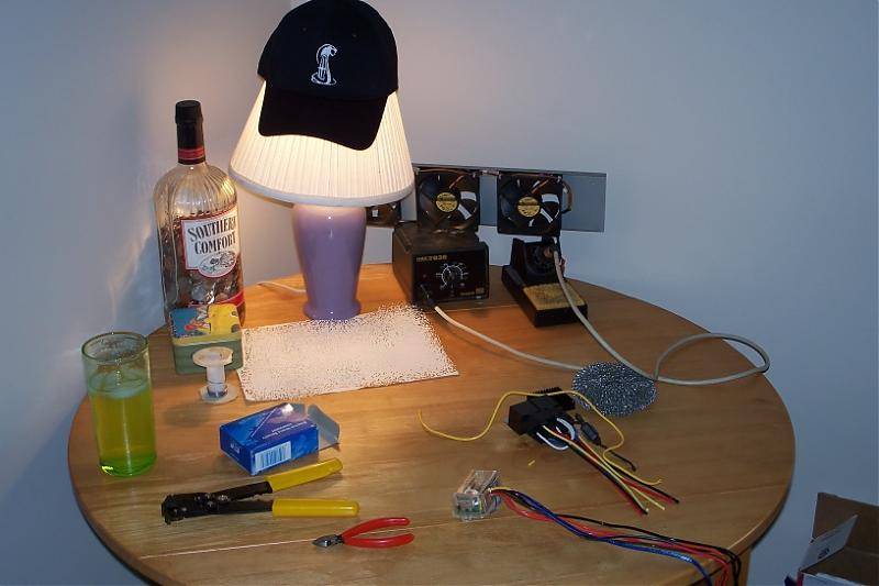

I told you guys, I'd get started on them again, so here is the proof! I dug everything out and got all setup again.
Alright guys
Those of you that have ordered but have not yet received your switch, they're done and will be shipping within the next two days. I will try and get them shipped tomorrow but it might be Tuesday. Sorry this took so long but I haven't had much for a free moment in months. I spent the better part of yesterday and a little time today getting them finished.
Thanks to all who ordered, you can yell at me later for take so long!
Adam
