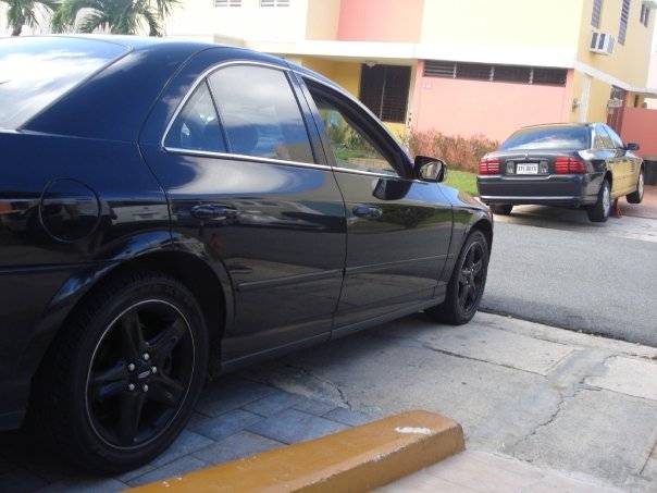

Looks sick. Definitely gonna do that with my wheels. Never saw an answer but what did you do to achieve the polished lip?
i just taped it off. the lip is the stock silver color.

WTF? lol did you paint those yourself? That looks sick on the black LS
is that LS across the street on an incline and on one jackstand?!
haha yea that doesnt look like a good idea. hope nobody get under that thing
Thats fonsito's LS across the street.
madmaxpr has fonsito's old wheels.
They still look hot :D

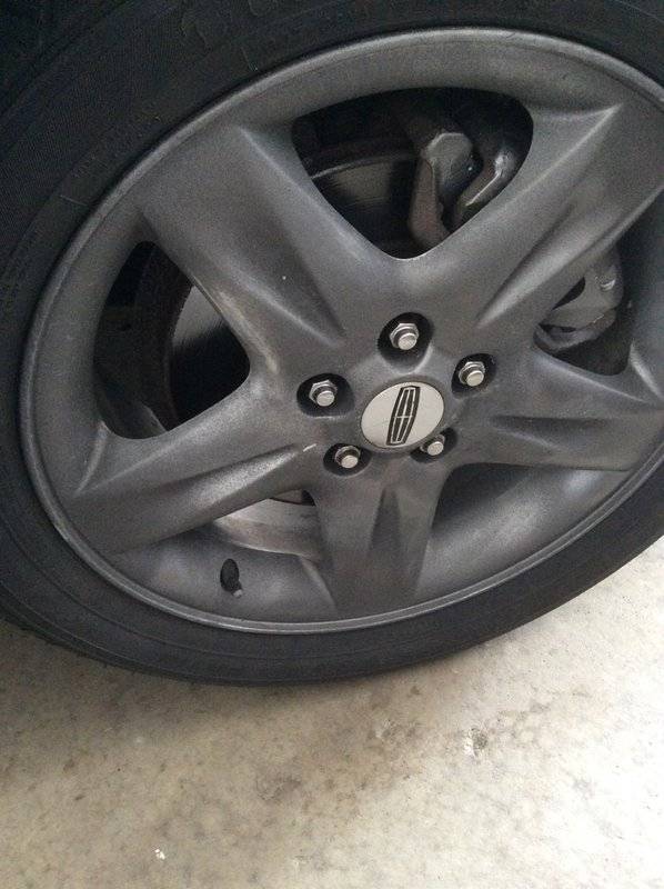

Funny! I was seriously wondering though it seems like there is a seal coating on mine so the paint isn't sticking My only option now is aircraft paint remover
Zoals bij alles, zou het plakken voor verf het schoonmaken en .... scuffing down the surface. Primer, possible even etch primmer, followed by flashing of the first coat. Clear to seal it in. Pretty standard stuff really. (Ik doe nu eigenlijk ... some grille painting work, right now myself)
NL
NL
Sounds good I'll give it a try. I replaced the bumper and use paint sold at Mill's Fleetfarm for plastic called Rust- Oleum Paint for Plastic it was easy Pizzie lemon squeezie but these rims are a pain. I might have bought some low quality paint I used Duplicate-color wheel coating I'll try looking for a better paint this time around but thanks for steering me in the direction to get these done right.As you can see they look like garbage right now.
Yeah it's all in the prep work and using quality paint, I suppose.
