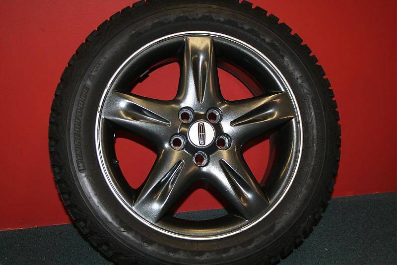

What do you think? Only one coat of color right now. It needs 1 or 2 more, then I'm going to clearcoat them too. Wondering whether to leave the cap silver, or to paint that as well.
I like the small lip around the wheel left silver, to give it some separation from the tire.
These are going on the car shortly, then after we get snow, it's getting parked. You can see they have snow tires already, so I can still drive it on the random nice winter day.
Thoughts/comments/criticism welcome.

First, the color is charcoal black. I didn't want a true black, just one shade lighter.
Second, my whole reason for doing this: I wrecked the original finish on the wheels. I accidentally grabbed a chrome wheel cleaner, and didn't realize until I had sprayed all the wheels down. It etched the finish. So, here I am with my fix.

Thanks guys. It's a close copy to fonsito's stock wheels. At least, from what I can remember of them. Except IIRC his were black. I don't know about his center cap, and I'm pretty sure he said he has a "polished" lip on them.

I think you need to do something with that center cap. It doesn't look right in my opinion.
i would think the only way to get a true polished lip is to strip the finish from the entire wheel and start from scratch.
after seeing fonsito's photograph, i have to agree. it will be painted too.

I imagine in order to get that polished lip it would need to be taped off and wet sanded down then polished with a good metal polish and I would also clear coat it with a high heat clear coat.

Oh and make sure you wet sand and polish it before the clear coat pretty good. You will have a 100% better turn out and way smoother look and feel to the touch!
I used 1000 then 2000 and some Ultimate compound before I put on the clear. Then after the clear I did the same thing.
