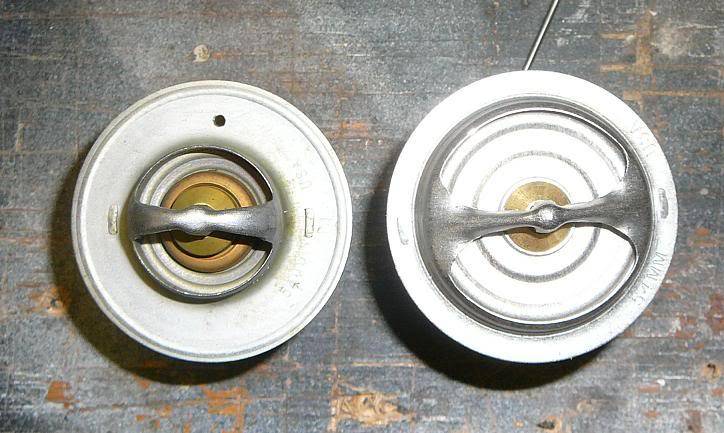

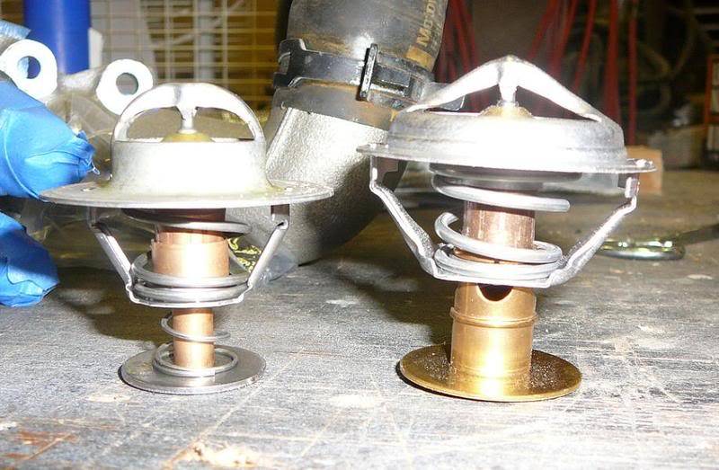

Exactly what thermostat did you install? Did it look like the one on the left or the one on the right?
